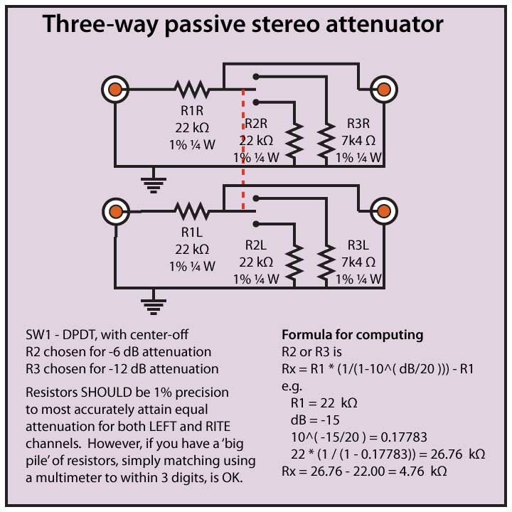

Thanks for the replies all and the ideas so far. Some other knowledgeable gentleman gave me some advice the other day as well which was to just use some resistors, and it may even be possible to find the right resistor value by ear and get some sort of near level match, which I thought was a very good idea and simple walk around. And that way I wouldn't have to deal with a volume control either. May be quite straight forward to put in the circuit as well, or on the input rather. I see there are already resistors on the input though are these for this purpose and could I just change those perhaps? I might be barking up the wrong tree with that bit yet though I haven't really looked into doing it in any detail on my unit yet though.
Another simple method would be to make some RCA attenuating plugs to go on the input. There is even a tutorial/instructions how to make these DIY online, but I suppose once I find the right value, it'll be easy enough to just wire them direct inside the casing.
The other thing would be to perhaps buy proper attenuating plugs, but these are not exactly cheap. But apparently these are more than just resistors they are proper audiophile components if you believe the information or perhaps hype thats given on them. Or they may actually be telling the truth I dont really know
the only trouble is in the audio world its hard to tell, and its full of suckers
Anyway here's the DIY resistor plugs model I could follow
https://www.instructables.com/id/Homemade-RCA-Attenuator/
Here's the fancy attenuators
Attenuators
And heres the resistors I have on the input of my RCAs as it stands. But I'm unsure of their purpose yet or even if they can be changed or if the attenuation bit is something in addition to this. They are attached to the positive on each and then common up on the ground.

Those fancy attenuator plugs do smell of "snake oil".
Applying the resistor color code to the parts in the photo, I get 57 Kohms/2% tolerance. That's definitely tolerable.
Now, let's get you the values of the 1/8 W./1% tolerance metal film (for low noise) resistors to mount inside the RCA plugs. You are constructing resistive voltage dividers. The formula to use is: dB. = 20 log(α), where α is the "gain". For 6 dB. of attenuation, α = 0.5 and 2X 5.1 Kohm resistors are used. A 10 Kohm part and a 1 Kohm part will yield 21 dB. of attenuation.
