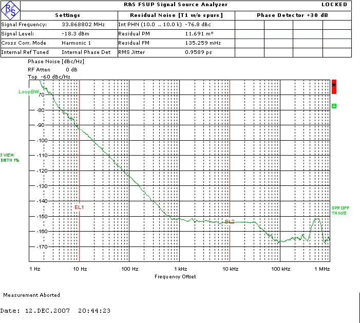

Without test equipment you can't determine how good the XO module is that is supplied with the kit, but it can be replaced with an excellent Tent XO module at a later date. I have tried to get phase noise graphs from these Chinese suppliers but they have no interest in supplying useful info.
I can tell you that a good clock improves many aspects of the sonics, if your system has the resolution to reproduce it.

It is -125dBc at 1 kHz. My clocks are-150dBC there....
http://www.tentlabs.com/Components/XO/assets/TentLabs_XO_33.8688.jpg
best
Guido
