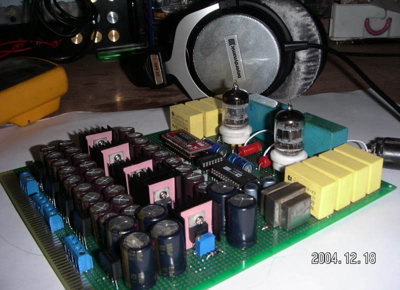

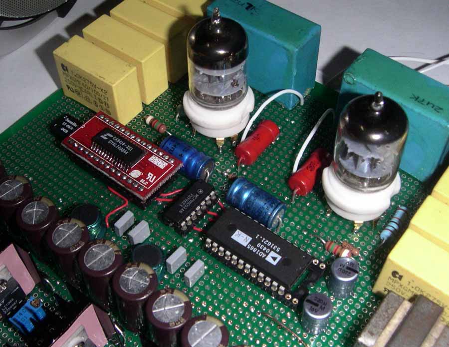

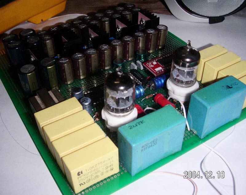

Electric circuit is this,
http://www.ptsoundlab.com/secnumerique/dac/mondac1865/zeroad1865n.htm
But this electric circuit contain mistake, just pass by to correct, the work is good

I just had a look. The Analog stage shown IMHO is not particulary suited to the AD1865 and worse, it actually requires a modification to work well for non-oversampling DAC's.
I originally concieved this circuit for modifications on the Philips CD720/21/22/23 and related (Philips CD71X and Marantz CD3000/4000 & CD36/46 et al) which are equipped with a TDA1545 DAC chip which requires it's output to be held at around 3V DC offset.
The AD1865 is unlikely to be too fond of 3V DC offset on the output.
The rest appears to be basically the Audio Note DAC Kit, re-drawn.

The power supply is different.

Re: NEXT/ Error
Actually the output of the opamp must be able to reach -6.2V as the transistors are Darlingtons.
Also the 22µF cap at pin 2 of the lower opamp should be omitted.
Yes there is a mistake (drawing error) in the -5V supply The opamp should have pin 4 at some negative voltage in order to drive the pass-transistor.xiaolong said:Electric circuit is this,

The power supply supply is different .
The power supply is supplied and is used LT1086=+5V/-5V/VD5V
TUBE's high pressure is used LT1085 with TL783,'s filament
