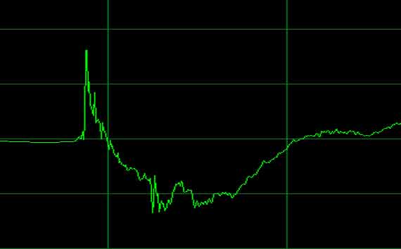

So, the best is to forget this and get familiar with a good (free...) soft, as Arta, that displays clearly impulse and step. Learning this tool is a long curve but you gonna get paid back.

Were I to do it (never did before), I would do a bit of basic trig and get the hypotenuses of the listening triangles between listening position and each driver, pick a reference, and then subtract horizontal distances from the hypotenuses to yield traveling distance difference and then just divide by c.
Tweak after that, but that should get you pretty close.
