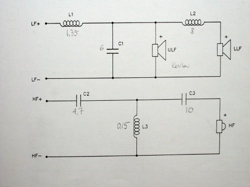

There is a slight problem with my speakers as previously mentioned in one of the replies. Currently they operate in a 2.5 way configuration - the high frequencies to the aluminium tweeter, mid and bass to the kevlar cone and bass only to the aluminium cone (mushroom).
If I was to "modify" the crossovers would it be best to set the Linkwitz-Riley to around 300Hz (as suggested in ESP) and use the high/mid pass section of the crossover to seperate the high/mid signal to the tweeter and kevlar cone?

From what I understand of the 603s, it sounds like the crossover point between the low pass for the mushroom driver, and the high pass for the mid driver is not the same, i.e. mushroom is driven below, say, 500Hz, but the low mid is not rolled of till 300Hz, (purely hypothetical figures...).
I don't know why, but B&W make damn fine speakers, so I'm sure it makes sense somehow.

One possibility
One possibility is that the bass is tuned with a bump in the response near its lo cut-off and the mid is subject to the baffle step boost up in the ~500Hz area. Then, if both the mid and the bass drivers are operating together between the bass bump and the baffle step, the theoretical result is a flat response.

after some research...
...I discovered the frequency allocation:
4 kHz < Tweeter < 22kHz
44Hz < Mid/Bass < 4kHz
44Hz < Bass < 150 Hz
The large overlap (between 44Hz and 150Hz) that is covered by both mid/bass and bass drivers is the reason for them being 2.5 way.

With the complex XO in the B&W you might well be best off with a passive bi-amp. This, although not usually as beneficial as using an active XO is simple & will allow you all the benefits of any FR tailoring done in the built-in XO.
For this you need 2 identical stereo amps (or 4 monoblocs). Disconnect the biwire jumpers and connect a separate amp channel to each set of binding posts.
Doing an active XO would require pulling the passive XO, tracing its circuit, figuring out what it does, and then duplicating this with a custom active XO -- this is where John Pomann's Active XO Xperimenters Kit is very useful. You play with the active XO till you get it right, then you freeze it.

I don't know about your particular speakers, but the B&W 803 used the similar principle for woofer and midbase drivers. The crossover was rather simple. If you wan't to bi amp you could do it at 4k removing passive filtering for tweeter and ULF driver (but I might be wrong on that), leaving the series coil for LLF driver in place. This should work fine providing you use the same slopes in active crossover. I would start with obtaining crossover schematic from B&W first or figuring it out yourself.
HPotter said:If you wan't to bi amp you could do it at 4k removing passive filtering for tweeter and ULF driver (but I might be wrong on that), leaving the series coil for LLF driver in place.
You would get better use of 2 amplifiers by driving ULF & HF with one amp thru the passive XO and LLF with the other amp with a simple 1st order PPLOXO. This could be built right into the bass amp.
Best of course would be to tri-amp them. Tweeter protection would come in the form of a big cap that has its XO well below the active XO.
