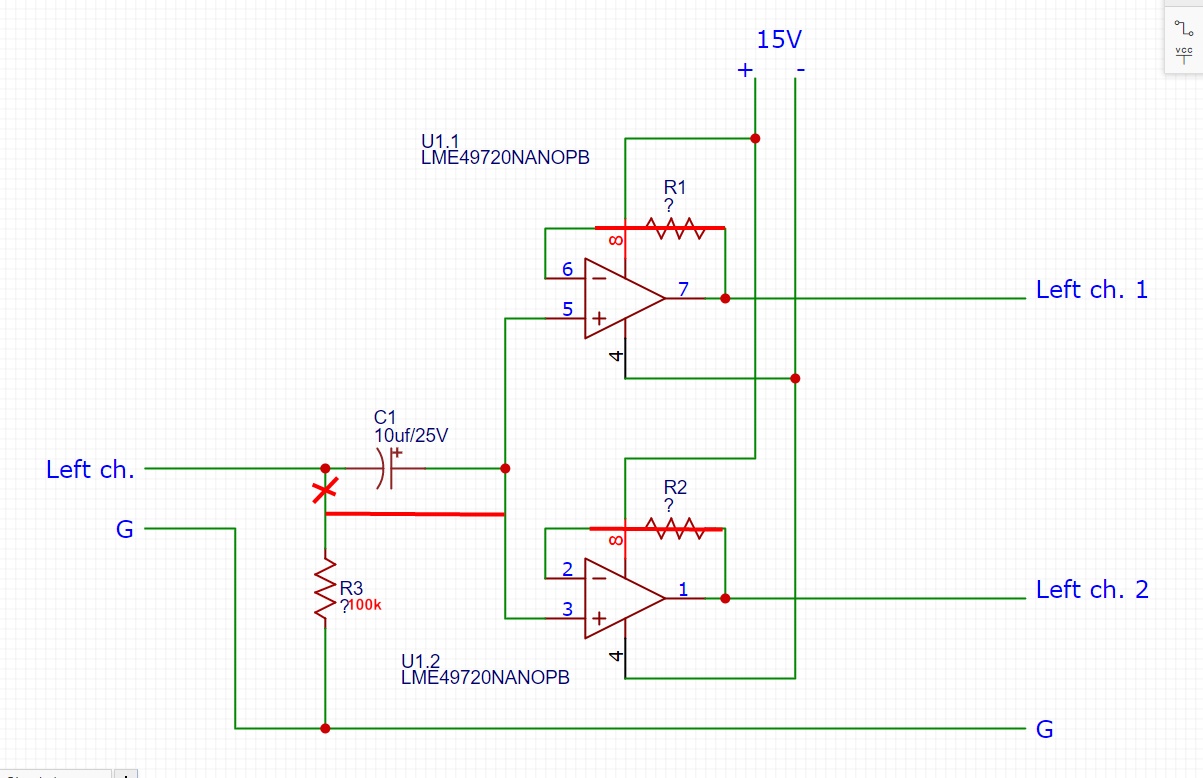

Hello to all,
I am working on audio divider using LME49720 Dual op amp. I am not experienced with making design dedicated to some op amp, but I guess there should be some resistor and at least one cap.
Any idea what resistors should be used? Or what should be added?
Thanks for help!
Milan
PS: I did some googling but some dividers has feedback resistor, some not... I am confused 😕
I've done this... and the same will be for R ch. as I want dedicate 1 dual op amp to one channel because of separation.
Datasheet: http://www.ti.com/lit/ds/symlink/lme49720.pdf

If you are simply wanting 2 identical outputs, you've just about got it covered except for biasing the + inputs, there you will need a resistor to ground, typically 100k works fine.
If you want unity gain you can eliminate R1 and R2 and simply connect the - inputs to the output pin.
If you are after some gain you will need to add a resistor from each - input to ground. The gain would then be the ratio of the values of the resistors.
R3 should be set to match the impedance of the previous stage, although in practice it's not actually needed if the unit is permanently connected.

Thank you, I hope I got it right...
No amplification, just two identical left channel outputs, most possible channel separation, this is why 1 LME will be for left channel and second one for right channel.
Here is edited version:
R2 is not required.
So yes, the device will be connect permanently, but it might be working without input/load for short time...
the 1 pair LR will go to 1 amp, second pair will go to second amp.
So like this? Looks really simple

If it is just feeding one pre-amp to two power amps, it's probably already too complex.
You don't actually need any electronics at all ... just a simple Y adaptor cord will do the job just fine.
In fact the cord might be better than your solution because a chunk of wire can't introduce hum, phase shift, crosstalk, distortion or propogation delays.
If you still want to go the active route... See the thumbnail (revisions in red)

Thank you Douglas, so basically your attachment is like my last updated image:
I would like to have two pairs outputs because I would like to connected one to main amp which has build in preamp and second output to external sound card, or tapedeck, etc. (it dependent what I will be doing, what combinations). And yes, I want channel separation, minimum distortion and so on, the LME49720 has nice specs.

With 100k as load you only need 1uF capacitors for C1 and C2. They should have their connector-sides leaked to ground using 1M resistors so they don't hold charge till the next jack is plugged in.
Like this? Is there something else to improve this superior high fidelity splitter? 😉
Second that, 100nF ceramic between V+ and V- will provide HF decoupling for fast opamps that prevents instabilities - the need for this varies a lot between different opamp types, and the circuit may be fine without it, but it will never hurt to provide this.
