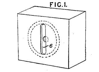

I believe the JBL-EON715 uses a version of slot loading to spread or diffuse the upper frequencies from the mid/bass driver.
The Kolster Brandes patent for slot loading dates back to 1947.

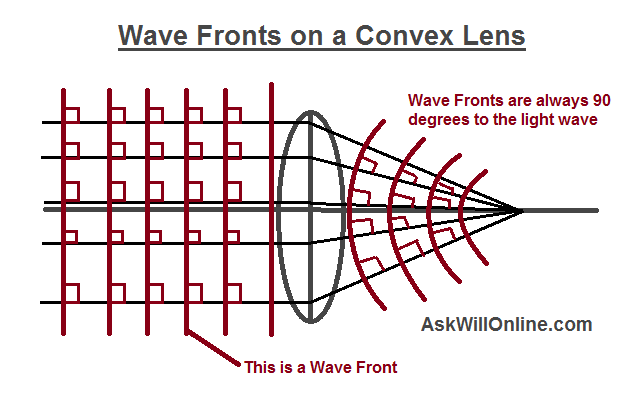

It sounds like arivel is suggesting converting sound from a point source into a planar wavefront.
Here is the optical analogy of how that would be done:
This can be done for high frequency sound waves by use of a path length refractor:
