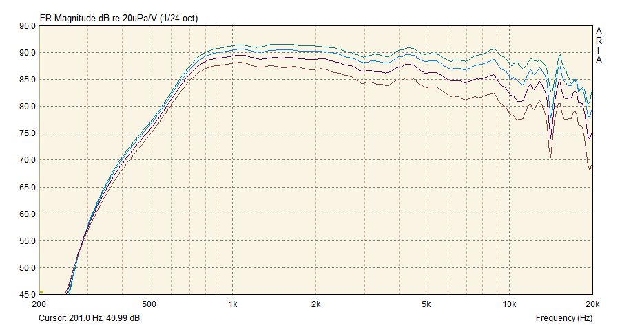

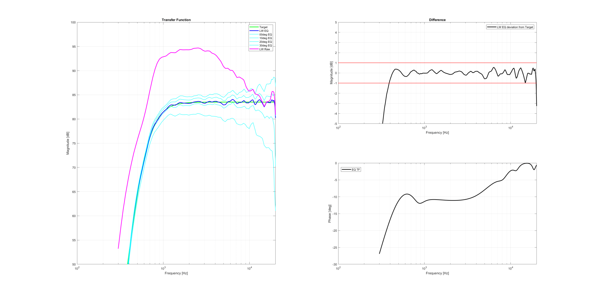

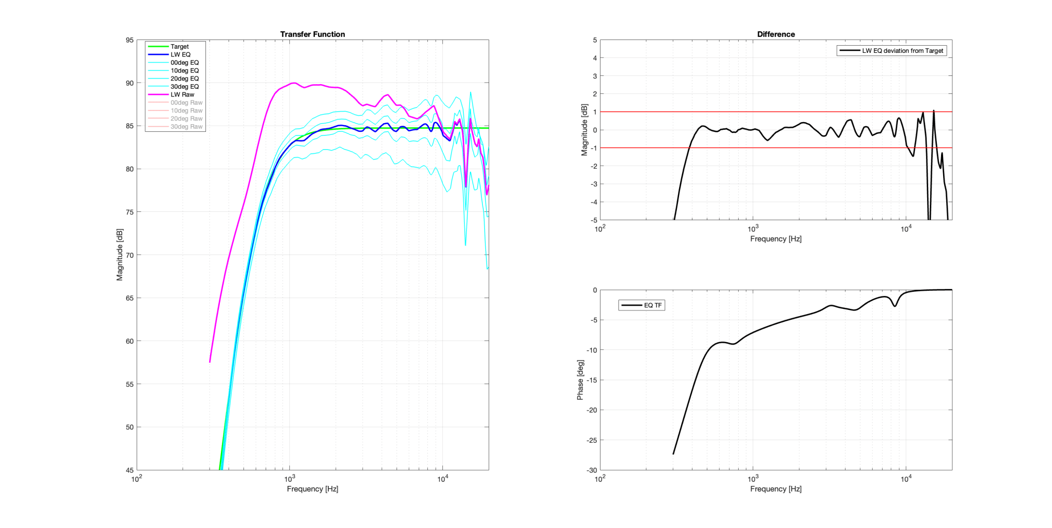

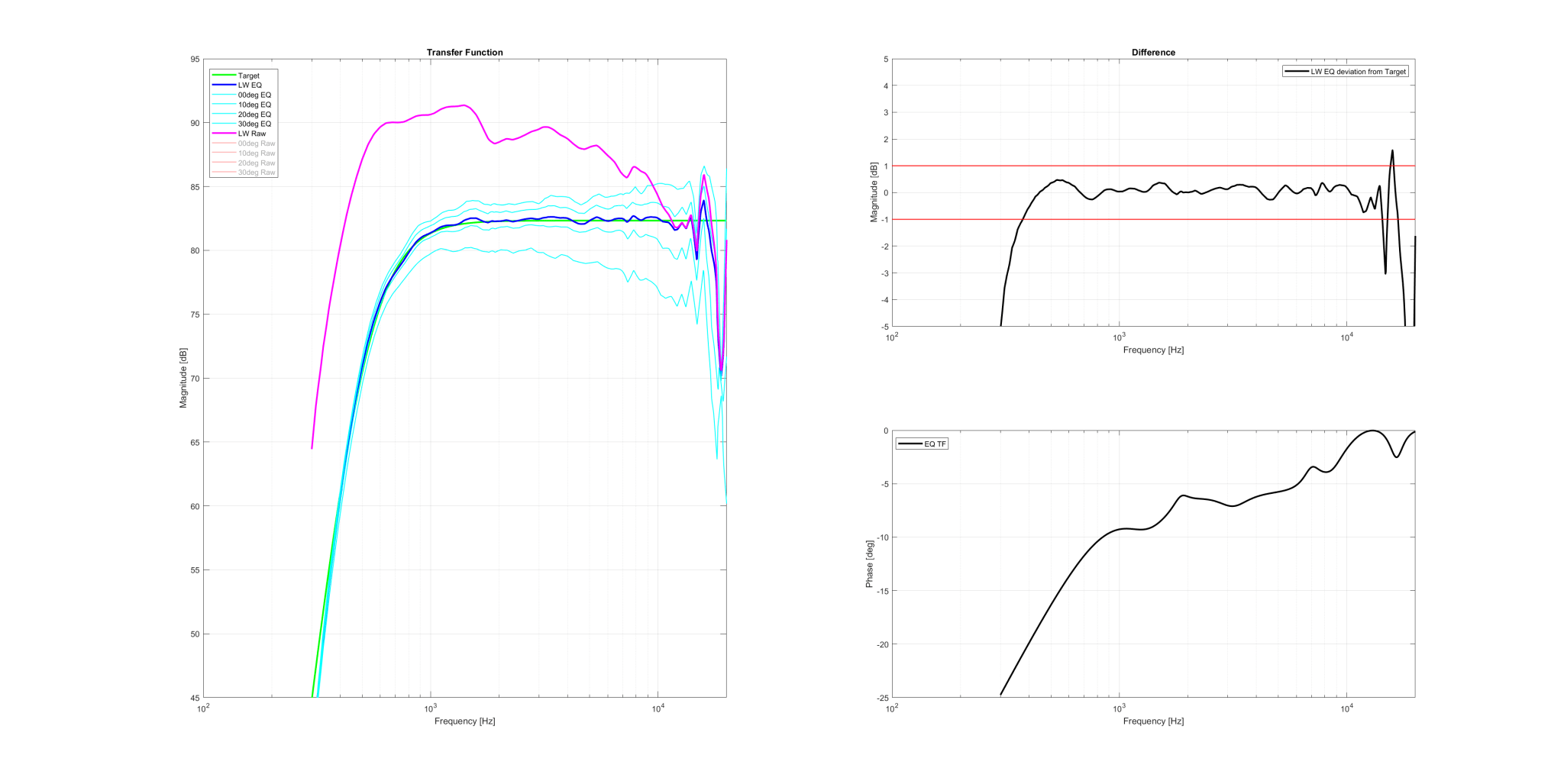

And a quick ~0/10/20/30 deg set:
Shouldn't require a lot of EQ

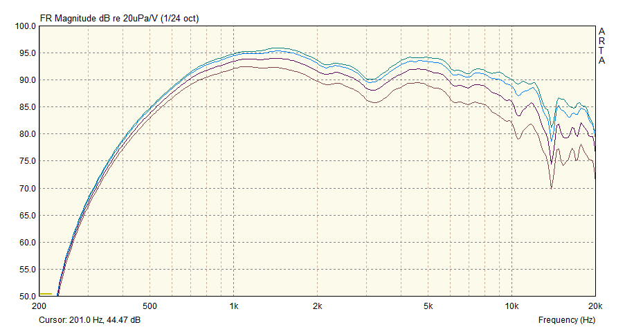

DFM-2535 T520-25-STD
6BQ / 600Hz
BMS 4554-16 A520G2/36-STD-1
8 BQ / 600Hz
Will work much harder at LF
DFM-2544 A520G2-25-STD-1
7 BQ / 500Hz
Compromise HF vs Sensitivity to be found
Maybe better than DFM2535?
T520-ROSSO-STD
8BQ / 500Hz
Not too bad, with a DSP...

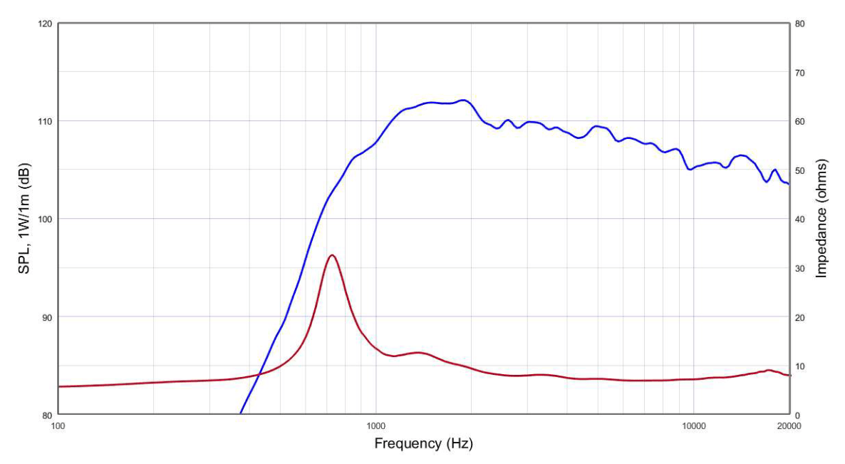

What makes the DFM-2535 peerless is its fc = 780 Hz in a 1-inch device.
Maybe it's time for DE250 again. I also looked at RCF NDX495 / NDX595, Lavoce DF10.171M / DF10.171K, and of course some of the Faitals, that would need to be tested. But I don't expect any of these to be as smooth as the DFM-2535. Maybe also 18Sound ND1018BT.

1" RCF NDX595 / datasheet:

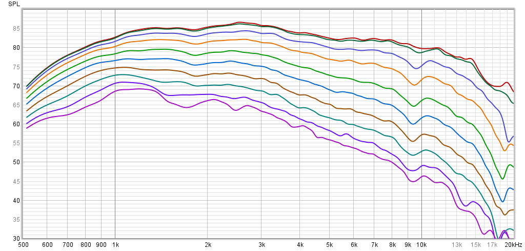

Agreed, they should work well with your wave shaping plug. Below is a dual driver (DH450) on a 10 degree vertical Paraline lens and conical style horn with 10% smoothing.Sure, I'm looking forward to trying the DH450. DH350 didn't fully convince me yet but it will be interesting to try a wave shaper with two channels corresponding to their existing ones. Apparently, they did go to some lengths to make the two paths equal (not only path lengths but velocities as well). If that's true, my wave shaping plug should finally work as intended. That would be awesome.

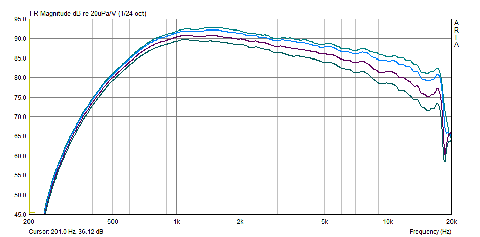

A520G2/25-STD-1 + SICA CD95.44/N240.
These waveguides simply expose the drivers as they are, stark naked.
