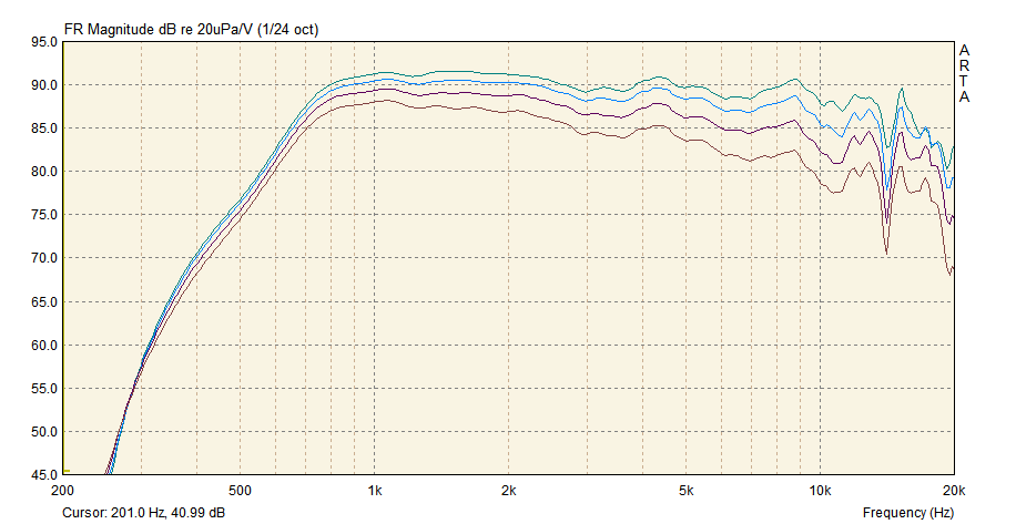

Here's the hero -

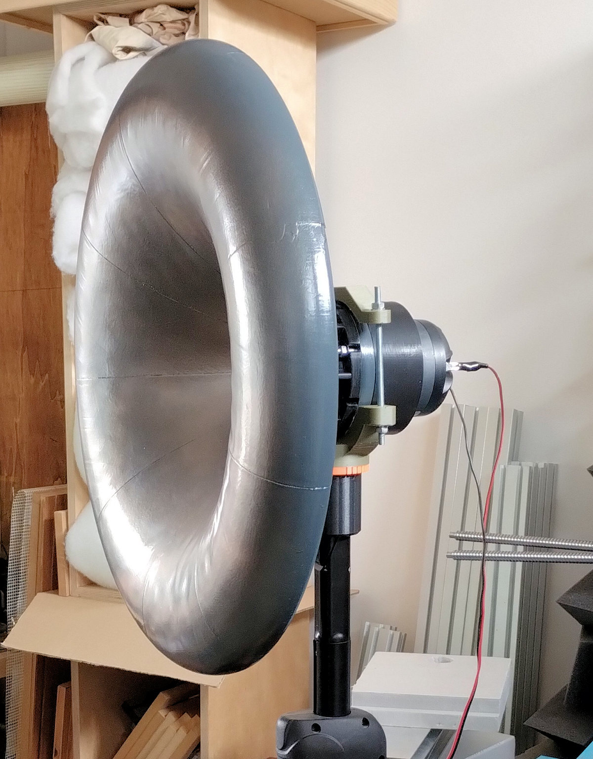

It's a one-perimeter print with almost no infill and I accidentally left it on the sun - then it crumples immediately like this, so I resigned any proper finishing and only sprayed it a bit, mainly to close the surface.

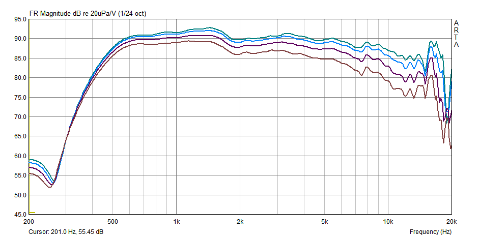

Wow, FR curves on peerless betters the rosso.
Do share your comparison of the two with G2 waveguide.

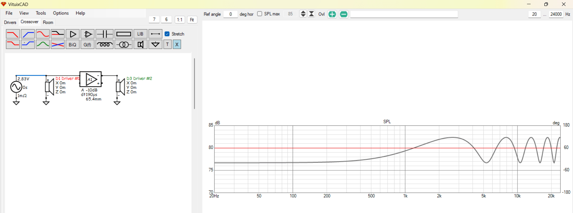

What aspect creates the dips at 5,5, 11 and 16k?
Mouth reflection, or diffraction, I still don't know how to call it the most appropriate way (it's always a mix of both, I guess).
The termination can't be much more abrupt than that.

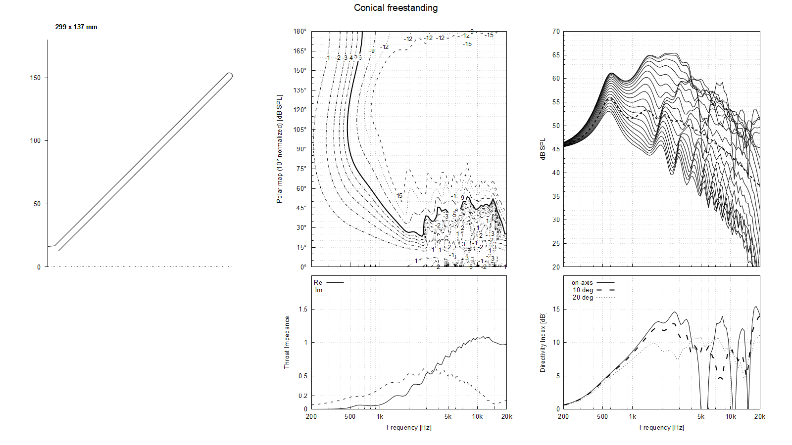

Agreed. I'd like to elaborate because we can look at the two phenomena separately. I'm confident that my take on diffraction is correct, but there are holes in my knowledge when it comes to reflections back into the horn.
All diffraction and reflection-related issues manifest themselves mostly on-axis, particularly with an axisymmetric design. This is because all disturbances around the main axis of the horn reach the ear/microphone at the same time. For this reason, I'll focus on the main axis.

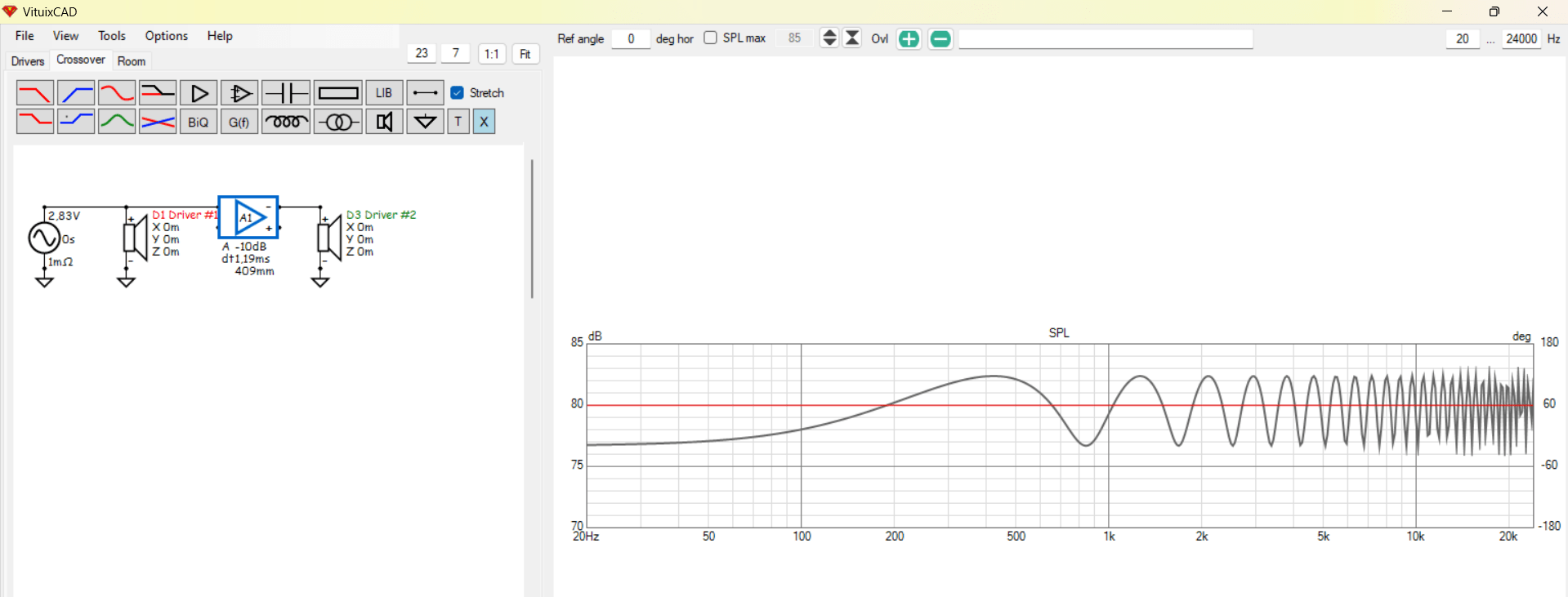

The dips at 5.5 kHz and its multiples (11 kHz and 16.5 kHz) are indicative of a comb filter effect. This effect is caused by destructive interference between the direct sound and the delayed, opposite polarity diffracted sound resulting from the sudden termination of the horn. Sound radiates from the throat of the horn straight to the microphone, having the shortest propagation delay. However, some sound first travels to the horn edge and then to the microphone. At the edge of the horn, the acoustic impedance suddenly drops, leading to a drop in sound pressure and a corresponding phase flip of the diffracted sound.
Pythagoras tells us that the diffracted sound travels a path that is approximately 65 mm longer than the direct sound. I simulated the effect of a delayed inverted copy of the direct sound in VCAD, with an arbitrary level for the diffracted sound of -10 dB:
Besides edge diffraction, a secondary effect of the sudden drop in acoustic impedance is that sound will reflect back into the waveguide, towards the throat. When a sound wave encounters a sudden increase in acoustic impedance (such as a wall), you get a positive phase reflection. Conversely, when sound encounters a sudden decrease in acoustic impedance, you get a negative phase reflection.
This negative phase reflection travels back towards the throat of the horn, where it reflects back towards the mouth. The reflected sound then travels to the microphone. The relative delay is much greater than that of the diffracted sound (the propagation delay is approximately twice the time it takes for sound to travel from the throat to the edge), and thus the resulting comb filter will start at a much lower frequency. In this particular horn it probably looks something like this:
To be honest, I haven't much looked into this phenomenon. I tend to focus on minimizing issues caused by diffraction, and when you've done that, reflection also isn't an issue.
The ABEC simulation does show peaks and dips at approximately the same frequencies as the VCAD sim. Therefore, you'd think these might indeed be caused by the reflection back into the horn. If that is the case, the effect appears to be less pronounced at higher frequencies. However, the ripples in the acoustic impedance graph resemble the VCAD sim irregularities quite well...
However, it doesn't really make sense to me. That's because at lower frequencies the horn provides less loading than at higher frequencies (check the throat impedance graph in the ATH report). Therefore the change in acoustic impedance is smaller at lower frequencies, and thus there will be more diffraction (waves wrapping around the waveguide) and less reflection.
Therefore, I think those peaks and dips at about 500 Hz, 800 Hz and 1500 Hz are not caused by reflection back into the horn, but by something else. I don't know what. Anybody else?

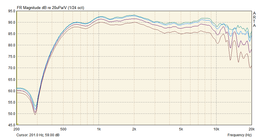

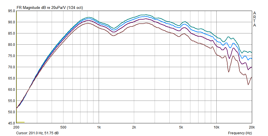

This is the bigger Peerless (DFM-2544), A520G2/25-STD-1.

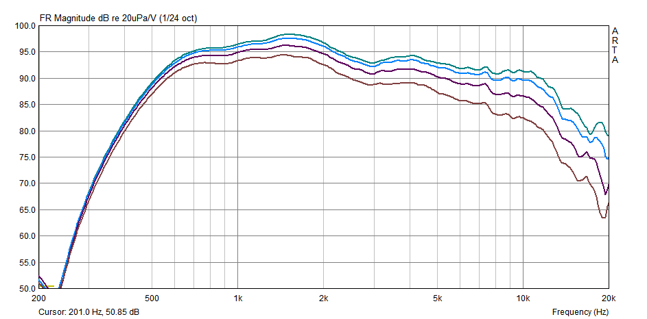

BMS 4554-16, A520G2/36-STD-1
(All the absolute SPLs in these mesurements are NOT directly comparable between the different drivers.)
(This one has a slightly smaller exit than 36mm...)

To compare two different FR is
Would it be hard to compare to just mate the 520 horn on the CD 1,4" native interface i.e. without the exit modifier?
Some amazing results here. However the big question then becomes a subjective one. In my tests the difference in 'tone' between these combinations is very large - we are not talking subtleties here.

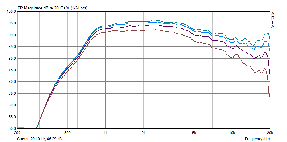

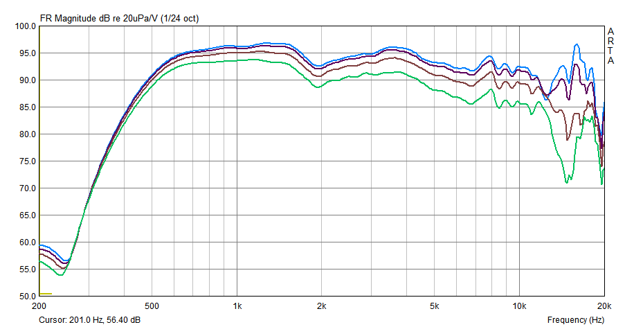

Faital HF1440, A520G2/T520-36-STD-1
It's a strange driver. I only wonder if this is the current production line. I bought them quite early.
But of course with a little active help, it's otherwise remarkably smooth and clean.
