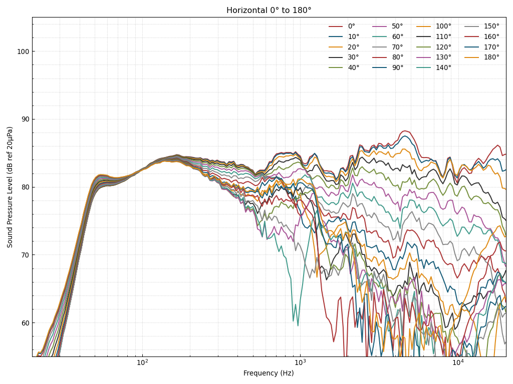

Here's some more data on the LS50 (from audiosciencereview.com, but graphed by me 'cause I think my graphs look nicer ;)). Personally, I think Kef could've done better.

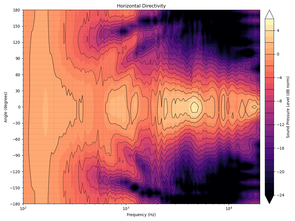

bmc0
2019-08-26 2:09 am

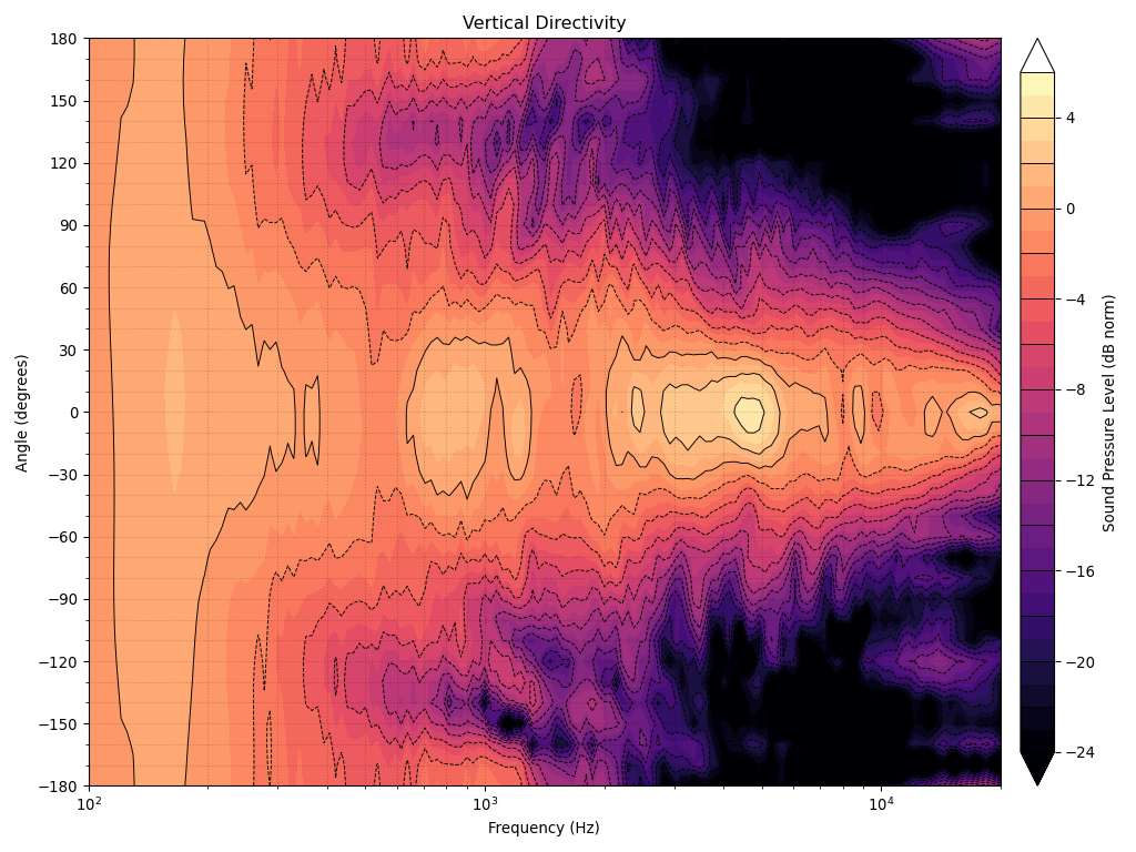

Interesting that the LS50 vertical polars are much better behaved than the horizontal
Eh, I don't know if the vertical is much better behaved. There's less of a diffraction artifact (curved feature 700Hz-2kHz, 60°-140°), probably because of the baffle curvature. I've attached the same data, presented with a perceptually uniform color map.

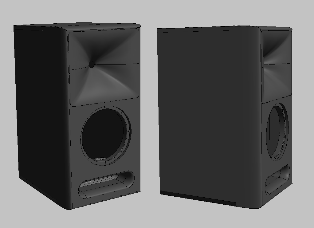

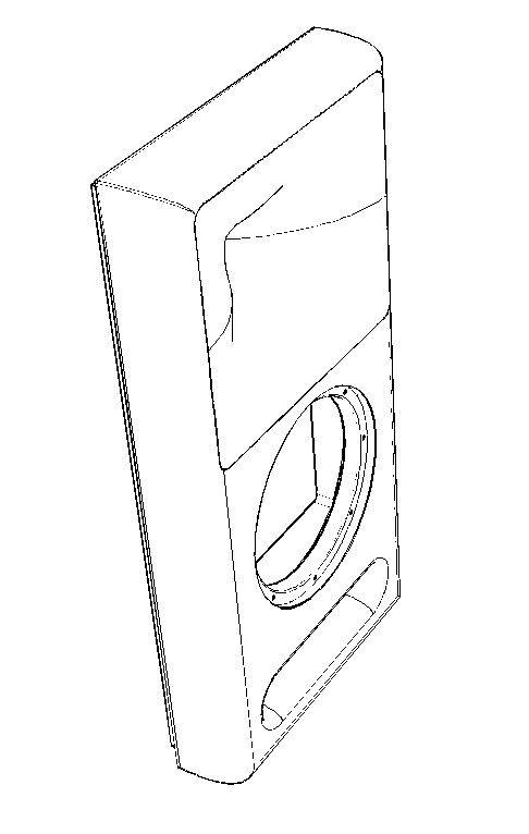

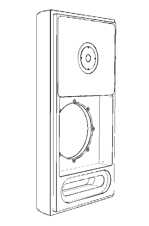

Talking about loudspeakers, these are coming soon :)
It's an all-passive three-way with 1,4" CD, 12" midrange and 15" woofer inside a 4th order band-pass (that's the port under the midrange). Initially there was supposed to be a passive radiator but there's no off-the-shelf suitable - it would be too much effort.
attachment.php

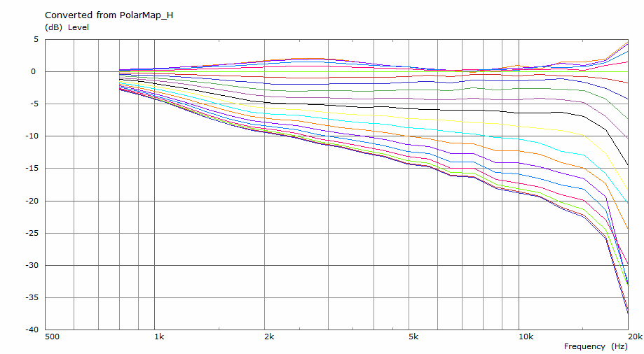

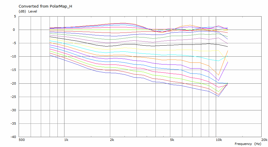

So, I have my first free-standing simulation ever :) I took the 12" demo OSWG.
Infinite baffle:
attachment.php
Free-standing with 5 mm wall thickness (nothing but the waveguide):
attachment.php

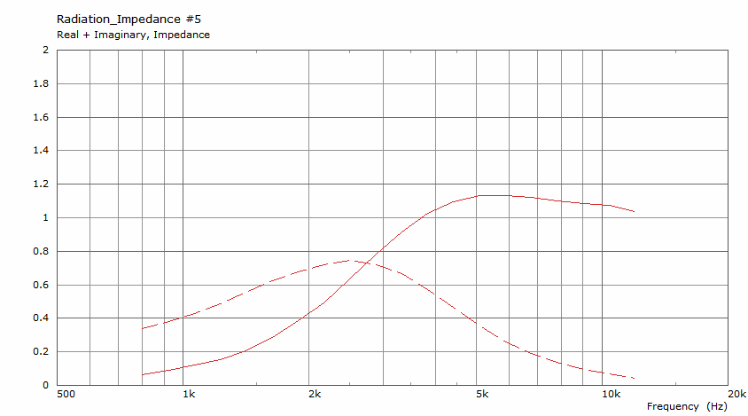

Acoustic impedance of the free-standing one:
(And no, I haven't mixed that up, this is the free-standing waveguide.)
attachment.php
