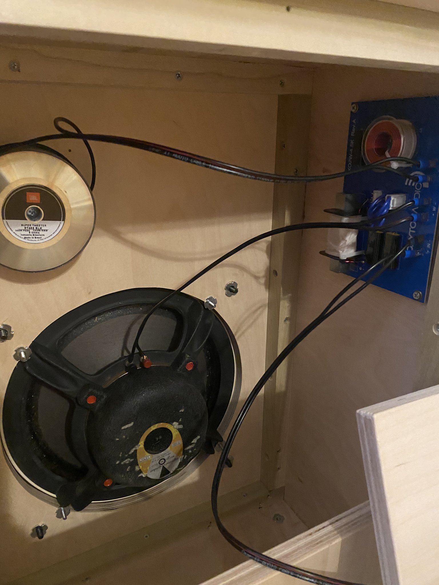

I build my own speaker cabs for electric guitar. I have recently started putting together a rig for amplified acoustic and am using a 1x12 cab I built with an old JBL D123 for my acoustic guitar. The D123 is pretty full range and closer to a hifi PA speaker than a traditional electric guitar speaker, but it definitely lacks the high end sparkle. I’m thinking of possibly adding a tweeter to the cab, and a crossover. Looking for someone who would know if that might work, or if a 12” speaker is not appropriate for acoustic for some reason. Also looking for recommendations for the tweeter and XO, if this seems like an idea worth pursuing.
The classic combination is a D123 plus a JBL ring tweeter plus the datasheet suggested crossover, I´d expect 4500Hz or so but check Factory recommendation.
If original JBL is too expensive, Selenium ring/bullet tweeters are very good and way more affordable.
Plus nowadays they are "JBL" too ;)

Thank you that sound like exactly what I’m looking for. I see a lot of different models of the selenium ring tweeter, and idea which model would be appropriate, also any links for where to get the crossover?
https://www.parts-express.com/Selenium-ST400-Super-Tweeter-Black-264-450
Now the crossover is just a PCB with capacitors, coils and terminals.
https://www.parts-express.com/Dayton-Audio-XO2W-4.5K-2-Way-Crossover-4-500-Hz-260-148
Normal is you mount Tweeter and D123 in the same enclosure, bolt crossover inside and wire terminals where appropriate, and connect crossover input to a jack mounted on a back plate.

Can’t thank you enough. That makes sense and I’m definitely keeping it I. The same enclosure.

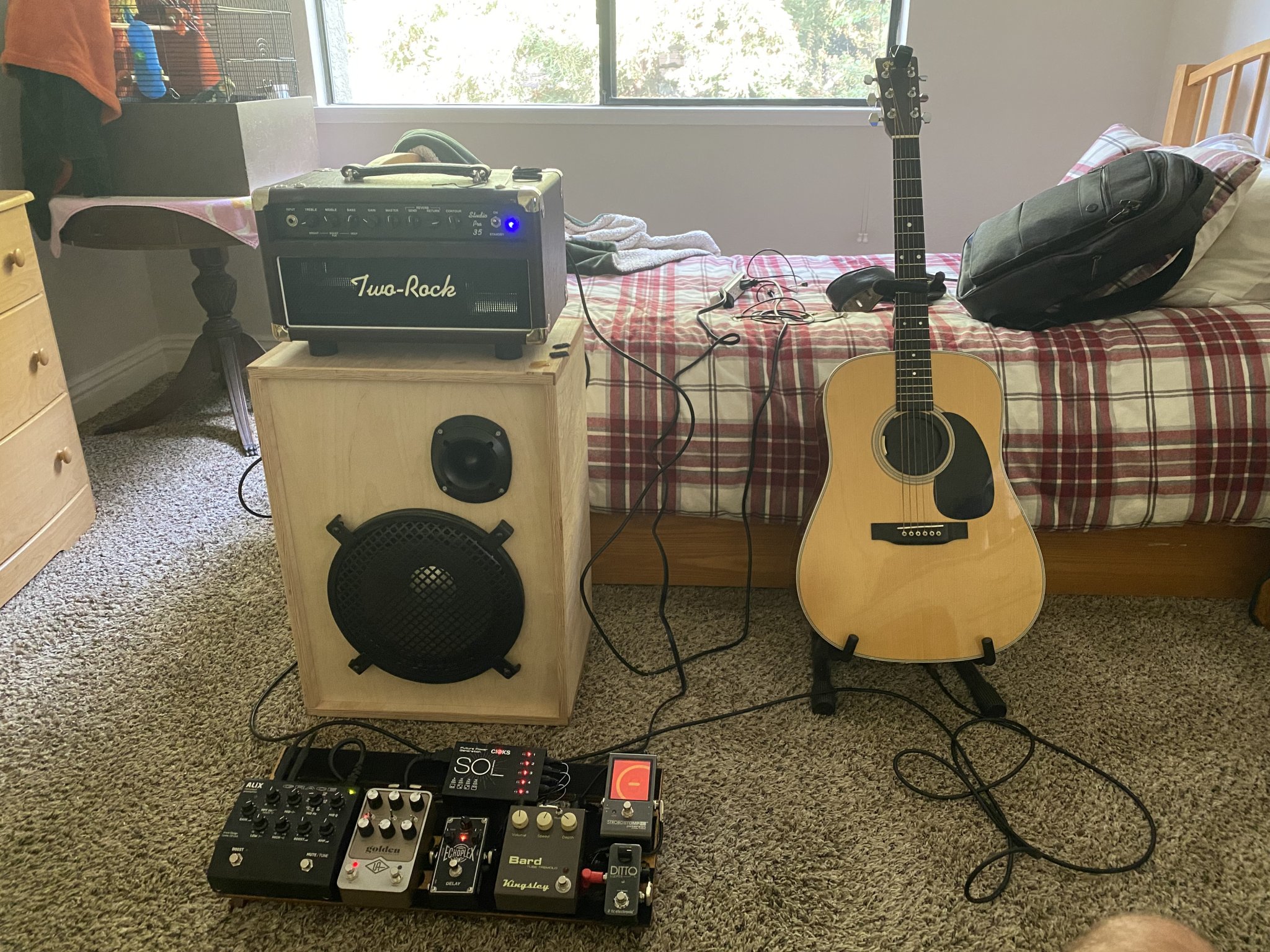

Finally finished the speaker and thought I’d post it here. It sounds amazing for acoustic guitar

Sure. The pedalboard is a pretty simple one I built myself quickly. The heart of the board is the ALiX preamp by Grace Designs. It’s an incredible preamp and so we’ll thought out, but most importantly it’s dead silent. It has an insert loop where I run the other pedals. The Kingsley Bard is a bias modulating Trem which contains a 12AX7 internally. Kingsley pedals are hand made by Simon Jarrett who is an amp builder who now mostly makes tube based pedals. Can’t say enough about his work and this Trem is no exception, just an incredible tone. The other two are a MXR Echoplex delay which I really like because, unlike an actual Echoplex it has a bright first repeat and the rest darken as they go. I found that unlike electric guitar, for acoustic guitar, the pedals which emulate a tape or analog delay interact better with the acoustic, not sure why. The last is a UA Golden reverb which I love the tone of. Probably the best plate reverb emulation I’ve ever heard. The ALiX runs into the FX loop return of a Two Rock SP35 (great little amp). By going to the fx loop return I can bypass the amps preamp (and it’s tonal coloration) which is essentially replaced by the ALiX. The nice thing is that the Two Rock’s fx loop return still gives me access to its onboard spring reverb which is amazing. 95% of the time I just use a touch of the amps spring verb and no pedals, then use the pedals sparingly for effect. Lastly the board power supply is the new Cioks SOL. Can’t say enough about Cioks stuff as I switched over to them on my electric boards a few years back and everything became quieter. Since I run tube pedals and some other high draw pedals the Voodoo labs stuff just can’t keep up. Interestingly enough when I ordered the SOL I temporarily threw a 5 outlet Voodoo labs PS I had laying around (also had different lower draw pedals). When I swapped it out for the Cioks I heard a pretty significant tonal difference, much more so than I expected.
Lastly the guitar is a D28 Custom with an Adirondack top. I love the guitar and when I had it refretted last year I decided to have a pickup installed. Upon the techs recommendation I went with an LR Baggs Anthem SL. I usually research things like this to death but had to make a quick decision. In retrospect I wish I had gone with something like a K&K Pure Mini as I don’t need an onboard preamp on my pickup, since I have the ALiX and I hate having a battery in my guitar that can affect the tone when it starts to die.

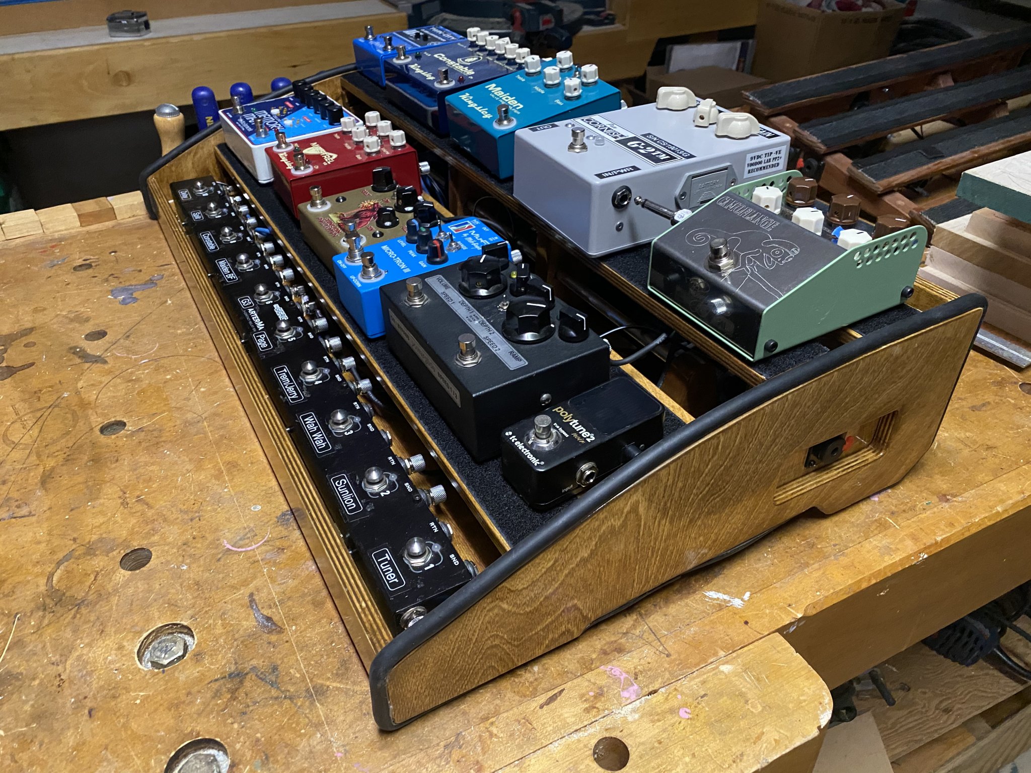

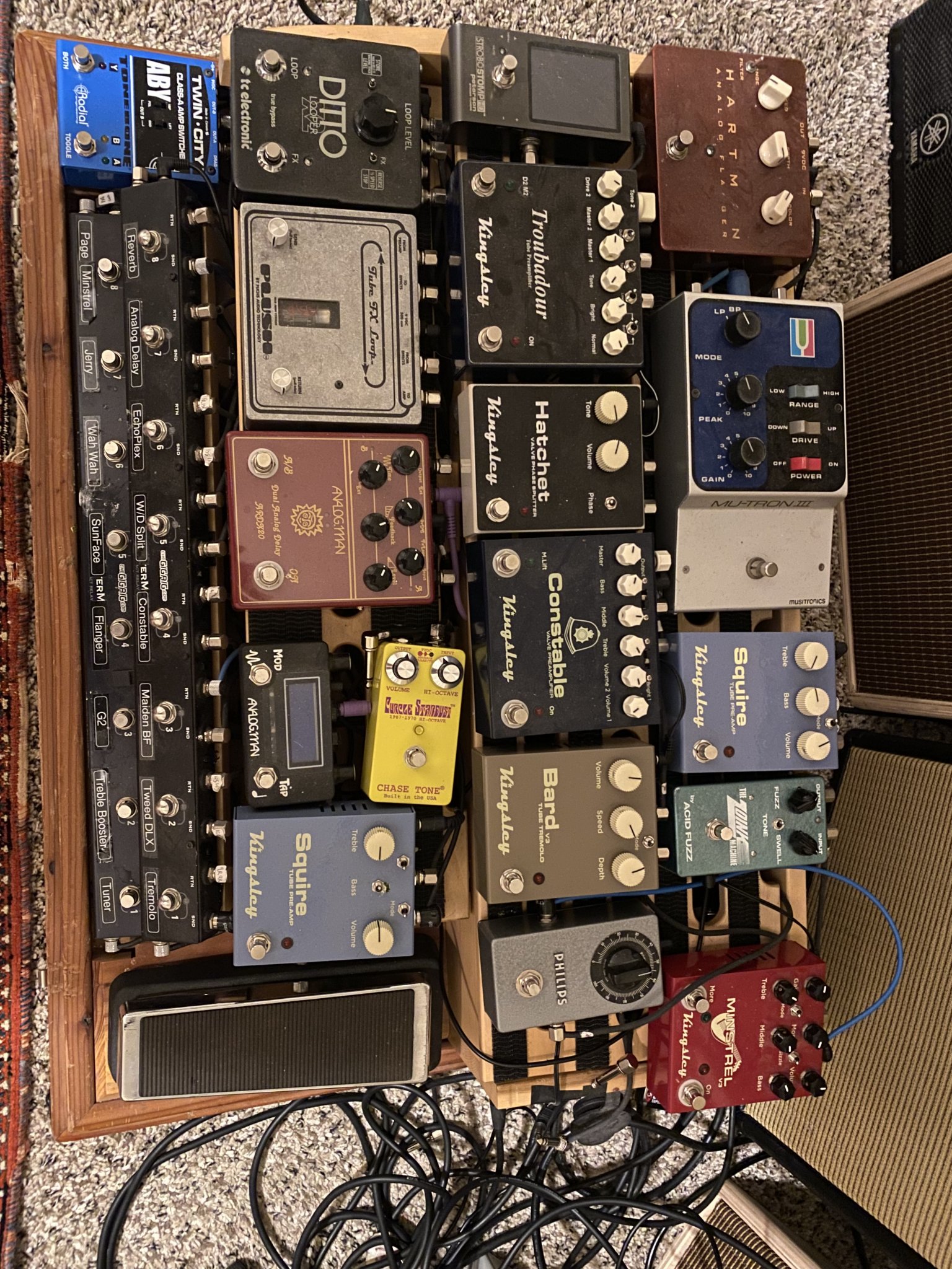

This kind of evolved from my electric rig. I run a wet dry setup into the fx loop return of the same Two Rock and a Mesa 100 watt Lonestar classic. Kingsley makes hardwired tube preamps of many of the classic amps. On my pedalboard at home I have Kingsley preamps for a Blackface, a Plexi, a tweed and a Vox EF86. I can switch between them with a toe tap on my pedalboard. At volume it’s amazing. These run into a Kingsley tube phase inverter and a Fuchs fx loop pedal so that the time based fx don’t clip. The hatchet is the Kingsley phase inverter and with the Constable (Plexi preamp circuit) running into it, emulated the Plexi amp PI overdrive tone at much lower volumes than a non master volume Plexi which gets insanely loud when turned up to a volume to really sing. My gigging board is MUCH smaller and just has the Blackface and JTM45 preamps plus a few fx.

Haha. I’m assuming your talking about the big board, or the mothership as I call it. It doesn’t leave the house and is insanely fun to play. Notice that every pedal is engaged by the switcher so ONLY the pedals engaged are in the chain
