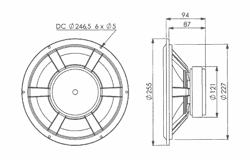

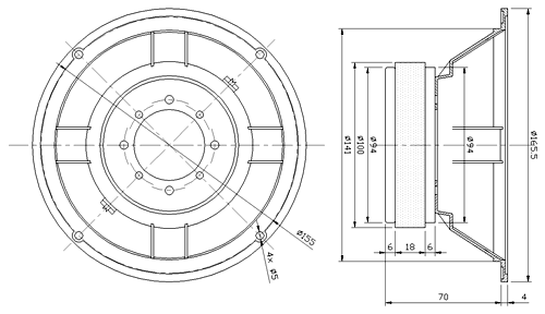

Hello Dave,
I've borrowed the drawings for each driver from their web sites..
The 2x scanspeak 8565-01 per side are in approx 750 high x 280 wide baffle (thats the straight front before it goes into 55mm radius corners..)

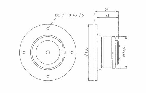

Heres the tweeter one :
Rob

Originally posted by RobWells
That too. Even without signal addition the acoustic centre moves as the radiation frequency changes.
You want to get them coherent at the "join",
Yes.
dave

Tweeter pod
With a 130 mm face=plate/baffle you may find that the tweeter pod has some diffraction issues that you will have to deal with.

The problem comes in only with the tweeter and only because it has such a big baffle (for a tweeter) built-in. No matter what you do with this baby it is not going to be baffle-less. The B&W tweeter has no faceplate to speake of and that is why it works. Your tweeter with the 130 mm faceplate and the dome sitting right in the middle will have a very strong diffraction component caused by the equidistant 57mm travel distance from the dome to the face-plate edge.
Ways to minimize this include using felt-damping on the face-plate, extending the existing "baffle" into a more appropriate shape, or hacking/replacing the face-plate to integrate it better with a small pod.
