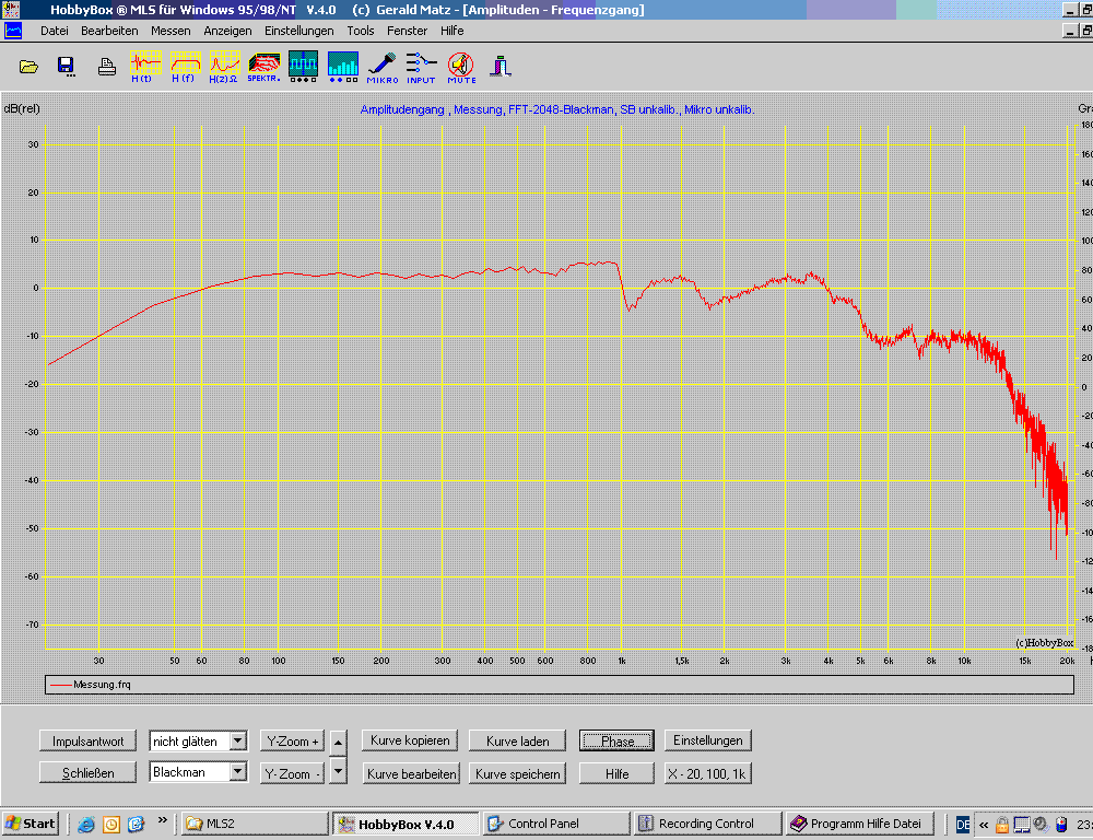

I can't offer a distortion measurement of my AT 8 B 77 25 06 SD driver but a FR measurement in its 20 liter closed box taken nearfield (8 cm).

In my expirience measurements tell a lot about the driver. Linear freq response is important but maybe a bit more important is THD measurement. Low THD and natural harmonic spectrum distribution across the used freq response (h2>h3>h5) are very important but THD measurement is usually done just at one power level. THD&harmonic spectral distribution at various frequencies and various levels tells much more.

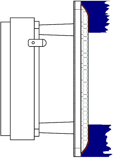

I was intending to use the grille (initially) as the boundaries of the front chamber of the front-loaded horn (as in the picture - wood is blue, putty/rubber/deflex/whatever is brown). If the centre of the grille is still ringing, then I've already created my chamber and it should be too hard to just remove it.
If I ever get around to it (love them round chew-its).

If your front loaded horn contacts as far in from the grille edge as your sketch, my guess would be that it would dampen the grille to quite an extent if a soft glue was used. Caution though, the grille is not attached in such a way as to provide any strength or to carry any load. We found it quite easy to pop the grille off. Its sits in a concentric groove with something like RTV to hold it in, the groove is not very deep.
