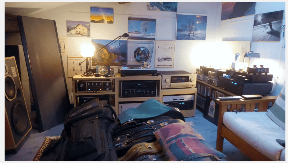

Speaking about Open Baffles, I am very fond of the Magnepan principle, but not as crazy as one of my Audio friends, which owns several pairs of large Magnepan speakers, while I can only afford - by lack of space - a pair of SMGb (below) :

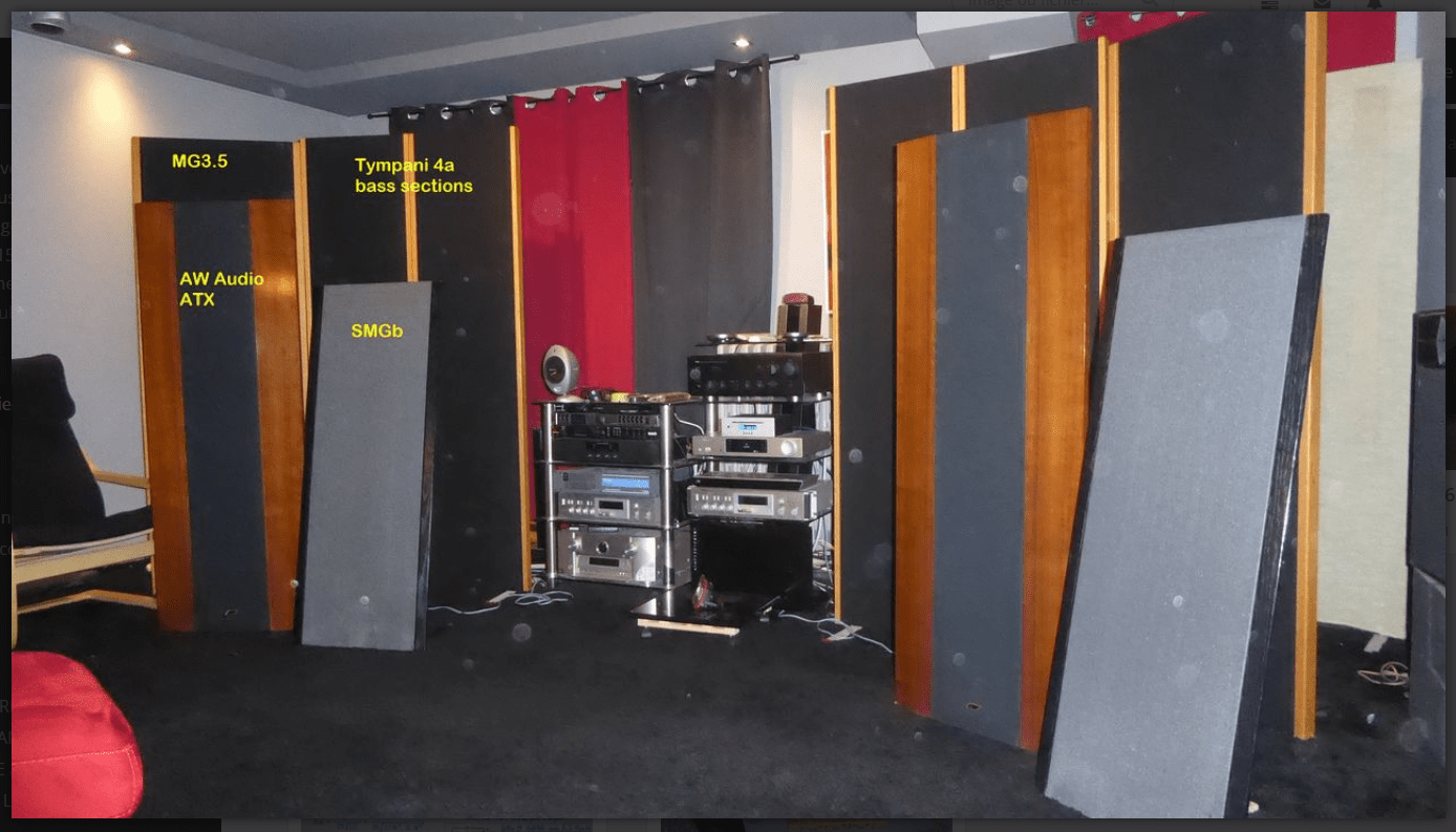

As you can see, my pal has Magnepan Monsters (not all are here !) - surrounding my little SMGb here, in his large room, for listening comparison...
But very interestingly, there was also a pair of Open Baffles built around conventional electrodynamic speakers : the ATX from AW Audio (France), a commercial product from circa 1985. You can see some details below :
The tone of those OB was good and well balanced, something like a vertical acoustic line (Line Array), but it did not compete with the Magnepan speakers in terms of bandwidth, crispness, wideness and spatialization, due inevitably to the huge difference in emissive surface area.
We recognized the cone speaker behavior and listening (with its qualities and drawbacks), as used in conventional enclosures, nothing to do with a Magnepan or electrostatic wide surface speaker listening...

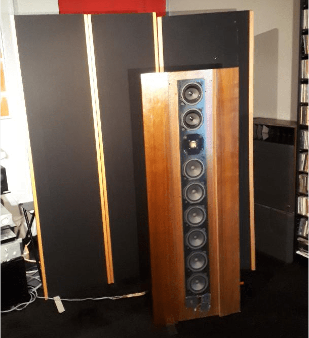

- The central section uses from top to bottom : 2x 5" Audax WFR12 midrange cone-treated, 1x Focal T120FC tweeter, 6x 5" Audax WFR12 woofer cone-treated.
- The lateral wings are made from lacquered solid walnut.
- Dimensions are H=1480 x W=550 x D=70mm.
- Efficiency is 91dB/W/m.
- The crossover is quite complex, in a separate box, using notably RLC traps, a priori used for linearizing the bandwidth in the 100-800Hz region.
- The back of the OB is free, no damping, just a classic framed grillcloth, like on the front, just as found commonly on enclosures.
