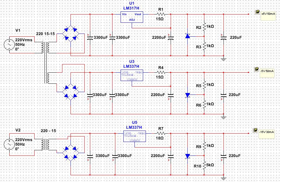

Hello everyone!
I write here because I hope to get some information or advice of any kind on the use of shunt regulators to implement the power of a CD player STUDER A727.
One of the changes I made consists in a dedicated power supply for the TDA1541 based on the LM317 / 337 used as current sources followed by TL431.
The schematics is published below.
The result was immediately positive, although there are still some things that i need to understand better.
The main feature of this type of PSU than with the LM317 / 337 was, (in my case), greater fluidity and transparency of the medium and high frequencies.
Instead, what I don't like so much are the bass frequencies that seems to have lost a little bit of "speed and presence".
Doing various tests I realized that the capacitors placed between the TL431 and the TDA1541 have a very significant influence on the final result, so i think that it is possible that finding the right kind and value of capacity, the question of the bass will be resolved.
Looking on the web, I have seen that there is no fixed rule for the value of the capacity (if not to prevent the auto-oscillation of the TL431).
Many projects have values ​​like 10uF, others 220uF, others 470uF ...
I Place below the images of the schematics that I used and the fotos of the work completed.
There is someone who has already experienced with this kind of power supplies?
ANY COUNCIL, RECOMMENDATION OR SUGGESTION IS VERY WELL ACCEPTED.

You should have a look on the Blog section at the PS of Nazaar member.
Despite the 220 uF help maybe to lower the impedance at highest frequency, it's also certainly a brake to dynamic and transcient...
Did you try to bypass with 0.2 uF smd caps near the load (pin 15,28,27) ? And remove the 220 uF cap ! I will try this first !
You could also add a resistor between the two main first cap for a Pi filtering.
Have a local filtering for the tl431, and use it too feed a discrete darlington (or at least an already made like TIP142/147) for an emitter follower.
But sorry, no precise shematic in mind, just a testimonial from personal experience with this chip !
I have experience with LM317T into TL431 power supplies. They do have a tendency to oscillate (the LM317 does). The solution I have found to work is putting a damped inductor (33uH I used, in parallel with 200ohms) in series with the LM317.
Note you don't need to use LM337 - its even more unstable than LM317 - just turn the LM317 through 180degrees.

I did more and different test.
The TL431 seems not oscillate because the 1.25V across the current setting resistor is stabilized immediately at power on and is stable even when using the machine.
First of all I put a resistance between the first two capacitors.
Then, following your advice I started to decrease the value of the capacity decreasing from 220uF to 100uF to 47uF to 22uF to 10uF.
The amazing thing is that every decrease in the value of the capacity there has been a corresponding improvement ...
(I tried various values ​​and various types of capacitors such as Panasonic FC, Rubycon, Nichicon, Sanyo OS ...)
Basically I got the best sound by removing all the skills ... 😱
I then left alone bypass capacitors coming up to 330nF, trying MKT and MKP.
Compared to the initial situation, in fact there was a very tangible improvement ... but still ... there was something that did not convince me. 🙁
I eventually reconnected the original power and I must say that this is still the best ...

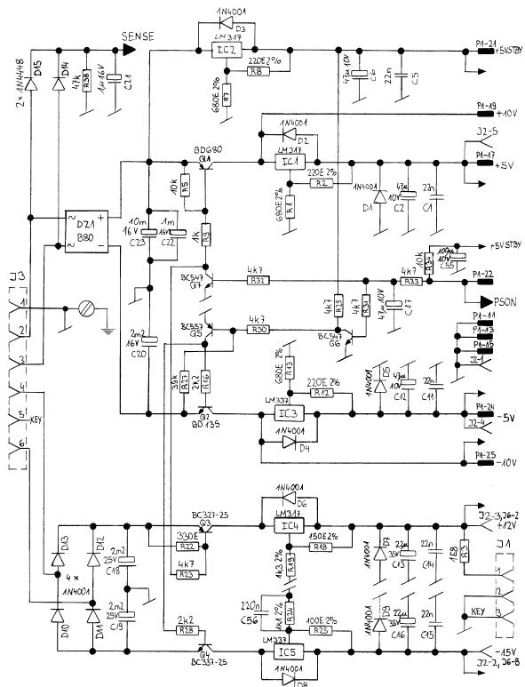

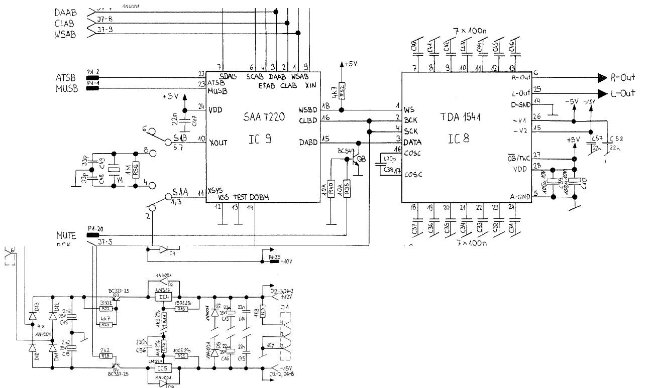

Though generally the schematics are more or less the same for the 1541 also if the machine have different features.

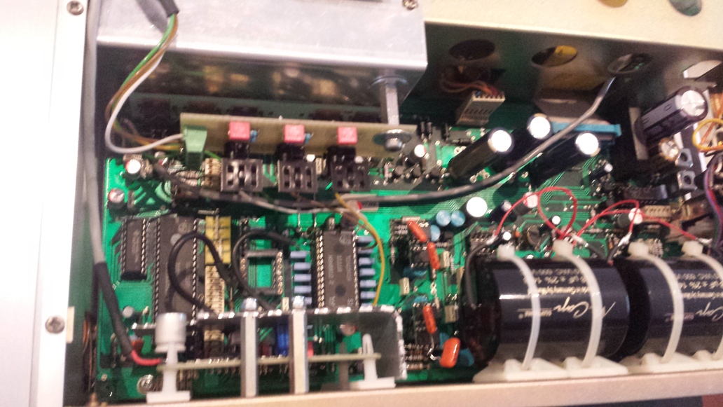

Abot cap on the tda pins IN THE ORIGINAL CONFIGURATION I have two 100uF capacitor paralleled and 22nF (but white not blu... don't know if they are philips).

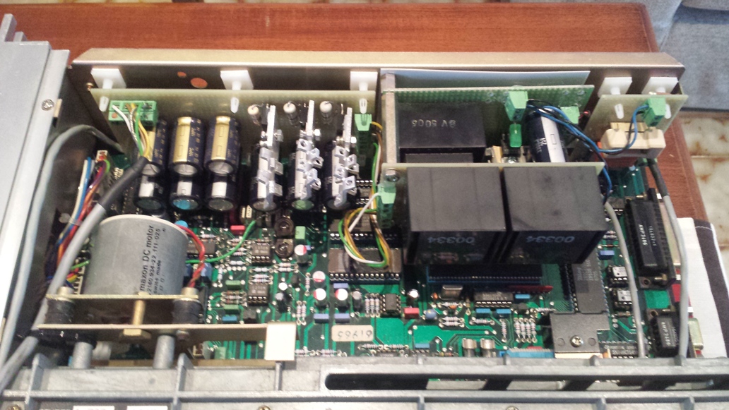

Anyway... under here there are the photo of the original configuration.
Nothing special maybe... but still wonderfull sound...

Yes the little blue MKT of the first photograph are Philips ! (very specific sound signature)
How looks the two 100 uF of the +5V pin ? little Brown ceramic smd caps or radial chemical ?
I would keep the 0.022 uF at -5 & -15V !
Are you still with the supply of post 1 or the one of the shematic above ? If yes, try to remove the 2 x 100 uF at +5V (do it carefully to keep them and going back if you need it) and swap them with 0.22 uF to 1 uF (MKT or better smd PPS or ceramic).
I asssume the 100 uf are radial chemical caps or if the one with red marking, certainly Nichicon FP serie polymer caps (near the SA7020 chip?) and the 22 nF the blue radial MKT ?
I don't like the Nichicon FP at all (dull while being soft), not sure it was a good idea to put them here ! Remove them and keep the blue mkt if you are using the shematic of the first post with my modification about bypass cap I given above (you just need to buy some caps if not having the smaller value of FM & FC but you can beginn with OSCON SP or Black Gate if you have it). At least my humble opinion and what I try first !
Always work with the same songs and albums to benchmark your revisions between each others !

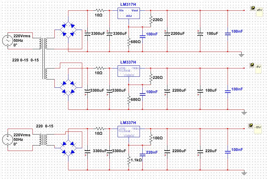

At this point I decided not to throw the job done and I modified the pcb I used to do the shunt psu and I built another psu on the basis of the original (and based on the material that I already had 😀)
The diode bridges used for the +/- 5V are W04 while for the -15V I used BYV27 diodes.
As for capacity, the first two 3300uF capacitors are Panasonic FA, those from 2200uF after regulators are Panasonic FK, the 220uF on the -15V is Panasonic FM.
As regards the two 100uF on the + \ - 5v these are of Nichicon FP.
Every 100nF capacitor is Philips orange MKT.
For now, this seems to be the best configuration (with the material that i already have).
The amazing thing is that the small 100nF capacitor are very important for the entire result.
Off course, I'll do other test but respect than the original PSU, this go really better!!! Bass are really powerfull and fast, but the wonderfull thing is that it seems that "now the music is out of the speakers "...
So... it seems that this is the right way for my system...
Please, i'll be very happy to receive any kind of advice!

Not really better advices. It seems you found the subjectiv good equilibrium and you're happy with it! That's great.
Studer players were famous to be maybe the best cd players ever made with the TDA1541. It seems the developers knew what they made 🙂
Maybe one thing, you talked about the power suply "unit" but on the initial first photograph I see there are some polymer Nichicon FP (polymer witrh red marking for minus) cap ? Am I correct ? Are they the two 100 uF of the shematic? But one seems to be near the -15V pin and the other for one of the -5 or + 5V ????
Maybe you can try again without it and check if there is a smd or small mkt bypass (the so-called 22 nF of the shematic !) ?
Yes you are right!
About the 100uF capacitor that you see in the first picture, they are nichicon FP.
They are here because after that i bought the cd player, i totally recapped it and i putted those "very good specs capacitor" instead of the old ROE capacitor.
So also if one seems to be near the -15, is connected in parallel on the +5v with the other (c10-c39 in the schematics)
A curious thing about those capacitor is that when i removed them and measured, they were at the half of their real value (they were 50uF instead of 100uF).
And it was the same for other two cd player of friends of mine (another studer a727 and a revox b226)...
Maybe capacitor in this position are particulary stressed??? Really don't know...
Anyway... I found that (in my case), nichicon FP fit very well for the +/- 5v but not good for -15v...
With this last PS, you could swap maybe the FP with this one (just one of 470 uF instead your two 100 uF): PLE0J471MDO1 Nichicon | Mouser
I find it subjectivly far better than the FPs... but don't know if it will work here (Sin Thomas technic !)
