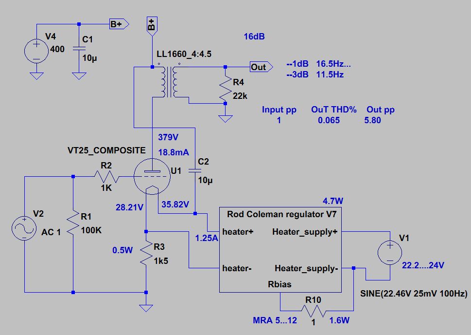

If you use 10Y with this -relatively- low (16-20mA) current, and inductive load, the low (200-300V) anode voltage is not optimal. The curves there are crooked, thus THD is higher.
I prefer higher voltage, for example about 400V, -30V bias, 20mA operating point, and 10k or greater load.
sample schematic:

Thanks for the schematic. But why did you wired the ll1660 as ALT-S ? Also, you put 1k for grid stopper. Did you experiment oscillations with those tubes?
I have parameters (parasitic C and L) only for ALT-S configuration.But why did you wired the ll1660 as ALT-S ?
Those DHT tubes (10/801/841) -which I use- are made for /radio/ transmission, so operating bandwith is very high. I automatically use grid stopper.Also, you put 1k for grid stopper. Did you experiment oscillations with those tubes?

I cannot see how a 10Y run at 20 mA can be more linear at 400V than 250-300V. A new law of physics?

25V bias into 1500R is 16.7 mA. Having 300V anode voltage I think it will be a bit less linear than 250V 18.5 mA. However, as the 10Y is very linear, the difference should not be much. The real difference is that in my example you need 300V total supply (including voltage drops in the power supply) while here you will need some 360V. In the former case you can use cheap but quality 350V caps, for example.
As I said, being a preamplifier you will not need the headroom specified in the datasheet (i.e. 57V RMS) so you can run @20mA quite happily.
