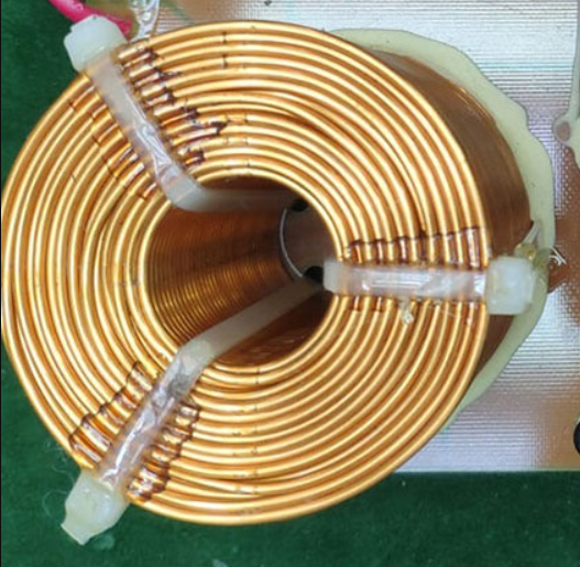

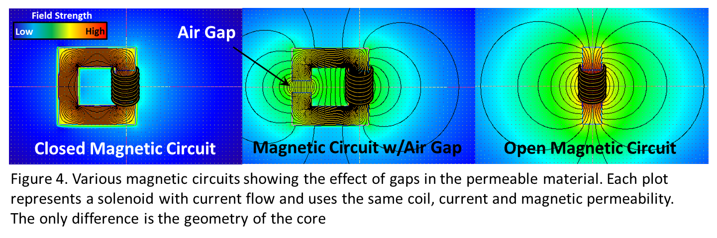

Stick out your right hand, and give a "thumb up". If your thumb is a wire with current flowing towards the tip, your fingers curling around it would represent the magnetic field lines that would form around it.
The video was of an air-core crossover inductor, and they were introducing a ferrous wire directly into the magnetic field at the center axis of the coil. For this doughnut shaped coil of wires all passing current in the same direction, the magnetic field has a toroidal shape, all of it passing through and concentrated most at the center hole of the coil and wrapping all around the outside circumference, using only air to conduct the magnetic field. (This is like the far right side of the picture below.) Air has a high magnetic reluctance, or resistance, if you will, so sticking a wire directly into this magnetic field and giving the field a super easy pathway to flow through like a ferrous wire right in the center concentration will maximize interaction with the coil. This has a behavior more like the center part of the image below- some flux travels in the wire, some in the air.
It's a shame they did not indicate setup conditions and show a scope plot- sounds like it was introducing a harmonic into the fundamental. I am assuming that it was changing the value of the inductor, therefore changing the cutoff frequency, or perhaps the loosely held wire was able to vibrate and introduce a frequency not in the original content? Iron cores are used inside some crossover inductors, but they are part of the designed inductance, and rigidly fixed within the coil so they cannot vibrate and add content. Either way, this is why zip ties and glue are used to avoid either problem in air core inductors.
For the toroidal power transformer, the permeable toroid doughnut core is at the center of the windings which are wrapped around it, so unlike the air core inductor virtually all of the magnetic flux is contained within the closed circuit of the toroid core. (like the far left side of the picture below.) Unlike the wire inserted into the air core inductor, which places a disturbance within the path of the magnetic flux, a bolt passing through the center of the toroidal power transformer is not within the flow of the magnetic flux. As far as the flux is concerned, the bolt is not "inside" the transformer, so the flux won't even see the bolt.

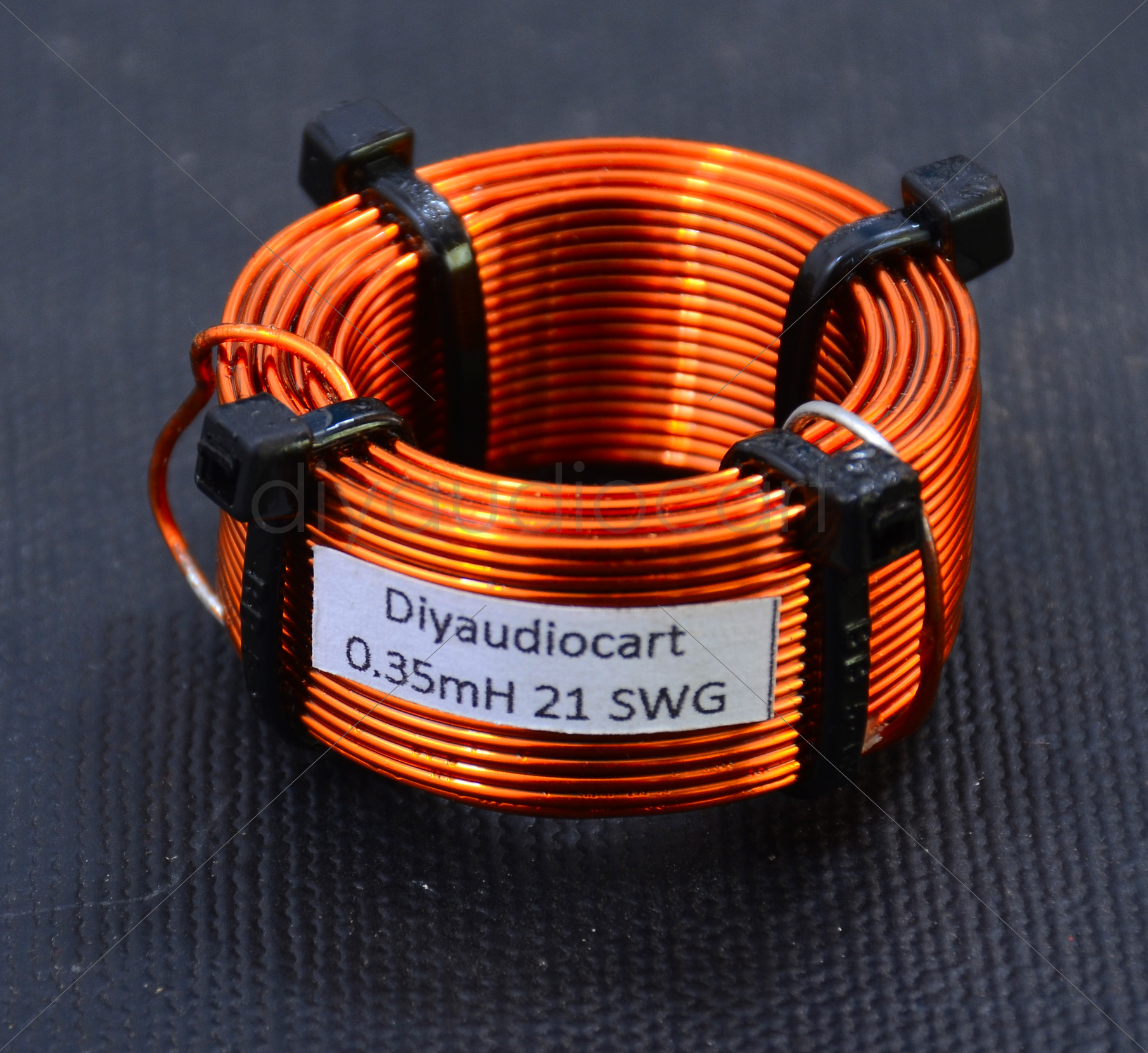

A ferrous wire placed inside an air core toroid will indeed generate harmonics. The eddies in the metal dissipate some energy at twice the excitation frequency.
If the air core is placed flat against aluminum or copper sheet, the inductance will drop, this due to exclusion of the field lines by the eddies generated in the metal. Losses will again be at twice the excitation frequency.
