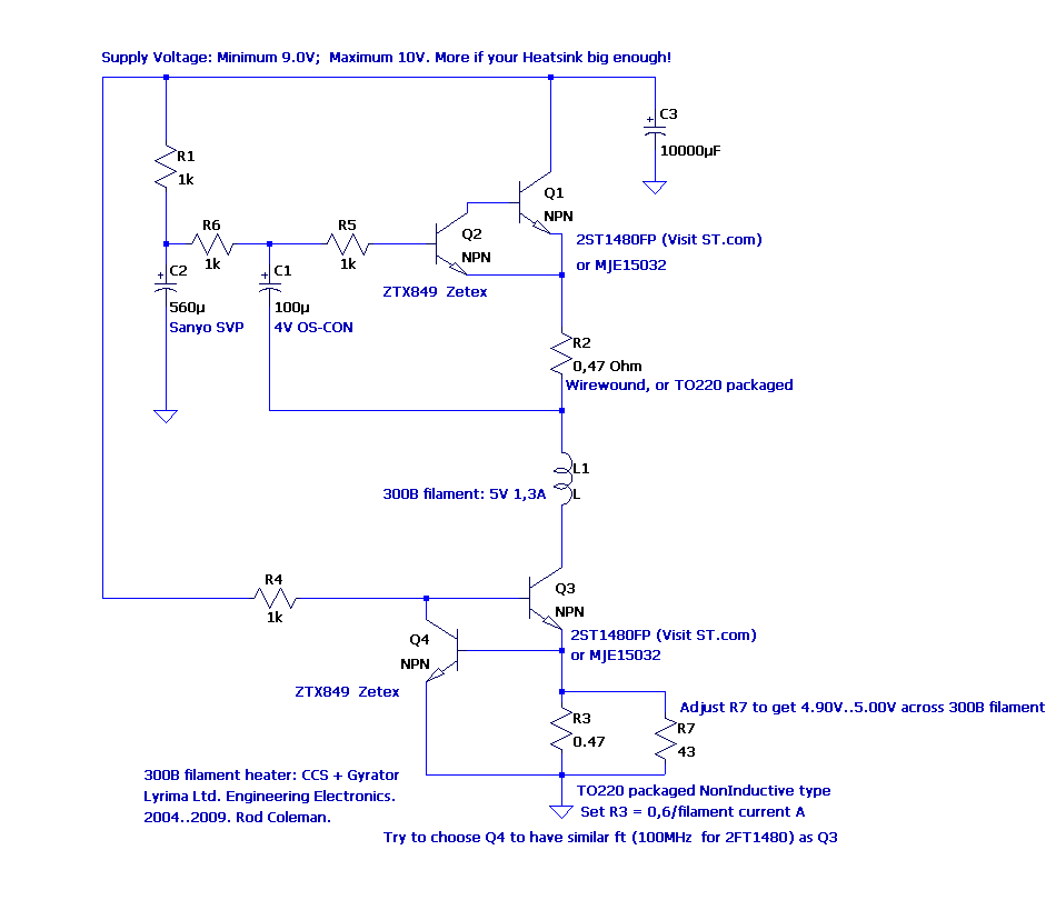

Just started building a 300B SE, the original design connect +5VDC to one filament, and the other to ground.
I want to implement a Coleman regulator, apparently I can't connect one filament to GND, which shorts the CCS part of the regulator.
Can I just connect F+/F- to both sides of filament without grounding? or any filament resistor needed?
