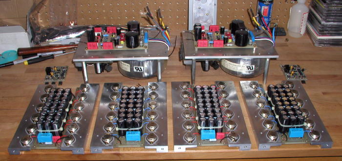

This is what it takes to build A75.

Two monoblocks, 24 devices per channel, separate active regulation for active stage.
Milling was the only elegant option with TO-3 devices and my sinks. The whole thing can be seen here: http://www.passdiy.com/gallery/a75-p7.htm

BTW - Do You use the original Pass regulator for the front-end according the A-75 design article or do You have an own design?Two monoblocks, 24 devices per channel, separate active regulation for active stage.
hm... I like the power supply construction you've got there with the trannie slung under the divider plate, along with some stuff which is presumably the rectifiers and power switch/soft-start circuitry... seems to me you could have the four screws for the standoffs go straight into the amp's feet, and you avoid the big trannie mounting bolt protruding out the bottom of the chassis... Nice idea! I'm going to rip-off this bit of mechanical layout for my Aleph-X monoblocks

hifiZen said:hm... I like the power supply construction you've got there with the trannie slung under the divider plate, along with some stuff which is presumably the rectifiers and power switch/soft-start circuitry... seems to me you could have the four screws for the standoffs go straight into the amp's feet, and you avoid the big trannie mounting bolt protruding out the bottom of the chassis...
You are right about this. The four screws that go through the amps feet are also used to mount the bottom panel. The divider plate isolates transformer from the rest of the circuit, acts as a mount for transformer and AC filtering, switching and soft start. And since the transformer is not mounted to the bottom panel, the access is very easy in case you have to change fuses.
I used banks of Panasonic HFQ caps since they were pretty good in 1995 (Digi-Key doesn't stock them anymore) and Gary Gallo was raving about them in TAA. I think they cost me around CAD 500. They fit pretty nicely between the bars and are very close to each device so current distribution is better (at least I thought so
I ordered 4 custom transformers from Plitron at the time, and since I persuaded them it's for a prototype and I'll be ordering more in a future I paid around CAD 100 ea. They were 750VA 33-0-33 and 50-0-50 AC.
To tell the truth I never compared the sound of the PS capacitors, I just believed they must have been better.

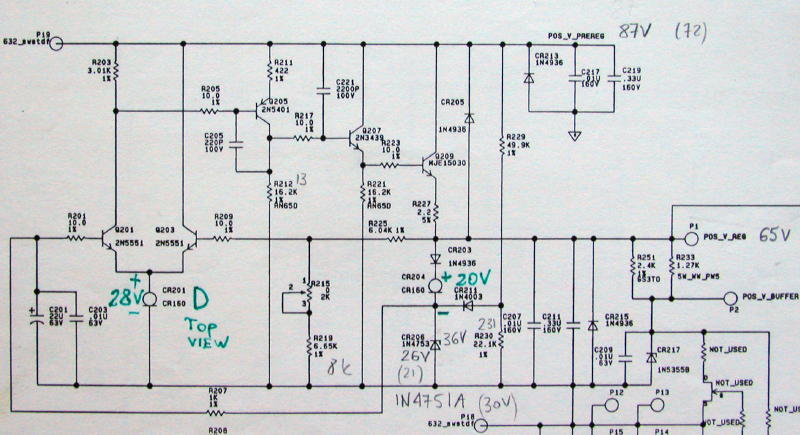

Hi Peter. I am new to the forum and I am trying to repair a ML 23.5 and was wondering if you had a schematic showing the entire power supply including the transformers etc for the ML 23.5. When I swith the amplifier on I get 240volts (UK) at the power supply PCB but the power on LED does not light nor does the soft start relay click in. Have you any suggestions what the problem may be,
