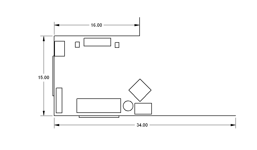

build complexity aside, I think the primary question to be considered is - which design is most suitable to the room
I think this is part of my problem. I have a medium room, being 16' x 16', but it is open on one side.

anyway you could sketch a rough floor plan that also references windows, access doorways, closets, furniture etc? absent that information no doubt plenty of suggestions could be made that might not suit the actual livability of the system in-roomI think this is part of my problem. I have a medium room, being 16' x 16', but it is open on one side.
A fine enough driver - no doubt Tony's Classic is one of many designs in this approx size/form factor in which it could work well enough to support the A7. Not at all an unwise idea to use existing drivers - appropriately.I agree completely with you and Dave on the helper woofer, but it would be yet another thing to learn and my wife is starting to growl at me when I talk about audio. I have some Seas CA22RNX, but have not even looked at them other than a glance. I had considered building something like TonyGee's Classic and just stacking the a7 on top with a crossover, but once again, I dont even know if this is a stupid idea. Oh well, more reading.

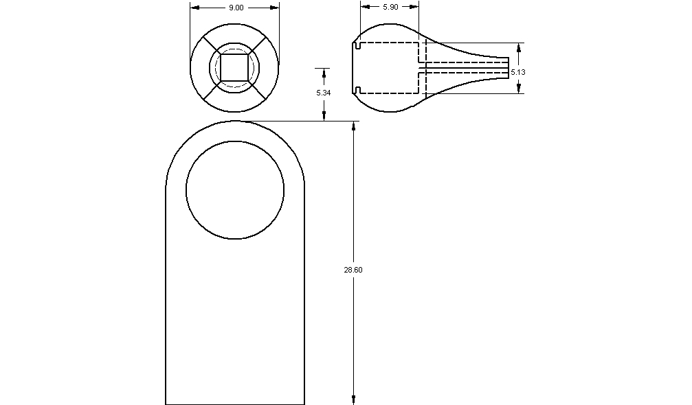

Here is the room and a proposed FAST. For me, the difficullt thing about the B&W teardrop, is the interior cavity. What if the interior wwas kept in cube form and treated as a normal box speaker. THe main benefit of the teardrop is the baffle diffraction, correct. So if i can achieve that gain and properly addres issues with cubic interior, I have a B&W on the cheap. I would make the teardop out of quarters that could be easily shaped, finsihing the interior and cutting the face, before temporarily connecting together(pocket screws or dows) and then turned to meet the outer shape needed. As i understand it, the teardrop is excellent for diffraction, but creates problems whenusing round interior for standing waves. couldnt these be dealt with in the above proposed idea with either professional absorptionmaterial or custom made spikes like you see in anechoic chambers.
I can get a 12" SLS right now for the same price as 10" pictured in the drawing. Pros and cons? I could always double up the 10", but seems unnecessary. Then again, I am a rookie. BTW. Te box could easily be squared off. Just playing with good looking ideas. Waves coming off driver will be below rolloff i believe, so diffraction should be a big issue, I thkn.
More going on inside that teardrop than meets the eye;
per "Technologies" at B&W website
interesting video:Cavities, of course, have their own internal resonance problems. Indeed, it is to get away from these that we use tubes in the first place. However, for once physics is on our side. Extensive computer modelling and practical experimentation showed that, if the cavity is a sphere whose diameter had a particular ratio to the diameter of the driver diaphragm, and a hole directly opposite the driver which is the same diameter as its diaphragm and leads to a tapered tube, the internal resonances are to a large extent eliminated. Any residual effects are readily mopped up by wadding inside the sphere and tube. The sphere also has the ideal shape for avoiding diffraction effects on the outside of the enclosure, with consequent benefits to the imaging.
Bowers & Wilkins - Sphere Tube
I think it's fair to say this is a very thorough piece of acoustic and production engineering - unfortunately, price aside, there are performance aspects of the large N series that frankly leave me a bit cold.
Back to your plan - you might well end up with almost perfect cube for a primary volume, in which initial reflections could be more problematic than could easily be controlled with materials that would fit inside the enclosure. A steeply tapered aperiodic or transmission line enclosure that could still be contained within your teardrop exterior might be worth considering.
I hadn't clued in before to your intention to attempt this shape - out of curiosity what materials and construction methods were you planning on using?
Wood. Cut the interior of each quarter in what ever way makes it plausible to deal with internal problems. Cut the face where the driver will sit. Route the hole for the driver. Make insert to fill new hole for turning. Join all four pieces, temporarily. Put it on a lathe and turn your shape. Simplistic explanation, but you know enough to fill in blanks. I feel pretty good about the execution. I need help on what to do on the inside without having to have precise interior curves. Aperiodic tunnel is very doable in same way main enclosure is doable. It would seem that all the problems that are present in this enclosure are present in a small sealed enclosure or even dMarKen enclosure.
While I'm not a fan of the gross material waste often involved, this could be a good case for the stacked lamination technique; even without further profiling, the interior should have much more chaotic reflection/dispersion characteristics than any rectilinear shape. If you're able to fit the entire rough assembly constructed by any method on lathe, I'd guess that shaping the exterior is the least of your worries.
Of course a CNC would bring a welcome element of speed and accuracy to machining of the rings, but with time and patience, it's nothing that couldn't be accomplished with a combination of hole saws, router circle cutting jigs, or even a jig saw. Not something I'd personally care to try - I'm a bit too old and lazy for that - but I certainly applaud your enterprise.
It's the concatenation of standing waves from implied cube shape that would cause me concern, particularly with regards to disturbing the controlled flex of the Alpair's very light metal cone material. On any design other than subwoofers, Dave goes to great length to distribute the 3 dimensions along ratios other than 1x1x1 - even though there will always be some reflections created with any number of parallel walls, a cube is something that I think you should try to avoid.Aperiodic tunnel is very doable in same way main enclosure is doable. It would seem that all the problems that are present in this enclosure are present in a small sealed enclosure or even dMarKen enclosure.
