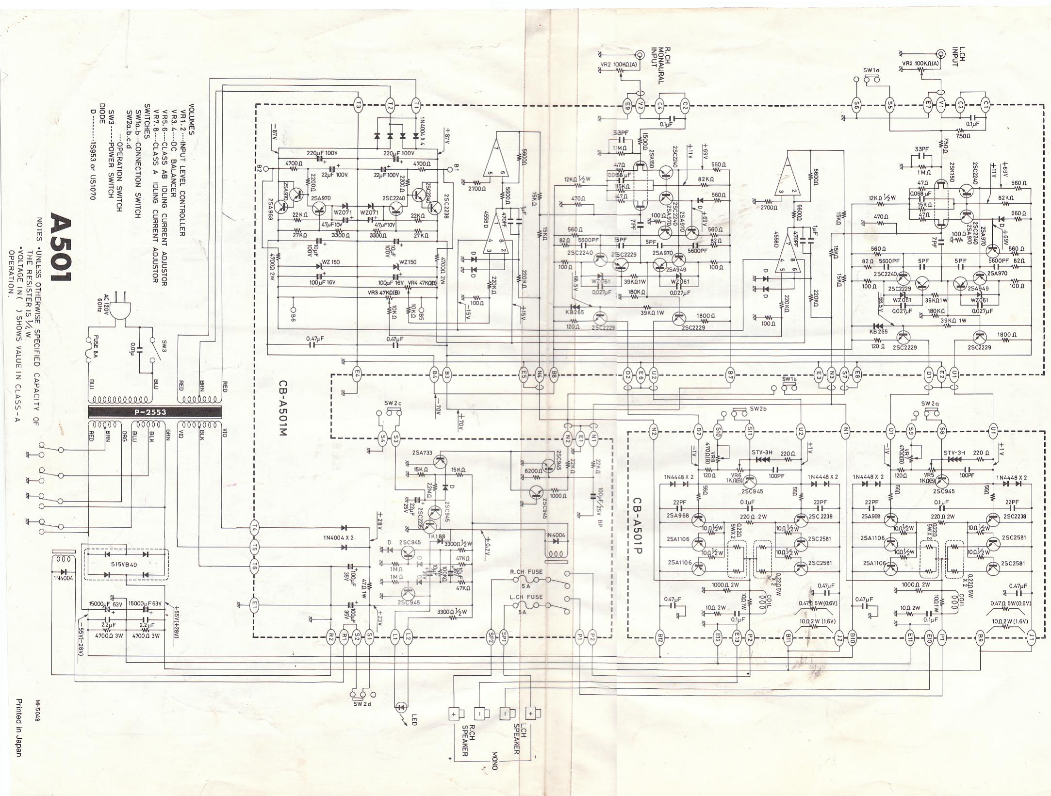

A501 / Z501 Luxkit Amplifier schematic
I Am posting this schematic for the Luxkit A501 amplifier.
I believe the Z501 is the same, just a different market.

A501 Luxkit DC POWER AMPLIFIER
I do have them
big files though
Any chance obtaining a download of the manuals for this unit.
I have a A501 which is working, except when run in the class A mode the idle temperature climbs to 140 degreesF within 1 minute and continues to rise. This seems excessive, I can feel the liquid boiling in the heat transfer tube at idle. I expect heat as with class A 70% power draw at idle but.....?
I'm wondering if just idle current adjustment is required, and it's falling into a thermal runaway scenario.....?
DC Balance always reads 0v across outputs and is stable, at minimum the correct adjustment procedure for the DC-Balance and the A-I (idle current) would be most appreciated. Also if possible the AB-I (idle current) adjustment could be checked and verified against what info you might have in the manual.
Hi Don,
looks like DruidA posted a good link for you.
I have built two A501's (z501) and both will boil after switching to the A mode. It changes the output transistor bias. They never turn to the off as they are biased in a positive state.
The boiling sound is normal and at very low volume levels maybe a little annoying.
As to the actual temp they run at, I am not sure. Hot they run! I can measure it if you like and post it for you.
I would just verify your Offset and bias settings in both modes. If they cannot be obtained you have another issue.
let me know how you make out.

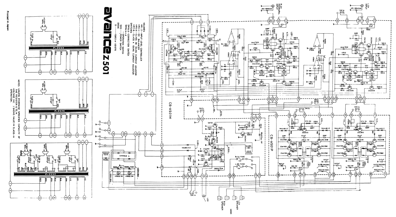

I have a the schematic that is posted earlier in this thread, which I believe to be correct, but I don't know where to start to find the Protection Circuitry components.
Is anyone able to shed some light on this for me? Appreciated.

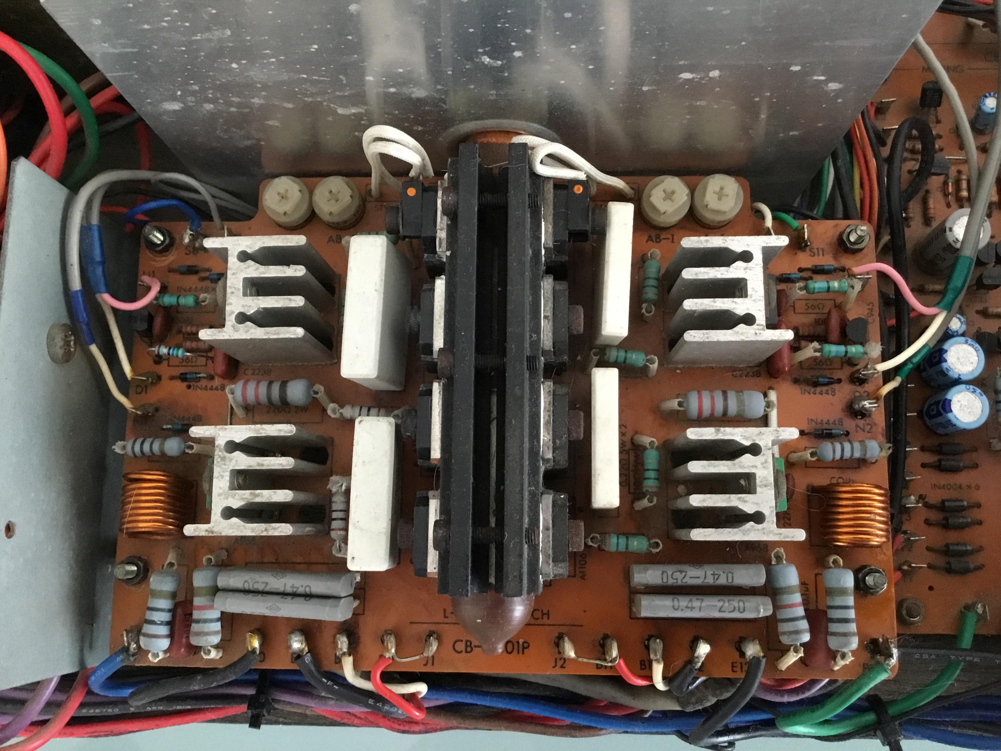

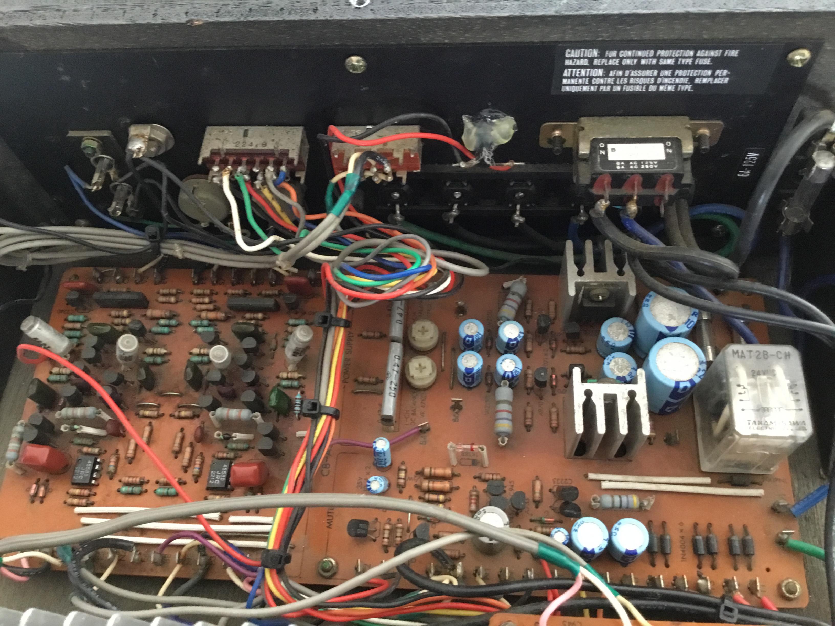

Thanks for helping me with this. Internal photos provided, in the event that someone spots something obvious.

Protection Relay perhaps?
I did wonder if the early 1980s Protection Relay may need to have the contacts cleaned - and was therefore causing the problem.
But thinking this through, I estimate that the Protection Circuit wouldn't work at all, if this were in fact the issue. Perhaps I have this wrong?
In any event, I have given the Relay itself a bit of a firm "tap" on the head - as you do - just to see if it is somehow "stuck".
No change of status. Protection Circuit remains active, locking the amp up completely.
