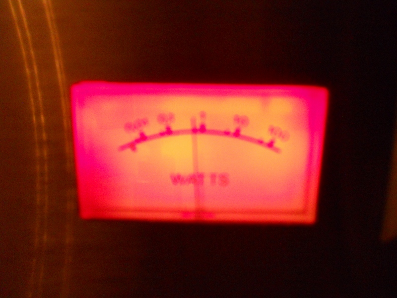

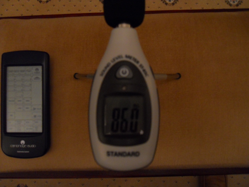

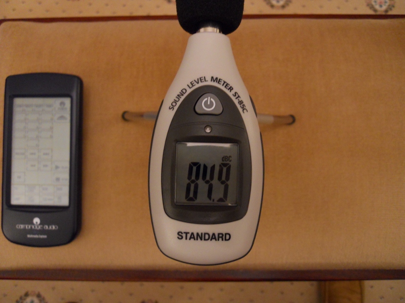

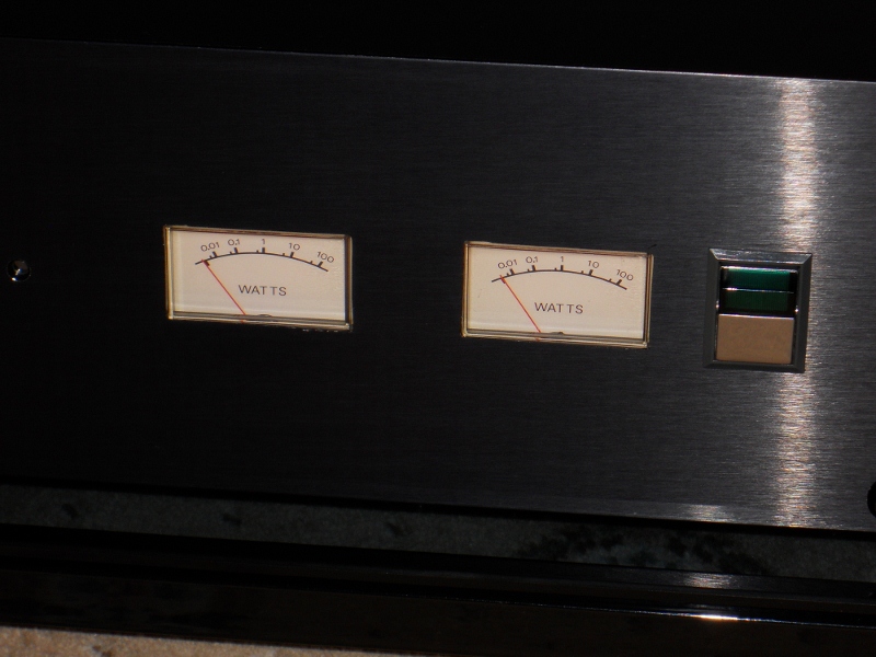

Test is done, apologies for the rotten pics... it was so bleedin' loud ya know
And that's with a fresh set of earplugs well fitted lol
So I did the test, you can see the SPL meter here, C weighted. Very little difference between the mono and stereo tracks.
I then went back and ran Panos 220 Hz track at this same volume setting and measured 3.7 volts RMS.
Keeping that volume setting I played the Eroica track that I posted "Cooledit" shots of earlier. That peaked at around 93 ish db. And it was to loud for comfortable listening for me at that.
The Mooly Amp has power meters accurately calibrated in volts onto 8 ohms and so I guestimate the Pano noise test at 0.5 w RMS. Clear shot of the meters so you can see the scale.
