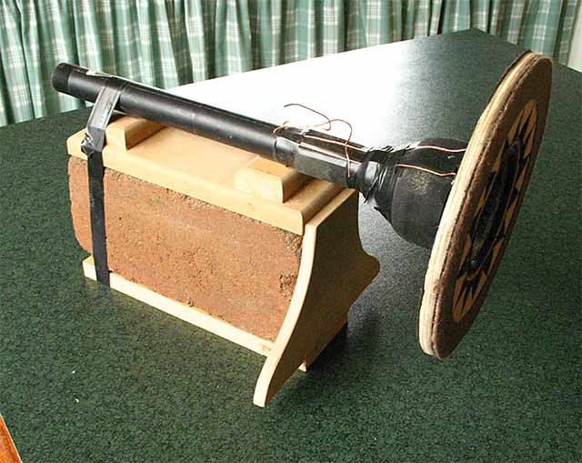

My speakers are probably effiecient, I am running OBs based on 93db 4 inch drivers (heavily modded ) with the bass handled by separate 12inch woofers and amps, so I suppose all things considered I am looking at around 94 db efficiency. The speaker system like the rest of my system is now being built into it final boxes etc after about 2 years of testing different configs etc but that is a whole other story.
Here is a pic of the modded driver on its sub baffle , this then mounts into the baffle but does not touch it at all and the whole lot sits on a concrete column, it bears virtually no resemblance to the original driver and sounds nothing like it either.

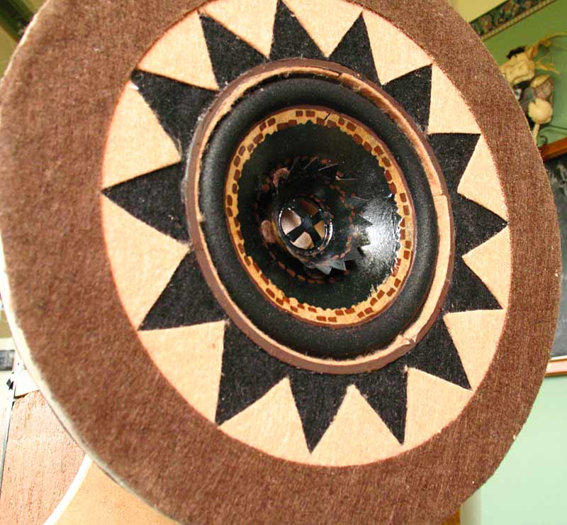

Here is a pic of the driver on the mounting block, but only taped on for photographic purposes, in the actual set-up they mount via steel saddles. The whole idea is to totally isolate the driver from the cabinet/baffle for a clean uncoloured sound.....which it does do very well indeed.
These drivers and LM1875 on batteries are a perfect match, the 6 watts or so is more than enough to drive them well.

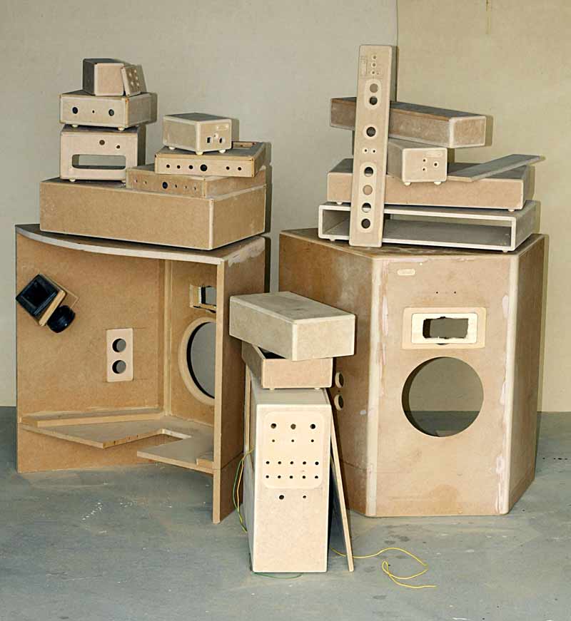

This really needs a whole separate thread but I am holding off till finished, in fact this is a complete system, here is a pic of most of the casework I am building before I sealed and sanded it.
In the end I will build a web page on the whole system but in the meantime a sneak peak.
Oh and my amps are built into the speaker cabs too.

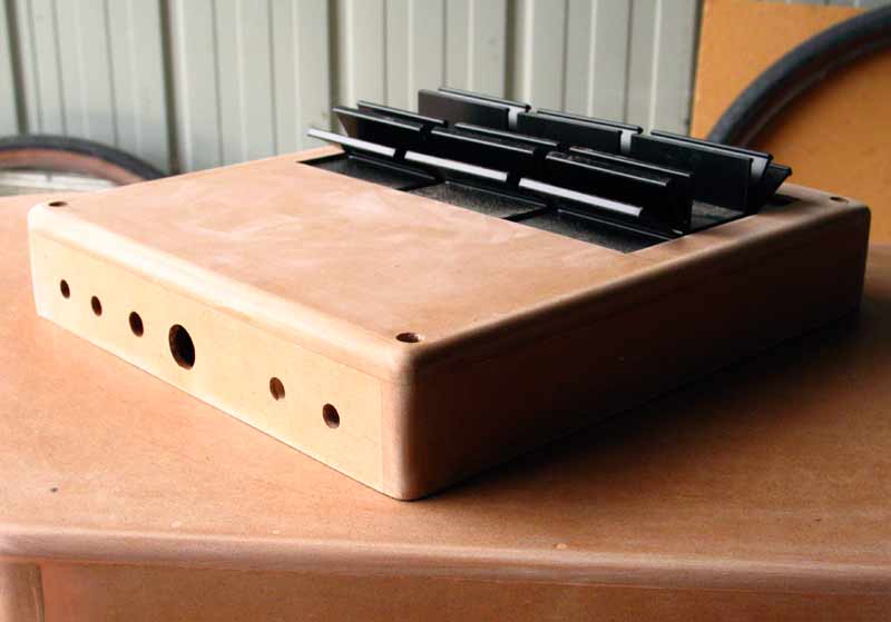

Here is a pic of the casework for 1 of the amps, this goes inside the speaker baffle. You will notice that there are 3 heatsinks, 2 for the bridged amp module and one for a purpose built tweeter amp, which will run different gain, input caps etc.
It will be painted gloss black to match the rear of the baffle.

EDIT: Gloss black, with all that pretty woodwork, paint is almost a crime. ;)
Ah, but what do the bicycle tires do? Is that a shop secret?
