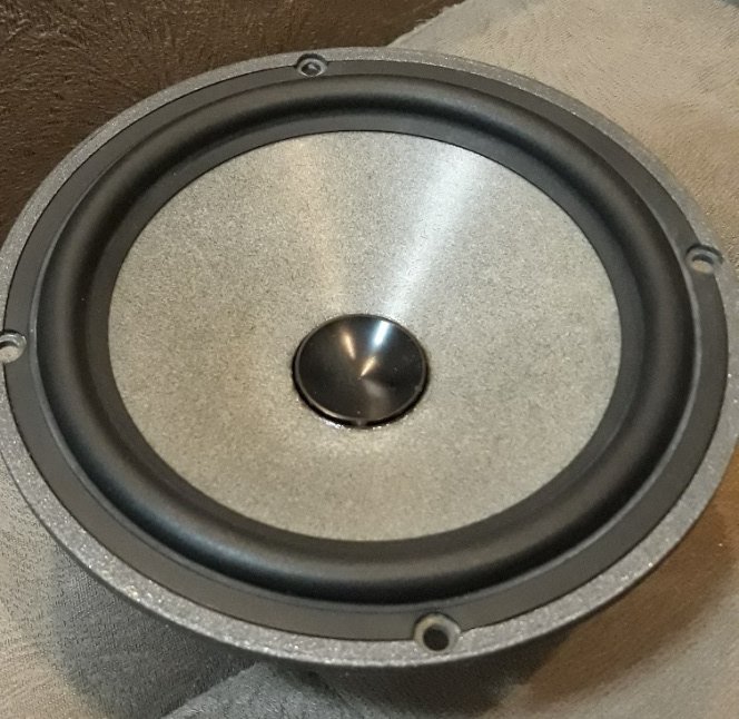

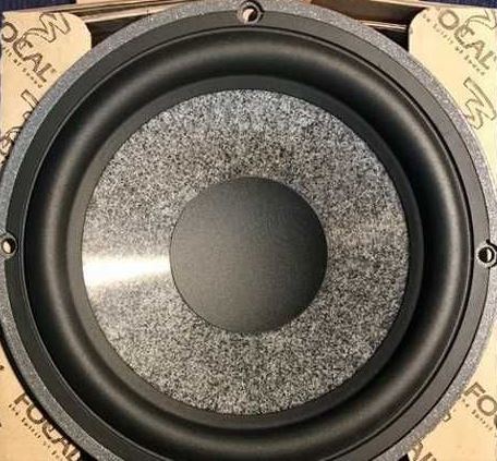

I have a pair of Focal Profile 918 speakers.
The midbass woofer is the reference 6W4359.
The bass woofer is the reference 6W4459.
Does anybody know if this midbass woofer (6W4359) is capable of reproducing low-bass frequencies as the other woofer of the speaker (6W4459)?
I found this page on the net where somebody buit a tower speaker by using this same midbass as full range woofer, which gave me the hope that I could use it as such too.
https://www.lautsprechershop.de/hifi/benue_en.htm
Meanwhile, I tried to get an answer to this question directly at Focal in France, but all I got was this reply: contact your local Focal retailer.
It happens that my local Focal retailer doesn't give me an answer.
So it would be great if anybody could answer me this question .
Thanks in advance.

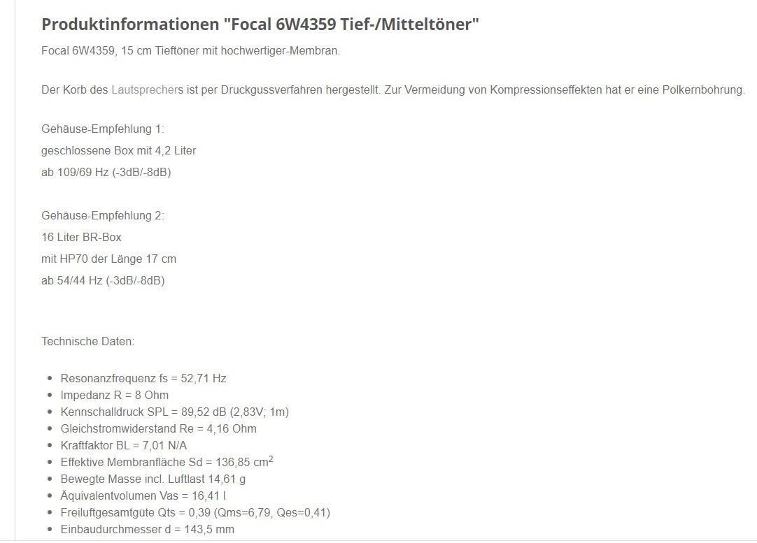

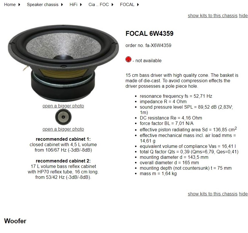

In addition to the post above, does anyone know what's the nominal impedance of the Focal 6W4359 woofer?
Here it is said to be 4 Ohms
And here it it said to be 8 Ohms
So I am confused about this information too.
The Re is the same in both sources of info, clearly there's a typo on the German page. Do they sell multimeters in Brazil?
