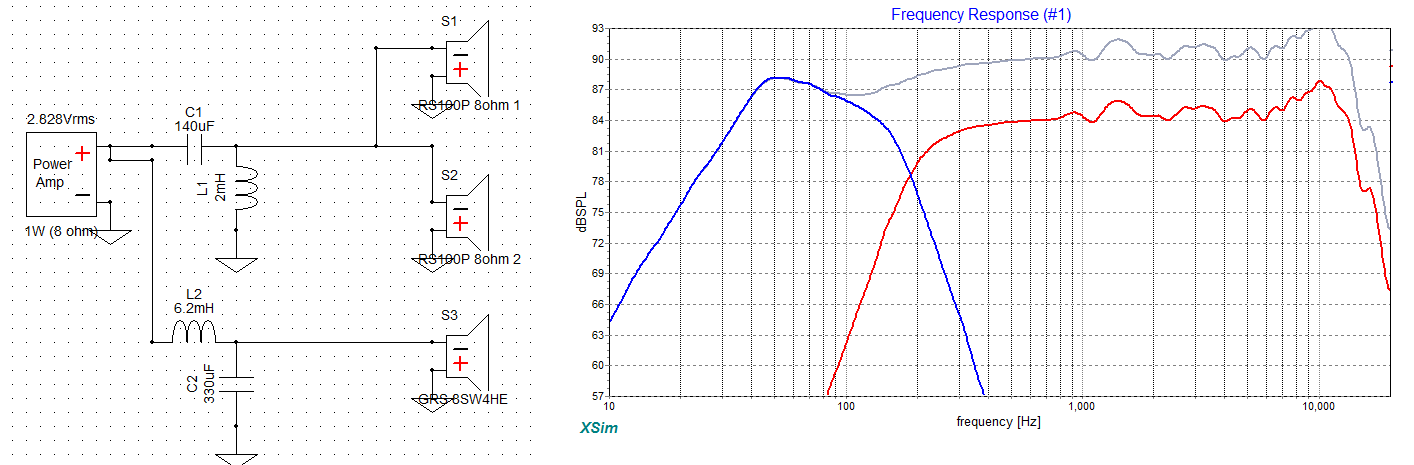

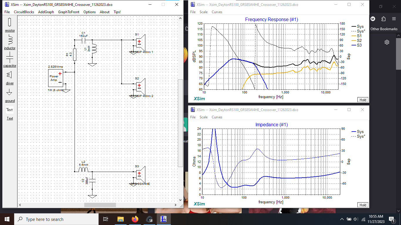

Hello,
I'm struggling to get something remotely acceptable on this crossover. I always seem to be pushing the cap values too high to be practical (cost) to force a curve, so I'm clearly doing it just wrong.
I'm trying to see if I can get an acceptable response curve with 3 drivers. Two drivers are smaller full range 8ohm 4 inch drivers that will be wired in parallel (4ohm final load). One will face forward, the other faces up on top (Castle config with a WAW/FAST). The bass driver is a 4ohm 8 inch driver. I was thinking of crossing around 200hz or so. I can't seem to do a good high pass and low pass setup on these. I wanted to set a high pass on the bass driver to drop it off under 25hz to avoid excursion problems. And a low pass on it to be able to better crossover around 200hz to the full range drivers.
I've attached my Xsim model with the FRD/ZMA and drivers and all in there. I removed the bad circuit stuff I had going on.
Any advice or help on how to better approach this would be great. The stock curve I see without any crossover stuff is actually what I would be happy with, but I can't seem to get back to it when I start adding crossover components.
Thanks for any thoughts or help. 🙂

There are some things to bear in mind when you do this, such as accounting for the power distribution, since this isn't included in single measurement work like this.
It could be done academically, such as assuming the higher frequencies don't overlap in space although Xsim assumes they will. Therefore you might let the higher frequencies shelf upward in the simulation, knowing they won't do that directly from the speaker. You'll want to discover the frequency where this applies. It will be related to the baffle step and the driver size. You can also add resistance on listening test.
Speaking of the baffle step, this is another factor to account for. You might also use a combination of simulation and listening test to determine where and how much.
The other issue is the low impedance which the woofer is showing in the region where the crossover interacts with the impedance peak. You may find the output is increased there.

Thank you so much Allen, that gives me a great start.

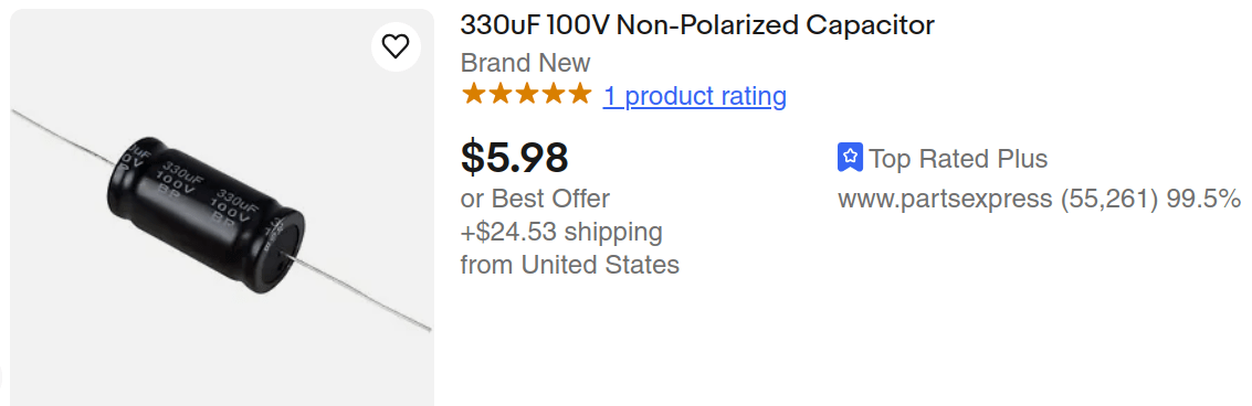

Now to see if I can find affordable 330uf and 180uf caps. Those values seem to be very expensive. I was running into this issue as well when trying to adjust the filters.
Any suggestions for sourcing similar caps to these appreciated!

I can get a pair of electrolytics to put back to back, retail available locally for around 50c. Non polar ones tend to be more expensive, but once you mention the word crossover, they get much more expensive.. so don't..

Ahh ok, thanks, so it doesn't have to be big giant metallic ones. 😛

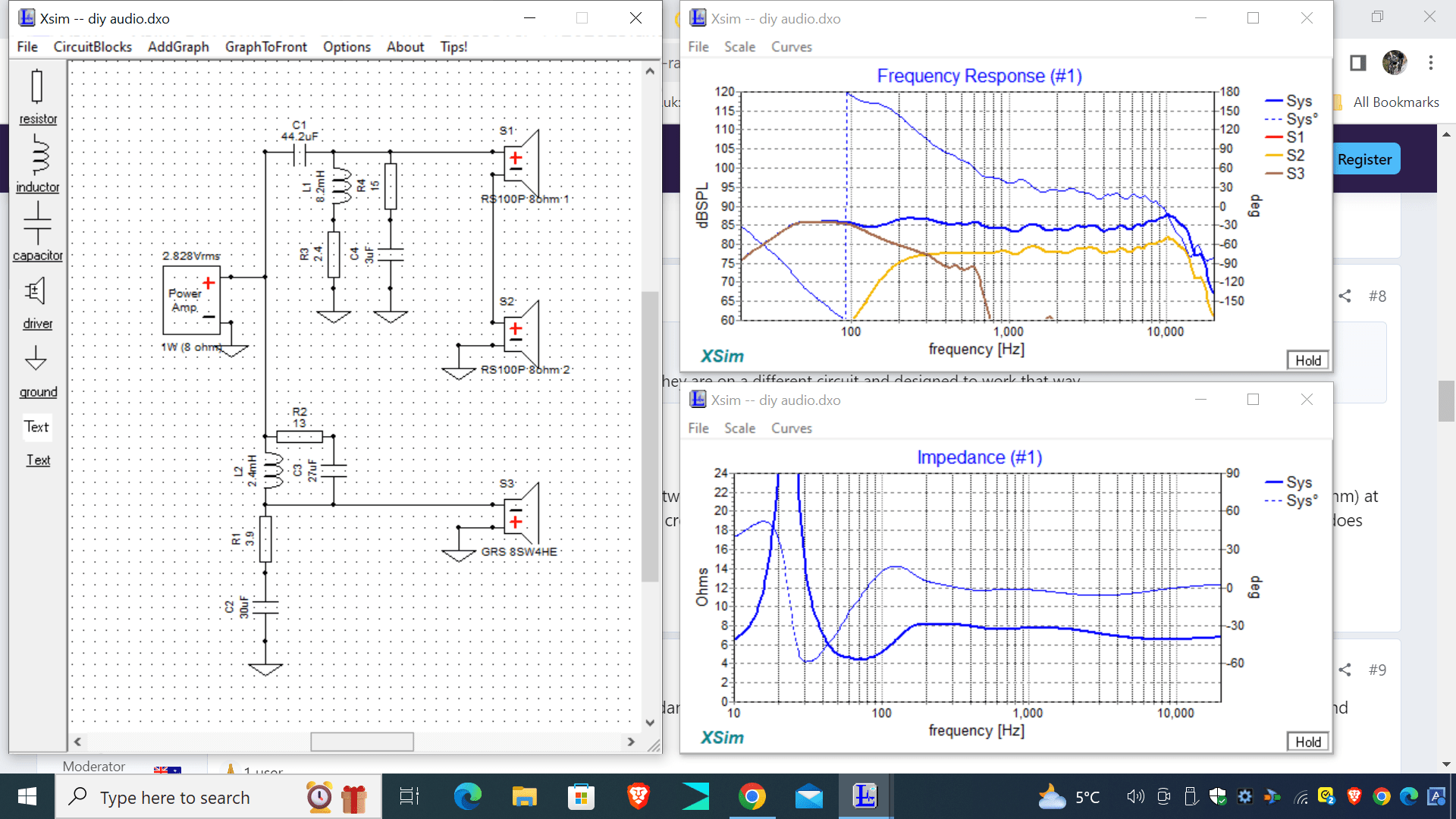

Any thoughts on the following?
I am not really going for flat, a slight `V' response simply due to preference, as I like a little more warmth and a kiss of sparkle for stereo music listening (keeping in mind these will not be corner loaded nor up against a wall, but away from the wall in a room).
In theory, the frequencies above 1kw should start to drop by at least -3db as that driver will be faced up, so the response curve below would roll down by about -3db maybe less as it goes up from 1khz. This is my assumption, but I would have to listen and measure to see how it actually behaves and adjust as needed. The hump in the bass driver will actually shift left and center over 30~31hz as I would be changing that via bass reflex porting at that frequency (see WinISD model below for the bass driver).
I've re-attached the crossover file for any suggested changes.

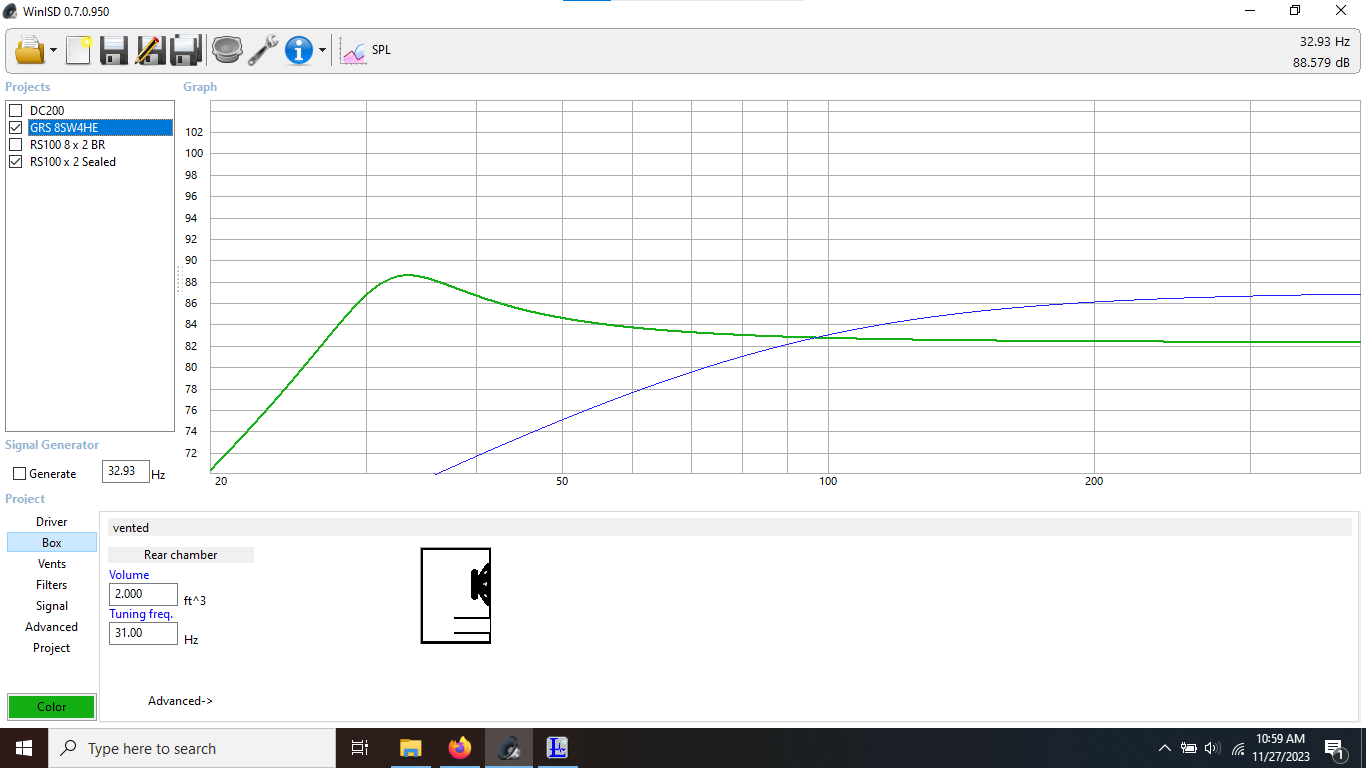

I modeled in WinISD how two of the RS100's would model in a sealed chamber together at 0.75 ft^3 and QTc 0.578. The lower chamber with the bass driver is bass reflex with a port tuned at 31hz in a 2 ft^2 net volume. I tried to model how they would look without a crossover at the same 4 meter distance with just 20 watts of signal.

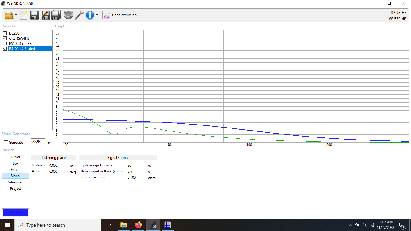

For excursion, the two full range drivers don't reach xmax until 80hz at 20 watts. The sub driver never gets to xmax at 20 watts, down to 20hz so I feel like I can get away without a high pass filter as none of my content for music gets down below that, and doesn't need to be louder than this really, but it can still take more power and not get to xmax. The crossover near 200hz keeps the full range drivers from getting to xmax even at 40 watts as it doesn't get to xmax at 40 watts until 100hz and it slopes off before that.

Wow that's smooth! Thank you so much for that. Something to work towards.
I'd have to figure out how to actually assemble and wire those series that end in ground (negative return).
