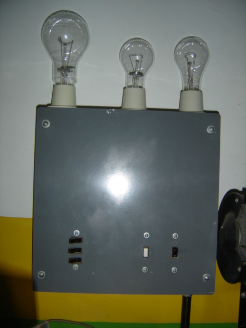

As was suggested by an old professor at the school teach us, called Todoruck (or the like, I don't remember exactly his name after more than 30 years), when testing some unknown state stuff or during repairs or restoration on electric appliances, we must provide some kind of current limitation in the event that the DUT is severely faulty. This is usually and easily accomplished by inserting a lamp (Filament, not led nor fluorescent) in series with the DUT and the live wire of the net.

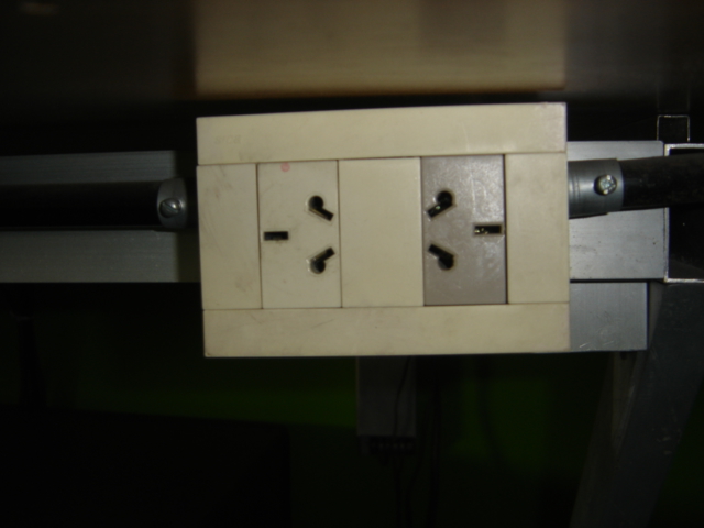

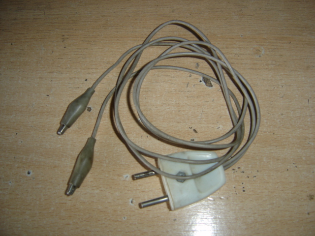

This is my system. A box with 3 lamps (From left to right, 300W, 150W and 100W and out of socket, another of 75W), and the left down switches connect one per switch in parallel between them, and the set in series with the live wire of my net. So I can make any combination of 75W to 550W (2.5A @220V) to test my unknown devices. I the pic below, you can see also a double outlet, the gray one is direct to line whilst the white is in the series system. There are three of them in the same code under the workbench. Last pic illustrates a test lead with crocodiles terminals for use with incomplete devices, like a trafo alone, a ballast, a motor, a lamp, etc.

The rest of the switchs and a white pushbutton enables a interlocked contactor, so small or shorts power shutdowns do not affect other services from this electric board.

THAT is the part I would not leave laying around.
(I'm not worried about YOU, but others who see the picture and copy the idea.)
