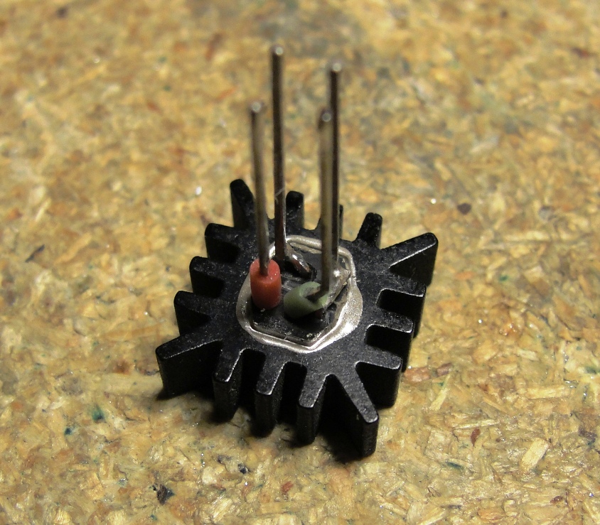

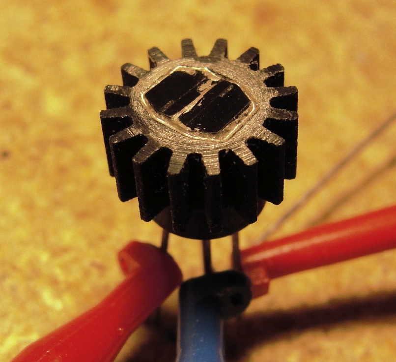

For thermal coupling, the most obvious is to glue the 2 devices face to face at their flat faces. This also provides a convenient connection for the source pin of the top device (the follower) to the drain pin of the bottom device (the current source). The gate pin of the bottom device can also be shorted to the source pin directly at the package (see photo), leaving only 4 external connections to the outer world -- +Vs, -Vs, input and output.

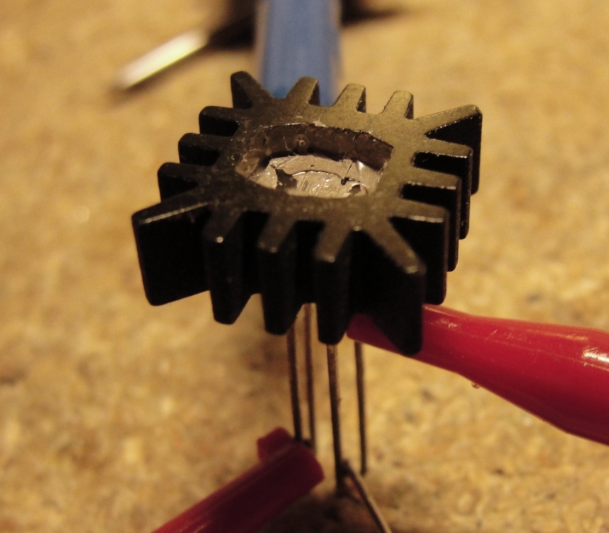

The thermal coupling can however be further increased by wrapping the outer surfaces of the coupled devices with a metal ring of sufficient thickness. This increases the gluing surface of the devices (the glue and the JFET package encapsulation are the highest resistance in the thermal coupling path), and hence reduce thermal resistance. Aluminium has a thermal conductivity > 10x that of silver epoxy, so that one can treat the thick aluminium ring as a thermal short circuit.
It is only natural that we make a heat sink out of the “ring”. We have tested 2 designs, a rectangular one measuring 10x10x4mm, and a cylindrical design of 8mm diameter and 6mm high.
The rectangular version is glued with 2x 2SK372V of Idss 21.82mA and 22.37mA respectively (these are my matching rejects and is used here for thermal design verification). Using supply rails of +/-9V, the steady state heat sink temperature was measured at 44°C, and the output DC offset at -6.5mV. The output DC meets expectation, and it shows that even a 0.3mA mismatch will cause measurable DC offset (even more for 2SK170s with its lower transconductance). The thermal resistance of the heat sink is calculated to be 57°C/W, not bad at all for such a small heat sink. Ambient temperature was 20°C. But more importantly, the temperature of the JFET die, calculated to be about 70°C, is low enough now to ensure reliability even when we are dissipating about 200mW per device. The DC offset remains constant to 0.1mV from cold start to steady state, confirming the very effective thermal coupling of the 2 devices.
The cylindrical version has even better performance, though quite a bit more difficult to manufacture. Using 2x 2SK372V with Idss of 21.82mA and 22.37mA, the DC offset was measured at -8.7mV, and the steady state sink temperature at 48°C. This corresponds to a thermal resistance of 48°C/W for the cylindrical heat sink.
