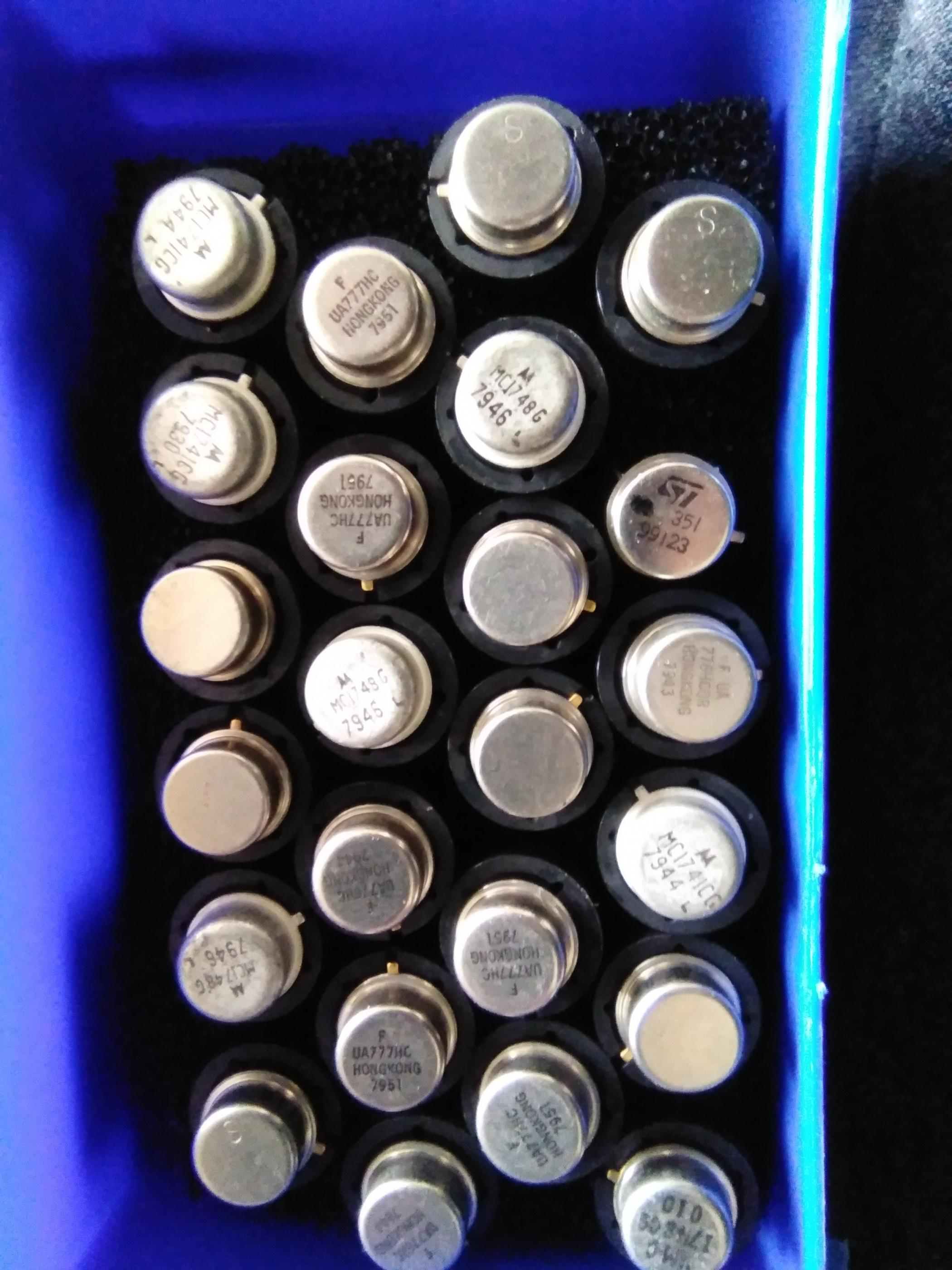

I've had a box of old Opamps I was kindly given to me a while ago, along with an old Weller soldering iron, lots of solder and an Beckman DMM from the early 80s.
I got them from a retired tech
Are the old can Opamps any good?
Most of the type numbers are unreadable. The ones that are readable are typical for the time frame, long superseded by better units.
But you can still use them of course.

If the writing I see can be believed, then you have a short tube containing a LM386 ChipAmp, so not bad. There is a couple in the box marked 555 (google it) and those are timers still in use today but are not OpAmps. But that is what is to be believed from reading writing on boxes and that writing may not reflect what is really in there or in the tubes.
The rest of the black components? Without a list and your picture doesn't do the laser etching justice, so you are on your own.
OpAmps come in many varieties from many manufacturers, some being use for very specific applications. These packages may contain a single or dual OpAmp... Analog Devices, Burr Brown, Texas Instruments, Signets, National Semiconductor, and others all made these devices in multiple models. The individual devices were also tailored to have characteristics like laid back or very aggressive qualities depending on the circuit design. Two different OpAmps in two differently designed headphone circuits might sound the same -- swap out the OpAmps for one another and you might punish your ears.
Easiest thing to do is ground yourself (so you don't fry any components), read the laser etching on the components, and type those into a Google search.

777 & 748 are **** for audio. too old, too noisy. Can't read the rest.

The round metal cans are 741 variants or pin compatible,some may need an extra "compensation" capacitor, download the datasheets.
I recognize MC1741, uA777, MC748, the erased label ones must have been some flavour of 741, make a small test jig on Protoboard and plug them in; most (all) should work in a classic 741 schematic, say an inverting 10X gain stage (only 2 resistors: 100k - 10k) , fed +/-15V
One might be an LF351. Never saw one in TO5 case but who knows?
This old Tech probably worked on some stuff (Industrial Electronics?) which *required* TO5 footprint Op Amps, no easy to find DIP8 plastic case will fit on that PCB.
FWIW my earliest own design SS guitar amps (1970/71) used round case 741´s because I had been building tube amps so far (Fender/Gibson clones) on eyeletted boards; impossible to fit a DIP8 there but possible by spreading long TO5 legs into a 12AX7 sized "octal socket" type pattern he he.
