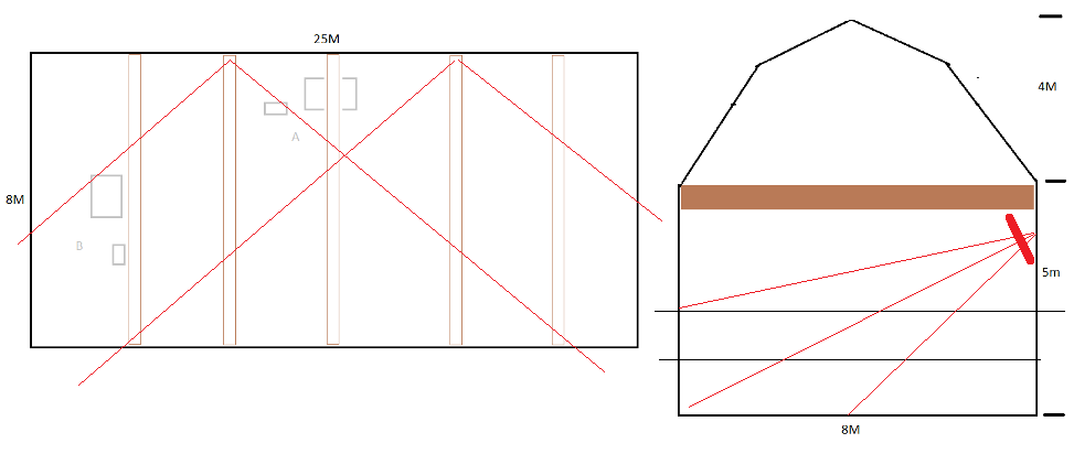

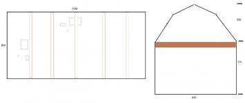

I attach below a rough sketch of the place. Altar and pulpit are normally in position A but are sometimes moved to B (weddings mostly). Currently, the sound system is as such: a 100W TOA amp (100V line, 4 mic inputs) and 5 small speakers (4" fullrange, closed, with a 100V xformer rated at 25W). Those 5 small speakers are attached to the wooden beams, directed directly towards the ground, 2 on beams 2 and 4, 1 on the central beam.

- Do I stay with a 100V line system or do I move to 8R speakers ? A 100V PA is pretty much idiot proof but the choice in affordable speakers (and amplifiers) isn't as good.
- If I stay with 100V speakers, the visaton wb16 seem ok as a modern replacement. Let's say I buy 4 of those... do I set them up like the previous speakers (for example, 2 on beam 2 and 2 on beam 4, firing downwards) or is there a much better way to proceed ?

That's a large space, have you considered a single pair of column speakers on the long wall?
This arrangement has worked well in a similar local facility.
Yes, I'm considering it too. That's plan B actually. I'm slightly worried about feedback though and uneven coverage in configuration B.

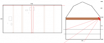

What I was thinking for the columns was to mount them not on the beams but vertically on the wall, on either side of the altar. I hadn't consider putting the columns on the beams.
As their vertical dispersion is only 30°, I'd need to put them both on the central beam to cover the whole width of the chapel. Horizontal dispersion being 120°, it'd give me a fairly uniform coverage (at 1.5m above the floor) only up to about 6m on either side of the beam... I'd only cover half the place. So yes, distributed looks indeed better from the top.

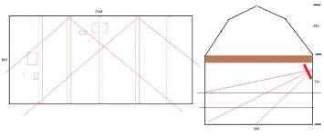

I was thinking some more about it. What about this ? Proportions of the drawing are off since it is a quick draw but it seems workable.
With two columns (120x30° dispersion) attached on either side of the center beam, I achieve a fairly good coverage of the whole place, except around the altar and pulpit. It creates a hole in configuration B but it is a bonus in configuration A.
The other drawing is what I had in mind initially for columns, attached under beams 2 and 4.
