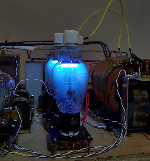

OK, got it. How about using a resistor in the primary of the separate filament transformer(6.3vct@10A) and connecting the 2-866a tubes in series with 5v ? The B+ would be taken from the CT of the filament transformer.
The 866's fillaments are not meant to be put in series, if you however put them in series this is going to burn out one of the fillaments over time.
II did some bread boarding and found that 866's don't balance filament voltage very well in series. Hard to get pairs that match well, but I have quite a few to try.
Why not just go on mouser and get a 2.5v transformer? They aren't expensive (about $18) and you won't hose a good rectifier.
I find the data to 866A tube with a parallel configuration, 2.5V / 5A x2 for the heater. I did not get a reference to FW series.
I love it when Glowing Blue in the dark.
And I've tried to apply Series with PT filament 5vac CT. I'm doing this to obtain Balance.
Are this a correct?
https://www.youtube.com/watch?v=2FUSUwZ3Ybg
866's need time to preheat.
for PT HV and PT filaments made separately, as said by .. there should be a time delay for HV.
C1 is a bit too big. 866A works best with choke input.
i have not choke input . used C input.
Works for me, 5vac
it´s a mustC1 is a bit too big. 866A works best with choke input.
