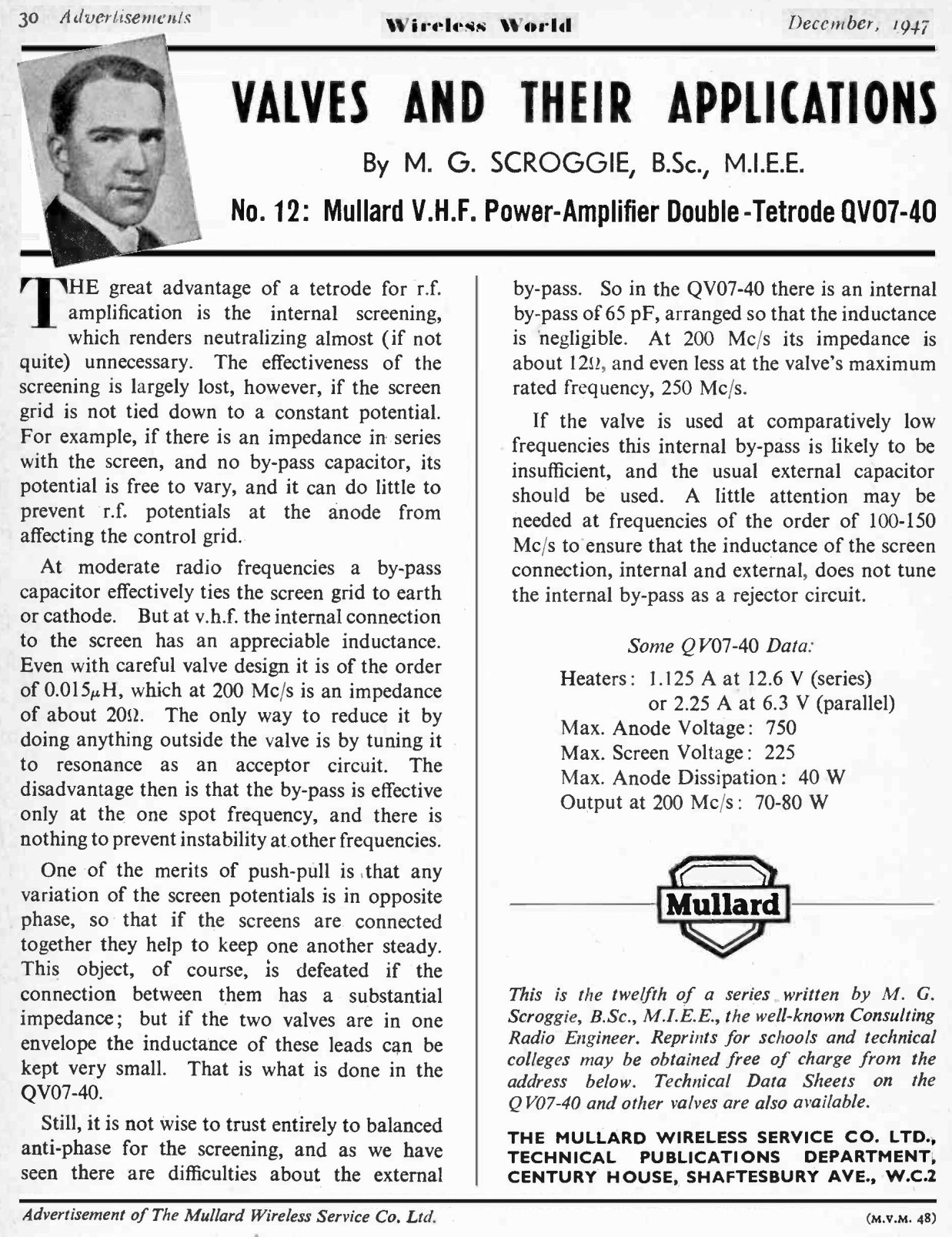

According to this info by Mullard the value of the internal capacitor between the screen grids and cathode is 65 pF.
  • No. 12 Mullard VHF Power Amplifier Double Tetrode QV07-40 (VATA WW 1947).jpg
