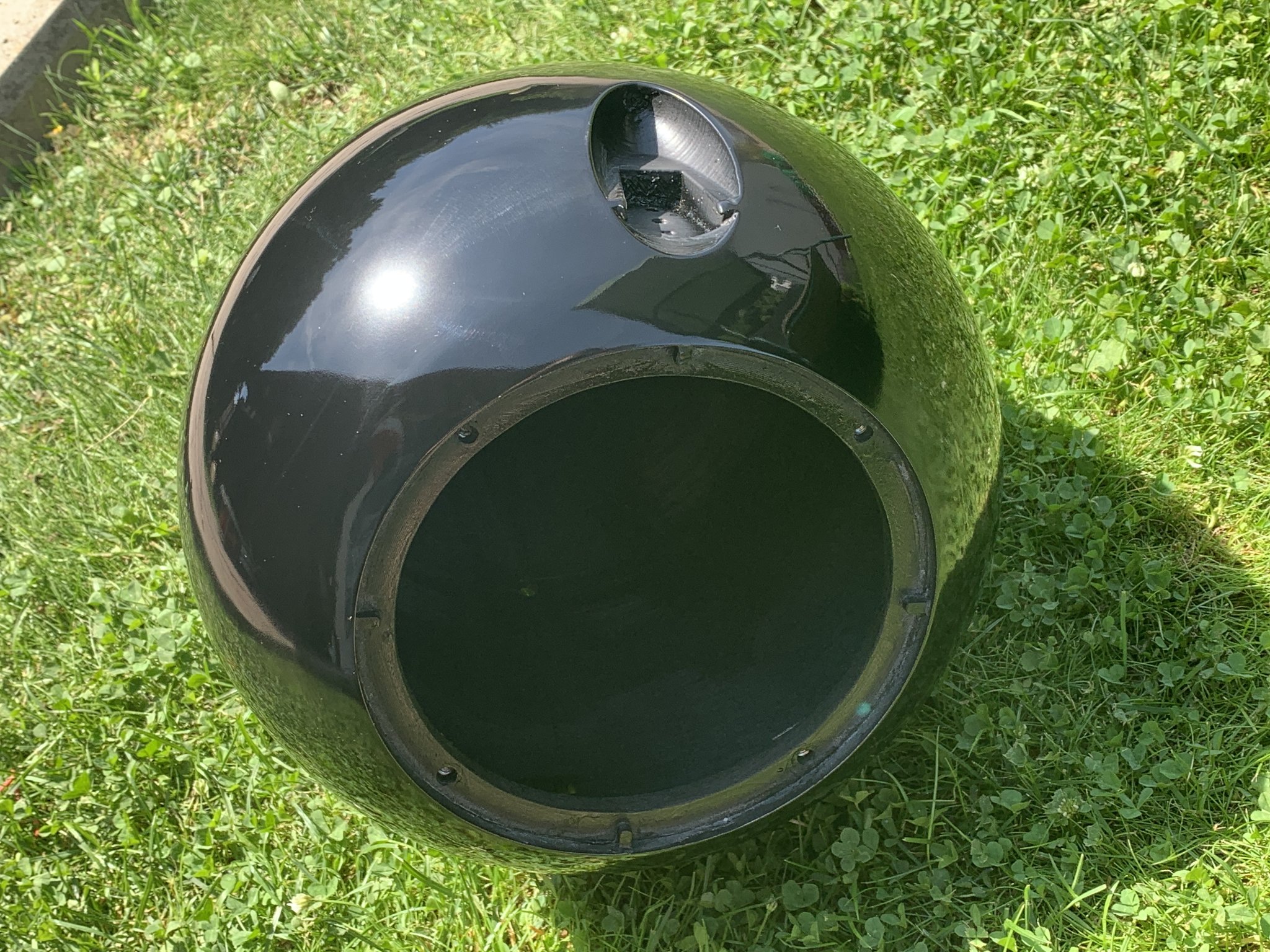

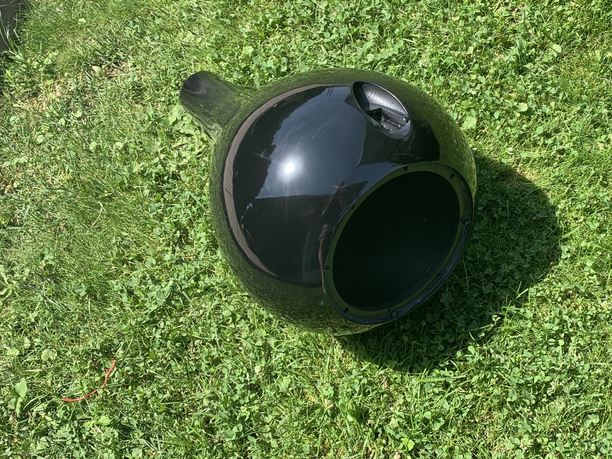

To make this all possible I started with mid speaker as they call it "turbine head". I told to myself that if I am not going to have this midrange speaker enclosure, its pointles to do anything or start by other parts... so I started to draw in Blender, a lot. It looks simple, but modeling really nice teardrop isnt as simple as it looks on first sight. Original b&w is very prolonged and I didn't wanted my speakers to be as big and deep. So I shortened it and modeled for standard speaker size. The result is 42cm deep teardrop with nearly 30cm diameter. First concept below:

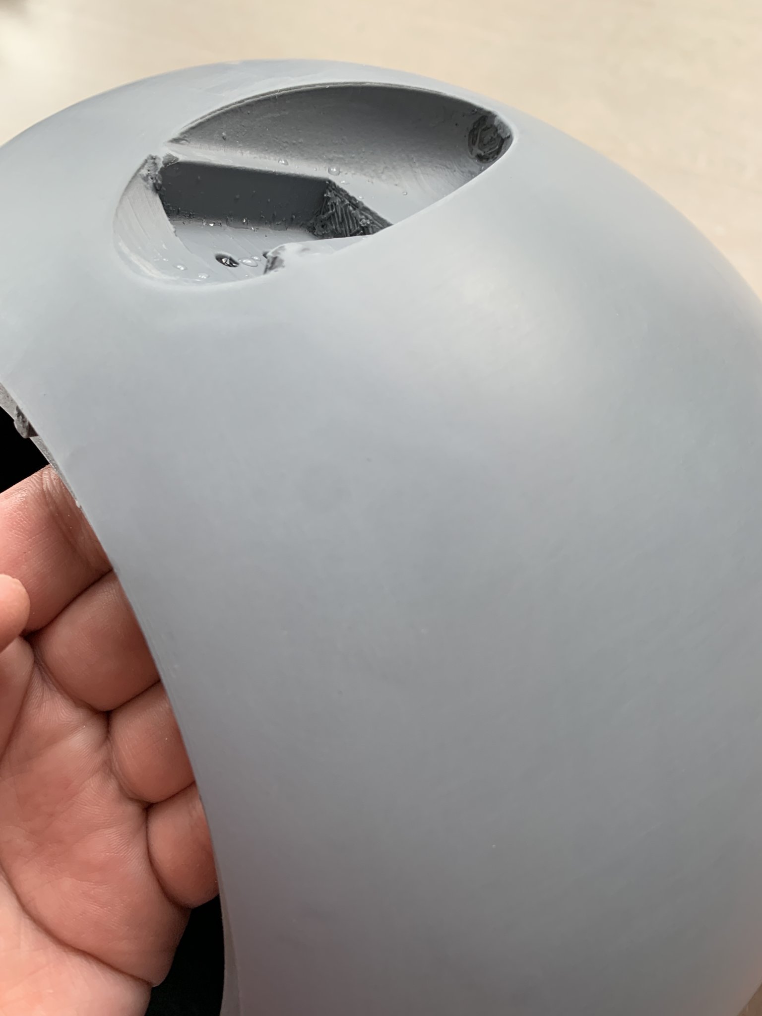

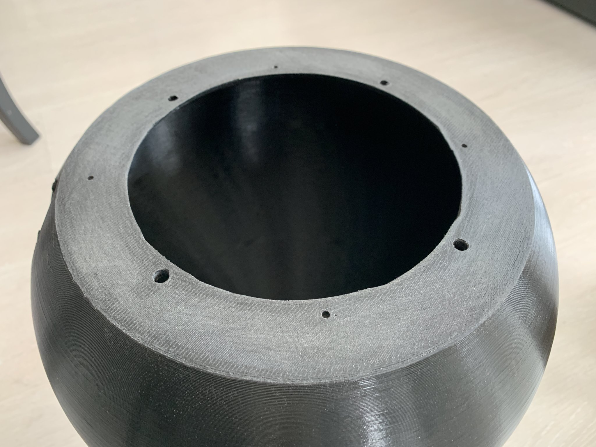

I have a friend who is master of 3d printing so he did print these for me out of PLA. Wall is about 7mm thick with trippled outside walls. I didnt wanted exotic materials, because of several reasons: price, and mainly print realiability. This was printed for nearly 2 days a piece. To make very shallow angles printable its impossible to make it as a one print so my teardrops are glued from two parts by epoxy. To make precise fit I printed also small guides and also speaker mount is sandwitched thanks to that. Below a few pictures of wall "cut" from one damaged print and front piece + tear piece prepared for glue:
more glue:
glued it already looked amazing, it had very nice "pearl" shine thanks to print layers, however because of front piece it looked not as good so I had to do something about it. I watched milion videos how to smooth 3d prints but tried my own way as the main point was somehow same. So I sanded all surface by 80grit, then I filled all surface by 2part polyester filler specifically for plastics. A lot of sanding and dirt... i looked like narco baron :ROFLMAO:
IMG-6044.jpg IMG-6042.jpg 70688277249-85511515-5-BC4-4-D8-E-B1-A8-688438297-E98.jpg
the result was really smooth, but not enough so one more layer and after sanding:
all 3d print raster dissapeared and I was prepared for primer. First coat was like indicator where the bad spots still are so again sanding and more primer coats. After about 4th or 5th coat of primer and water sanding it was absolutely smooth. I was very happy with the result so I knew the main part is acomplished so I started ordering wood and remaining parts. (I'll get back to teardrop later no worries)

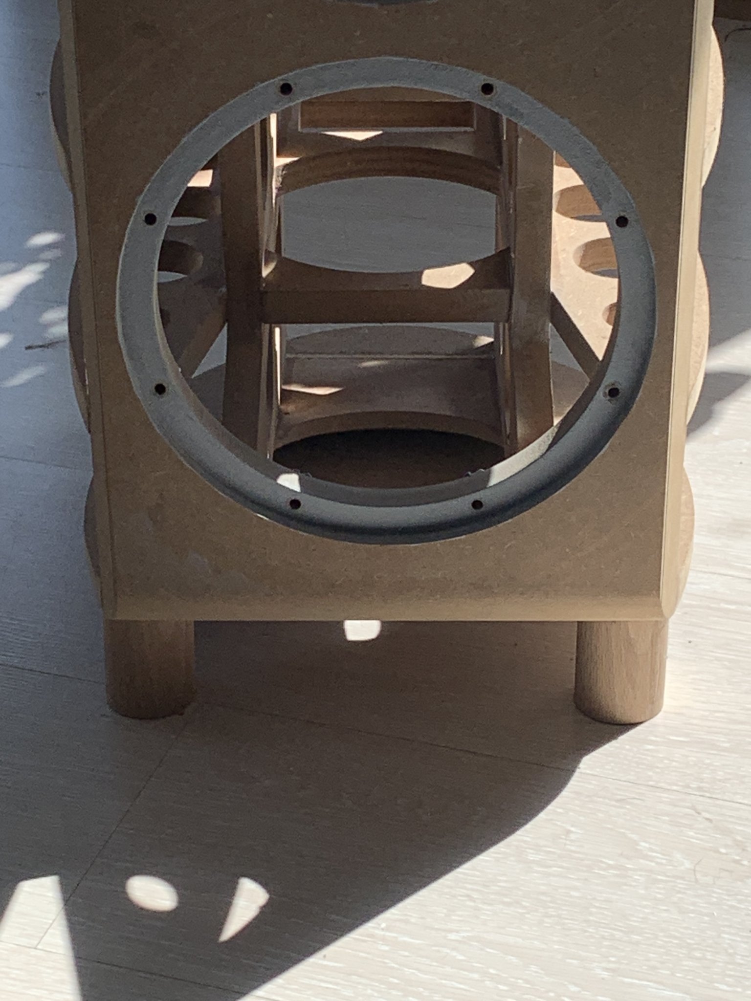

Main body

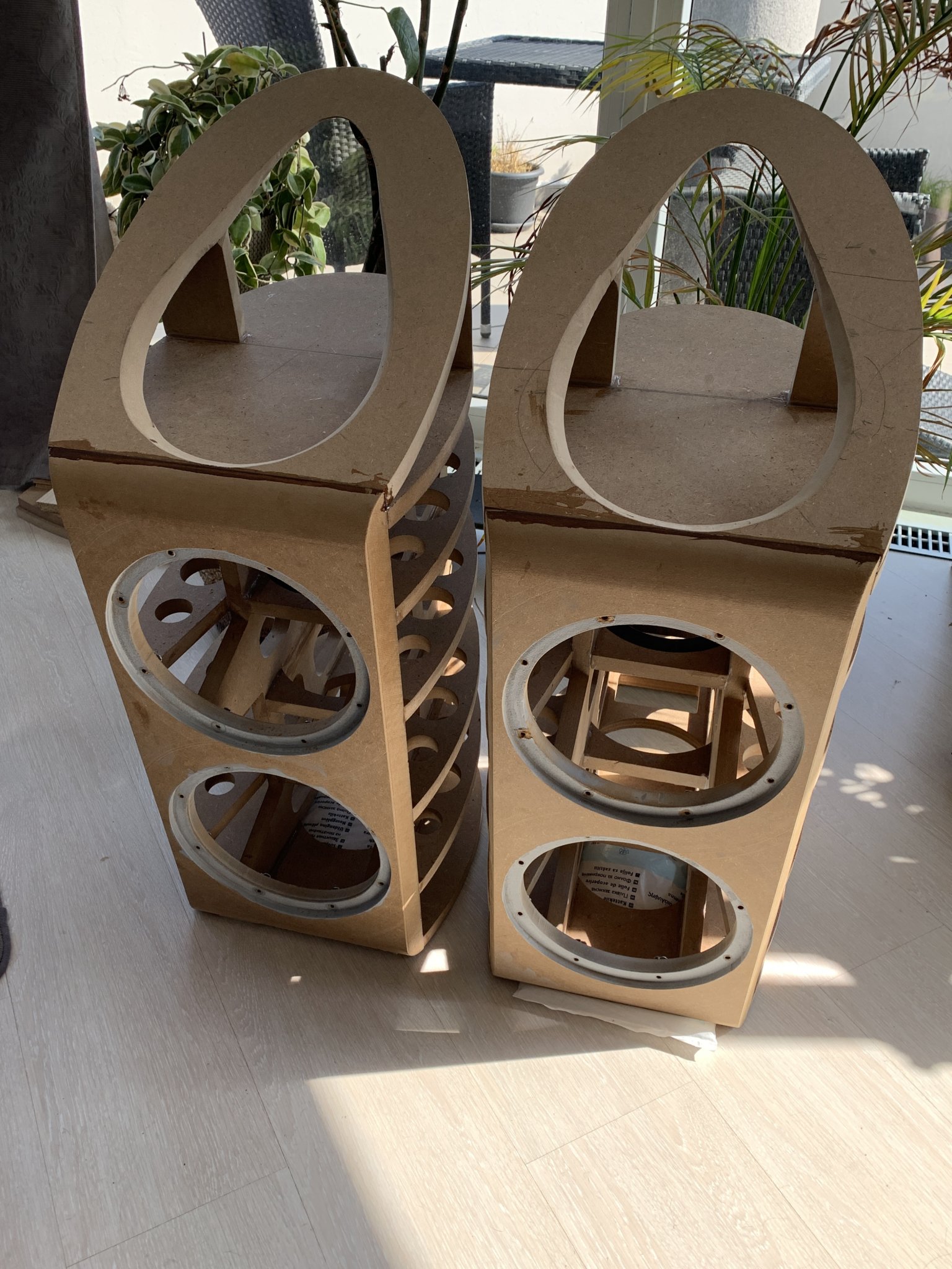

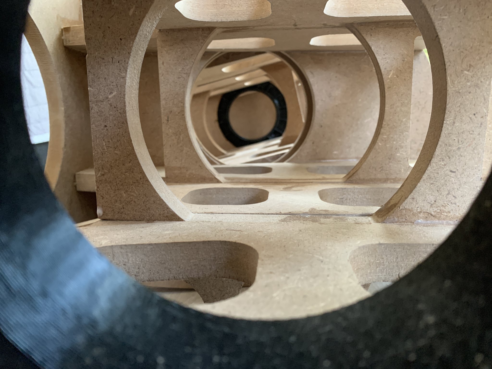

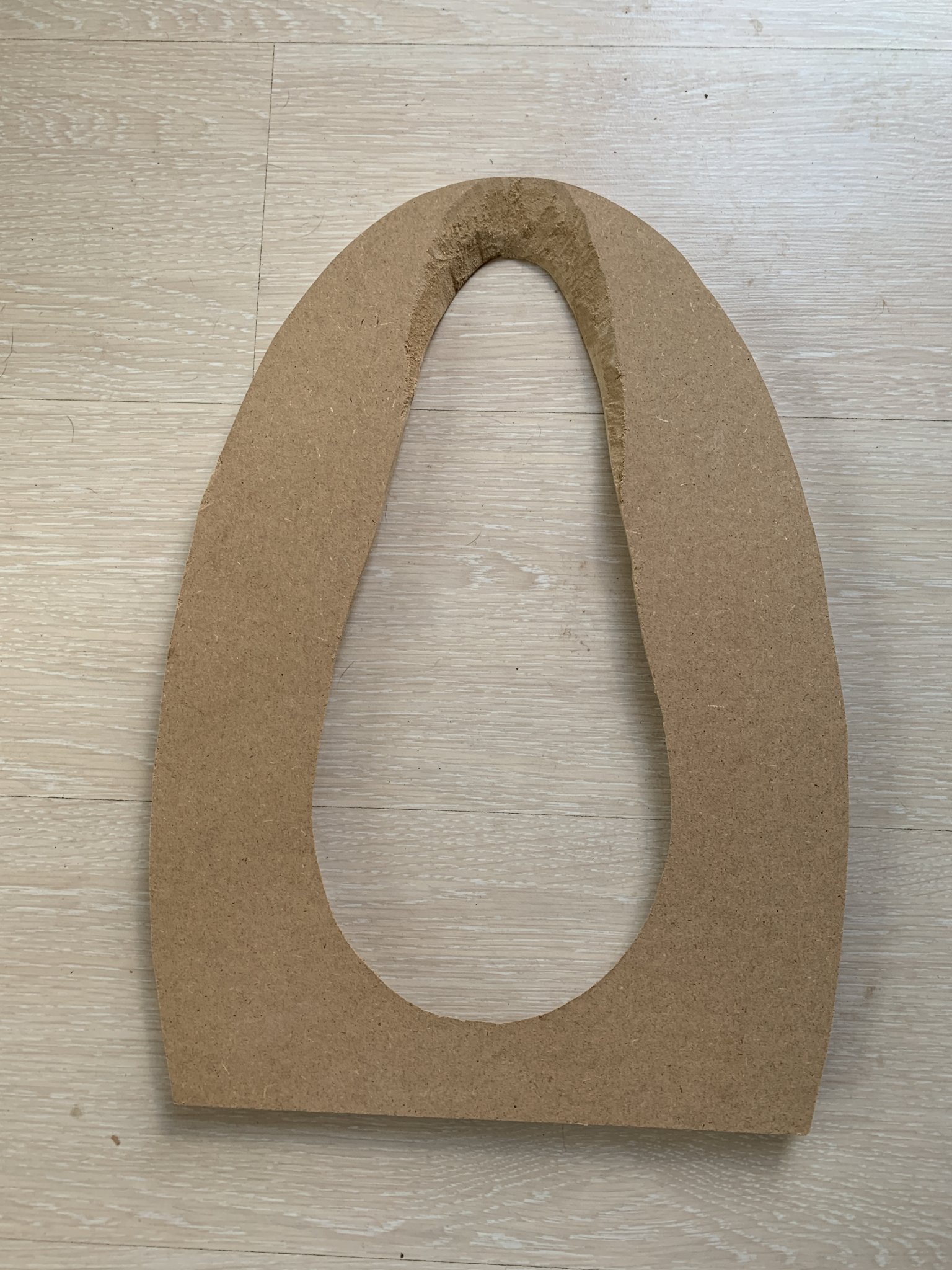

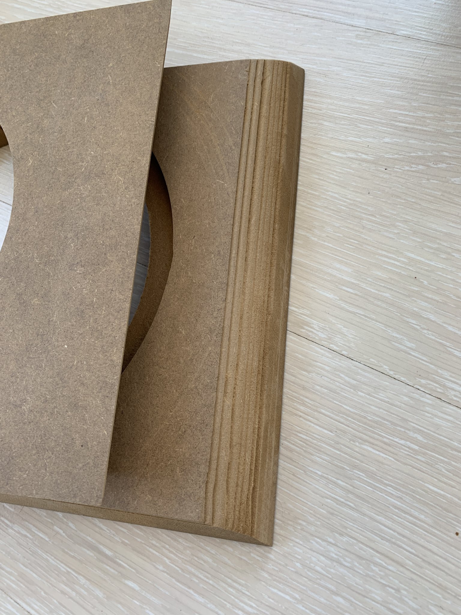

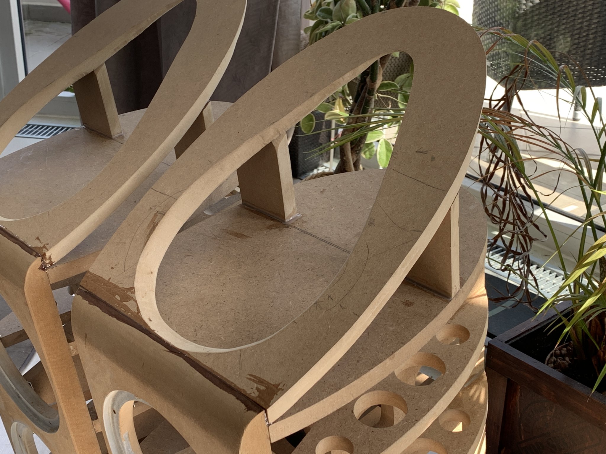

After I modeled whole speaker body in blender I started to export particular parts into autocad to prepare shapes to be cnc cut from mdf. I wanted all internal matrix parts to be cnced because of consistency which would be impossible to be done by hand. Honestly, it was extremely difficult to find company for this small task, I was searching for a month and some not even responded to my emails, some after second mail stopped communication :( terrible. After long search I found some young guys doing something compeltely different than wood but they had cnc and helped me, maybe a luck but finaly I got my parts:

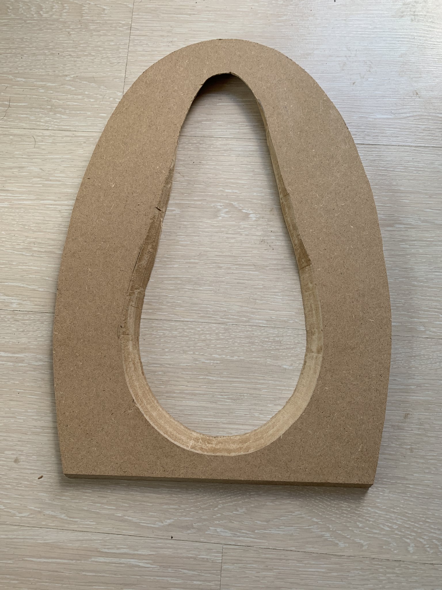

only the matrix parts are CNCed, I did front baffle by myself with mill as well as some other pieces to safe time and money. One particular tricky piece was doing big radiuses on top and bottom edge of the front baffle. So I did some calculations and milled steps to get the rough radius, looked like this:
so i could smooth out and respect the radius I have made radius sanding tool out of cut piece of PVC pipe:
the result using this custom tool:
bottom radius is smaller ~30mm as there is wall continuing by 10° angle and top bigger radius is ~40mm to smoothly continue on 25° top wall.

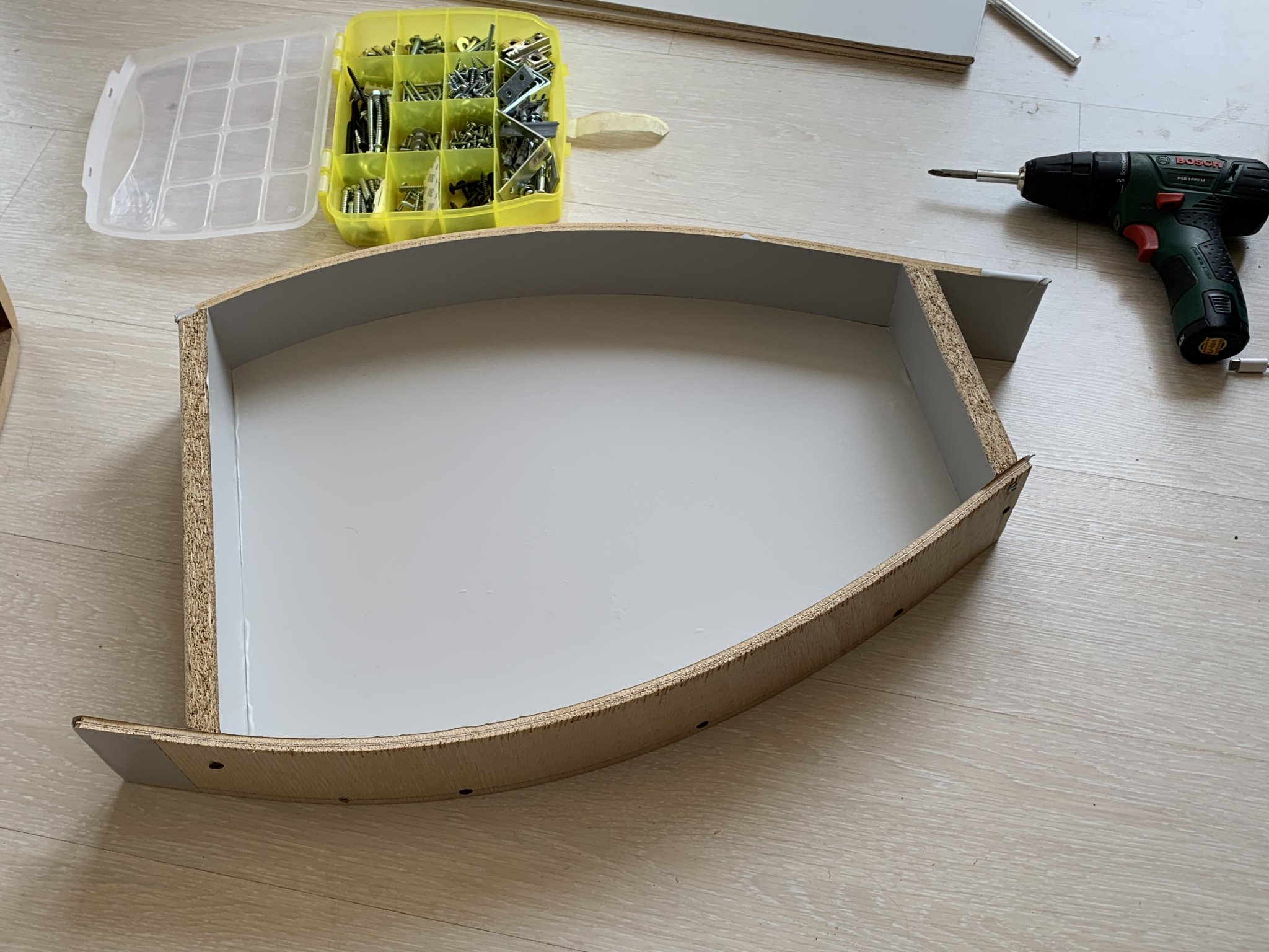

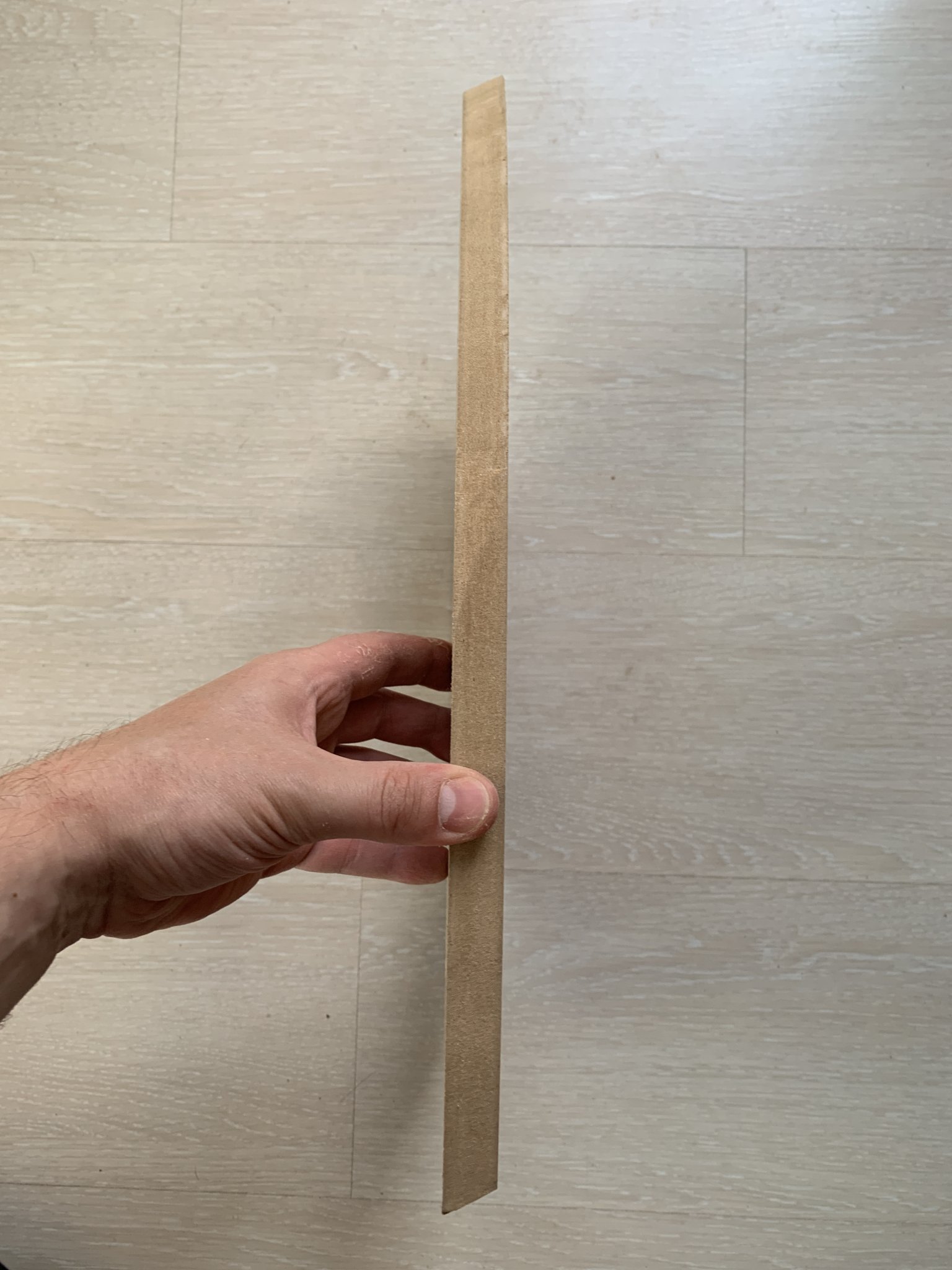

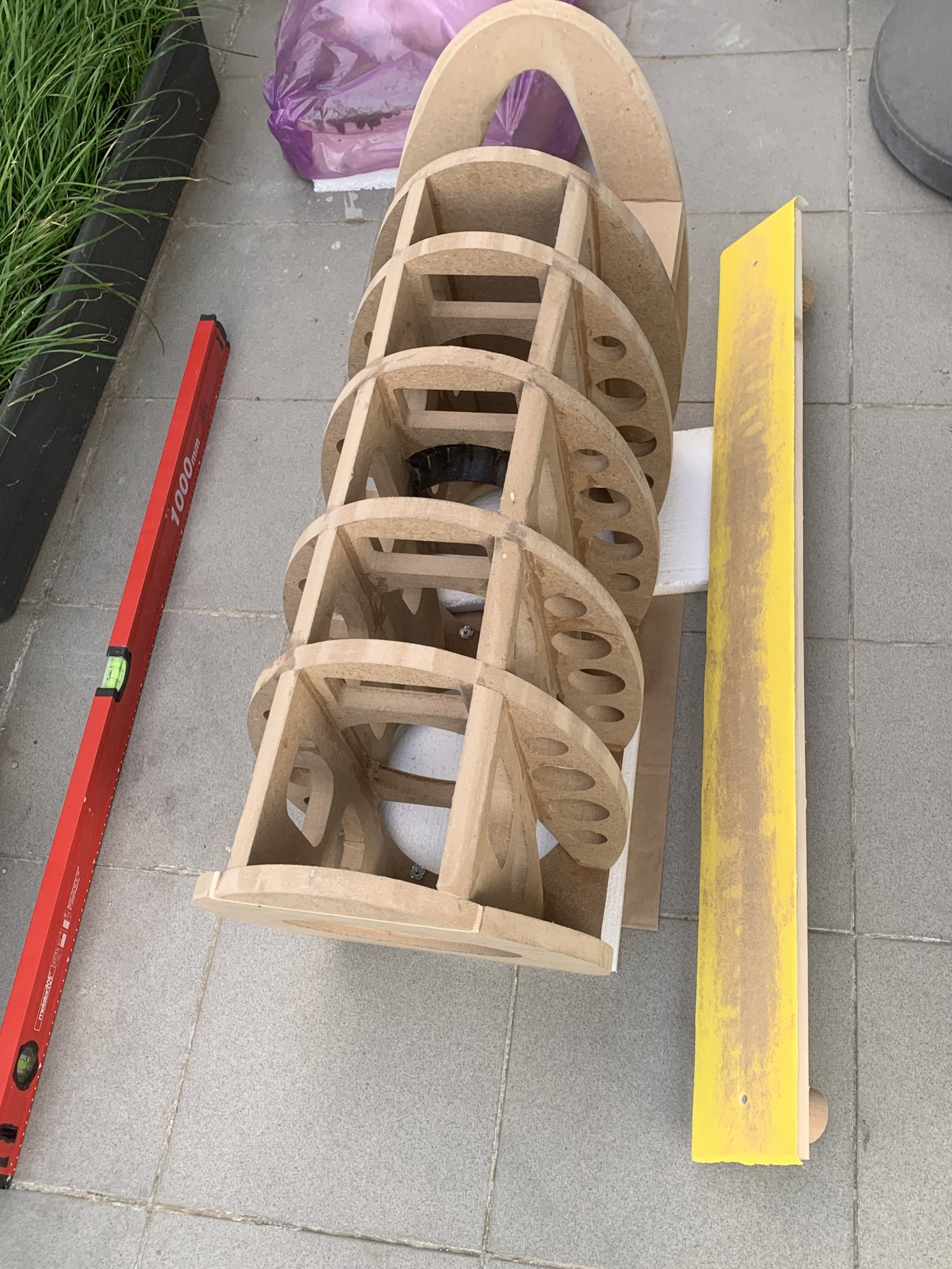

After I had all the pieces I needed to figure out what to use for curved walls. I've found out, there is a thing called flexible ceiba plywood so i have order a few sheets 8mm thick and let them cut to size. I was a bit worried by how flexible it is but oh my... it is wobbly and bendy!
some matrix putting together:
To make box "standing" at least on a piece of flat part I did small ending at the back flat where the screw holder will go:
more sanding and connecting radiuses:

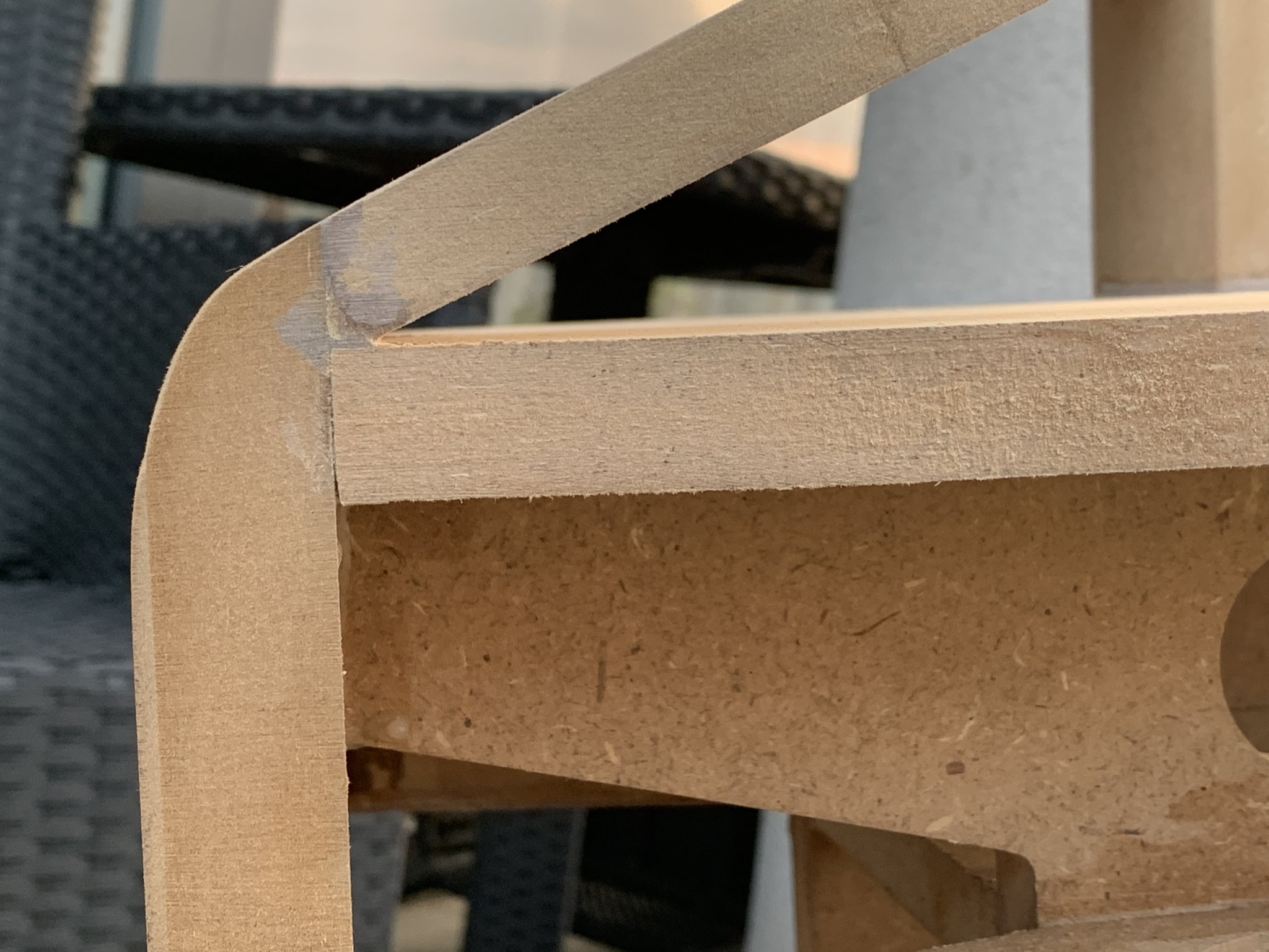

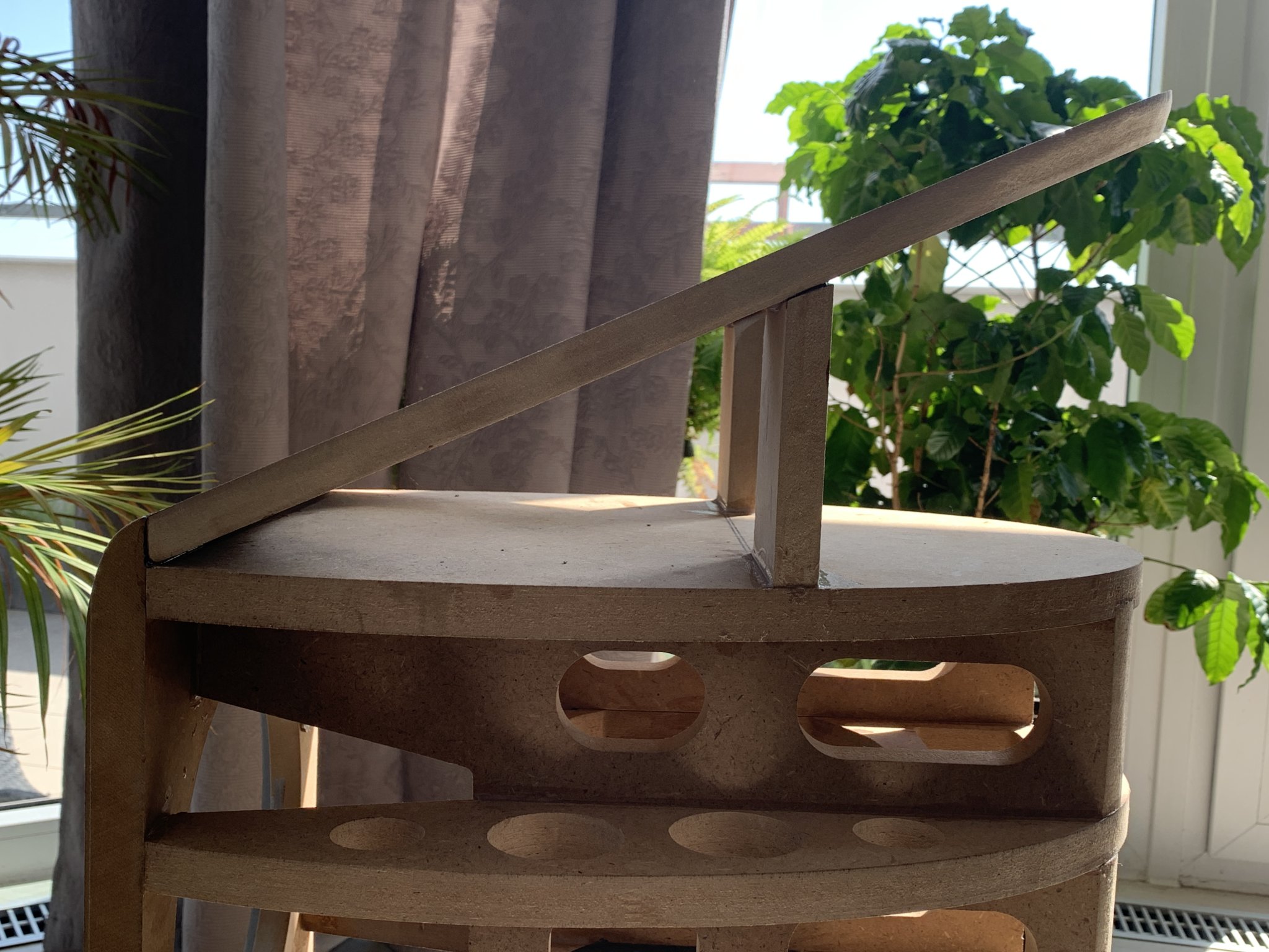

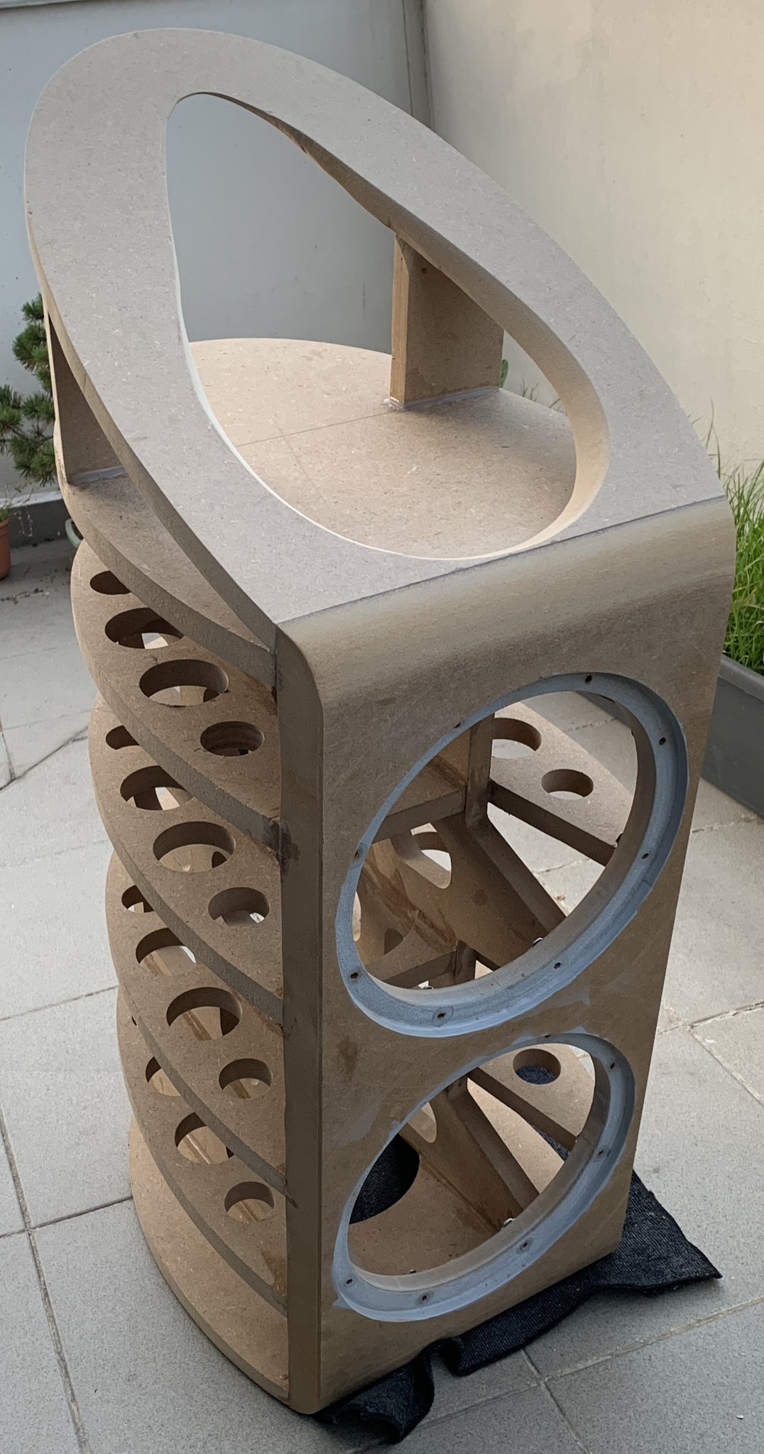

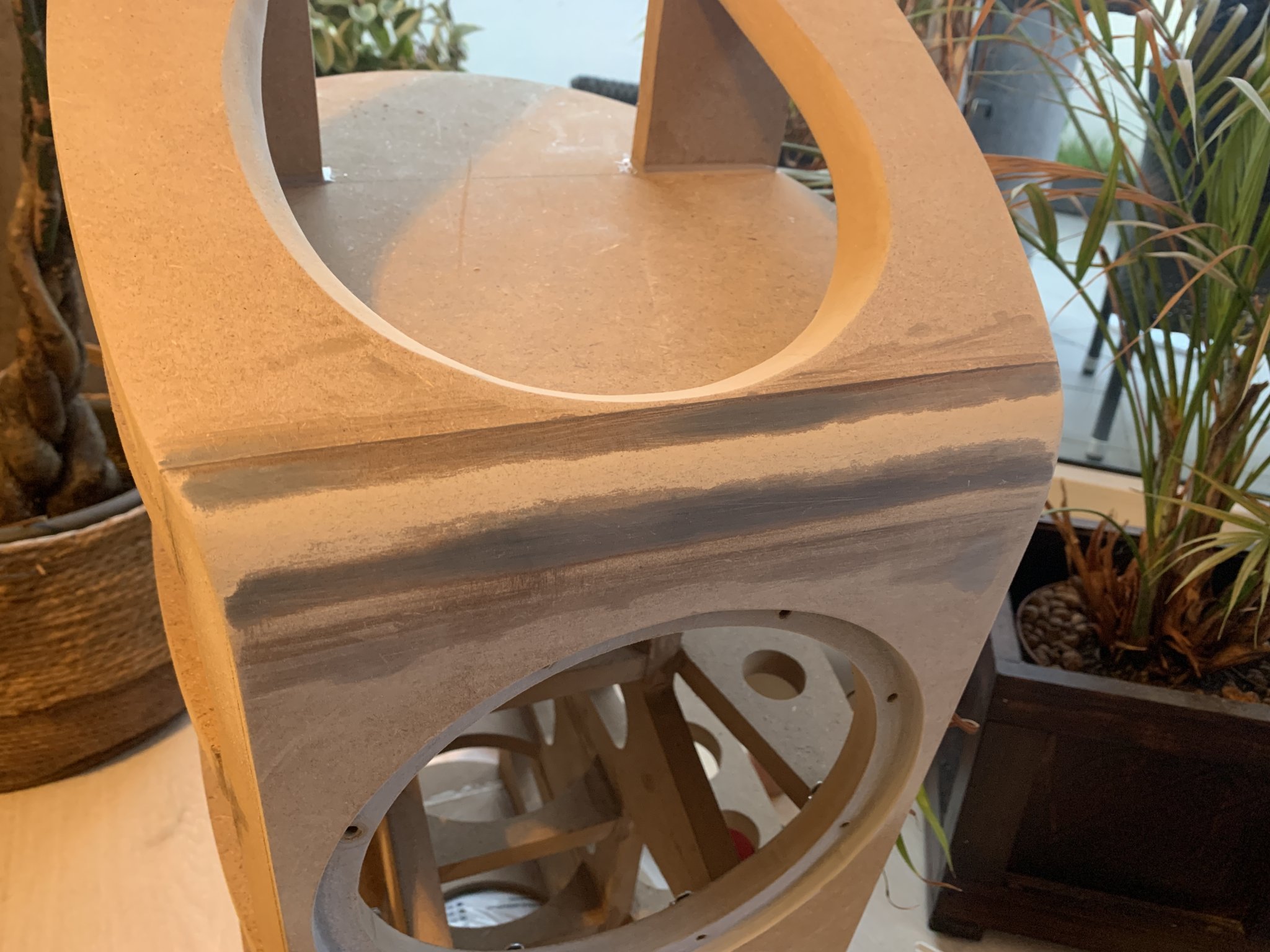

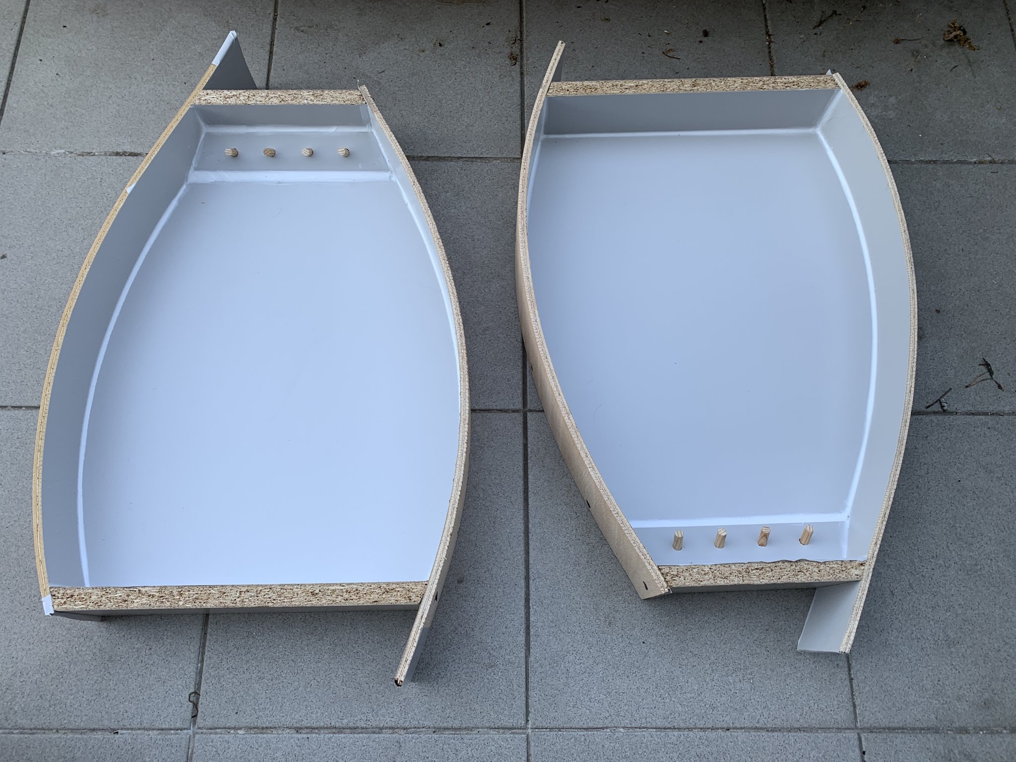

More cabinet building... teardrop seat was the most difficult part to make, I felt like sculpture artist :D the problem is its curved and also gradually increasing cut angle - insane :spin: I did print template and somehow did it by hand but I think I should have make this piece by cnc also :( a lot of sanding was required...

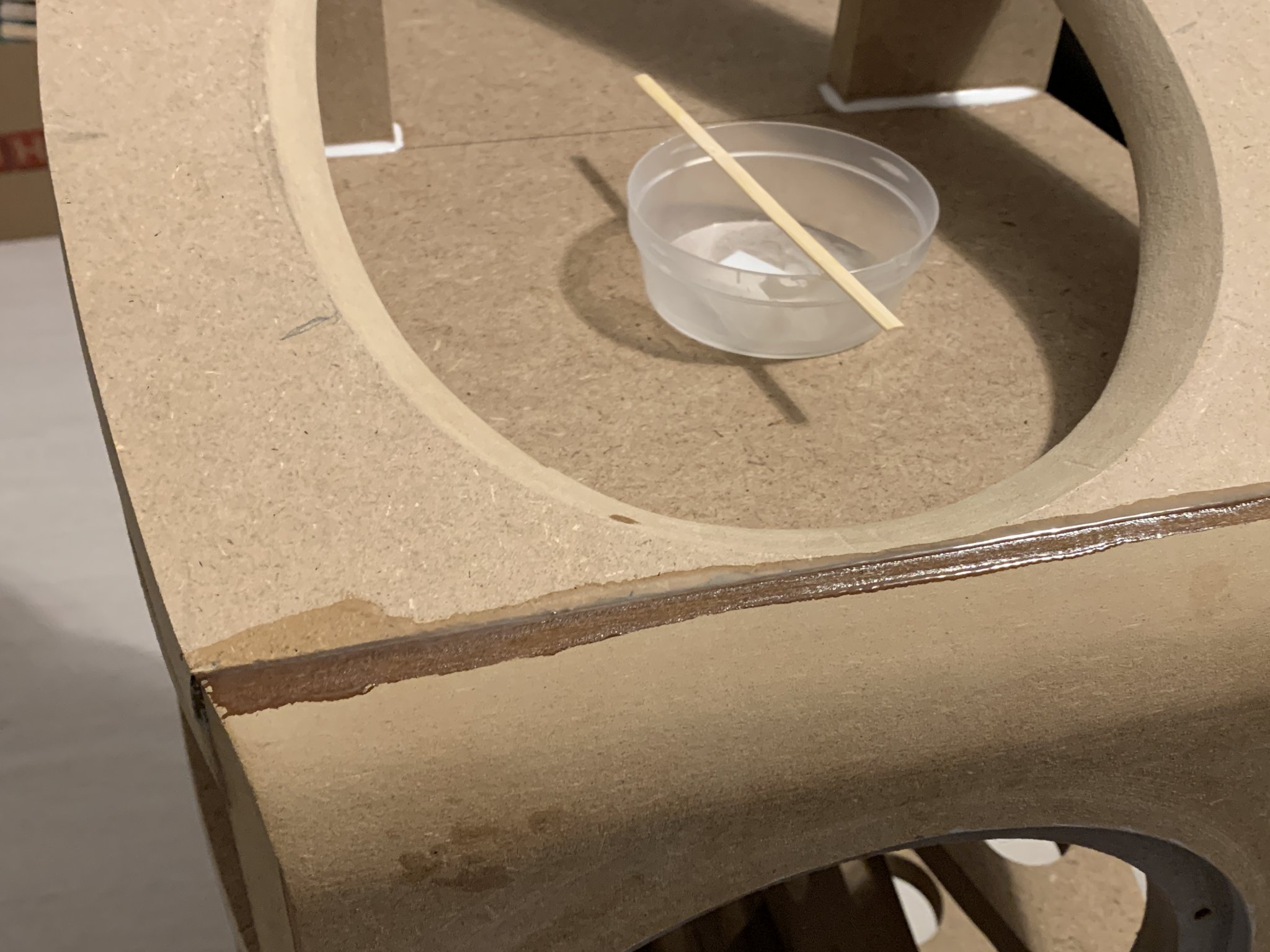

more glueing... as it didn't fit the front baffle very precisely and there was slight mismatch with angles (±1 degree) I used epoxy to glue this top piece

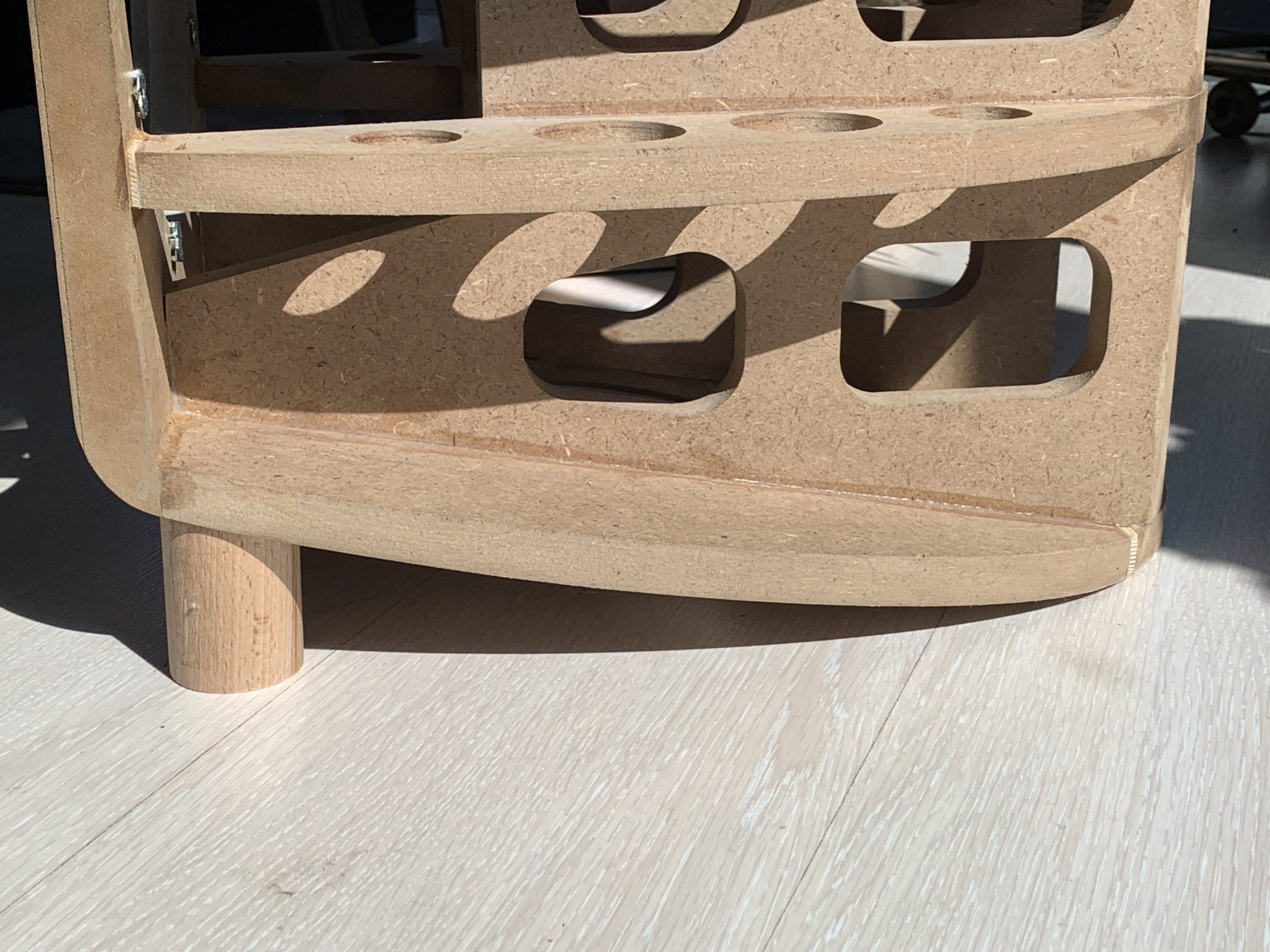

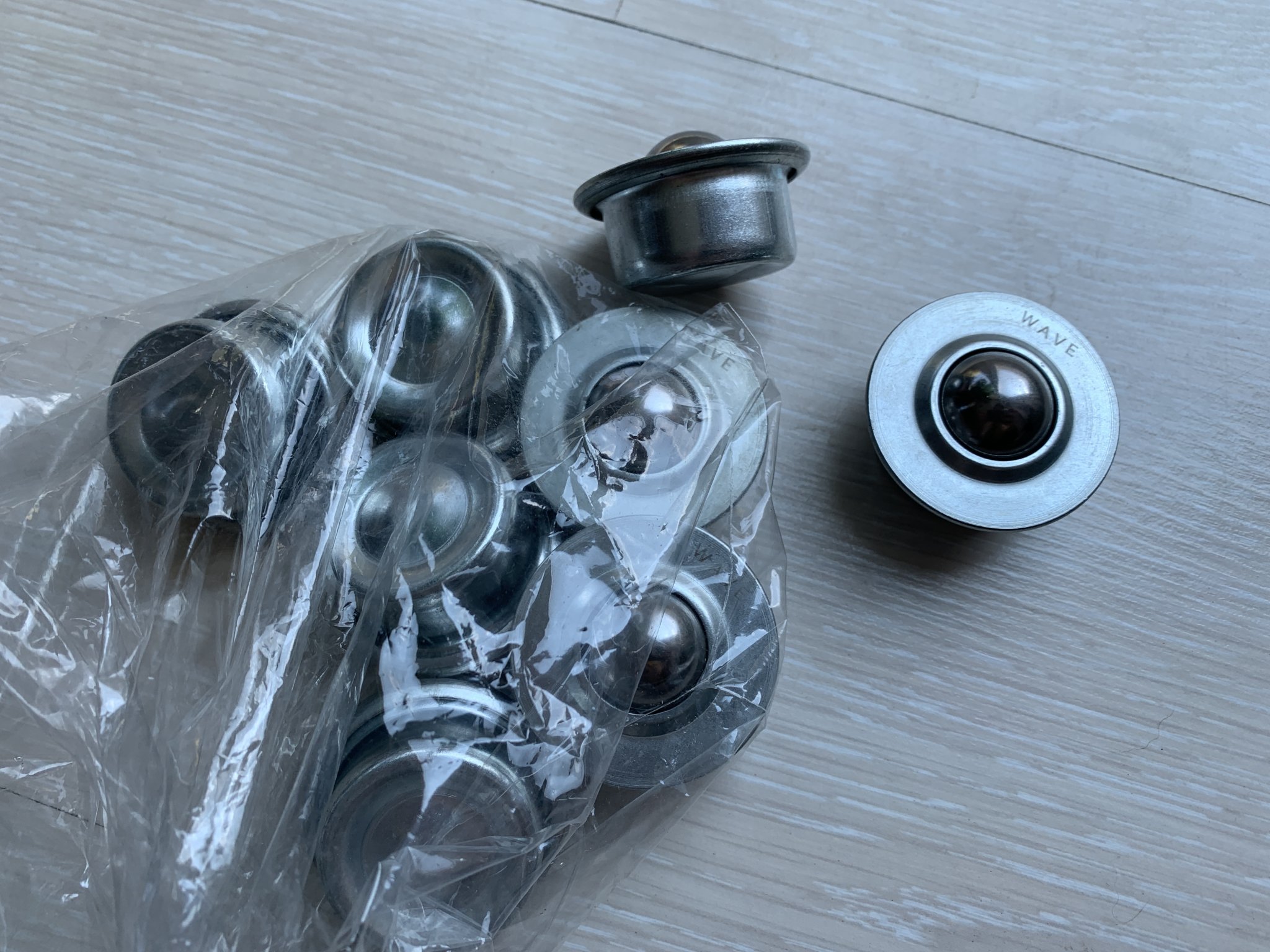

side view + trying feets

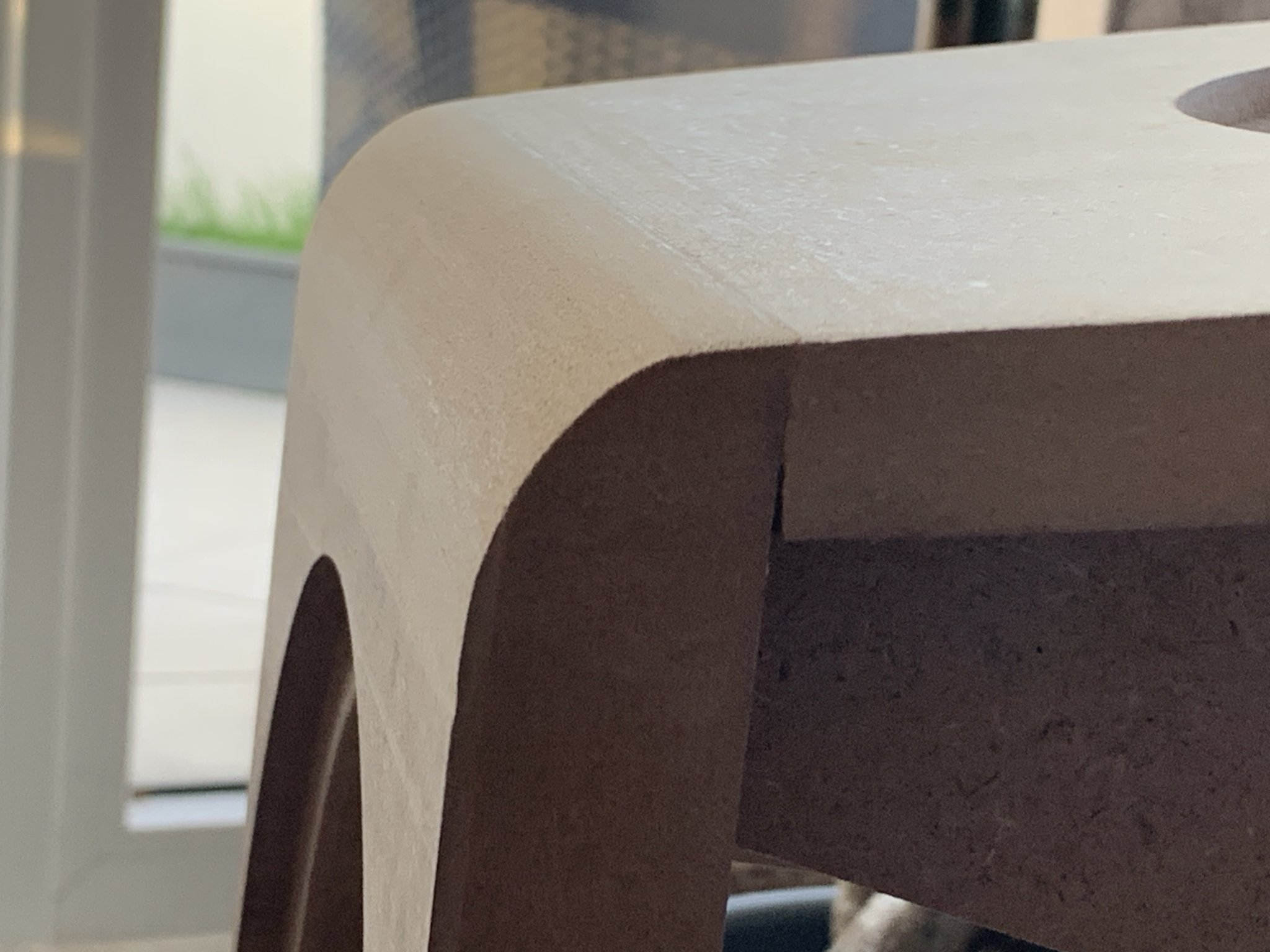

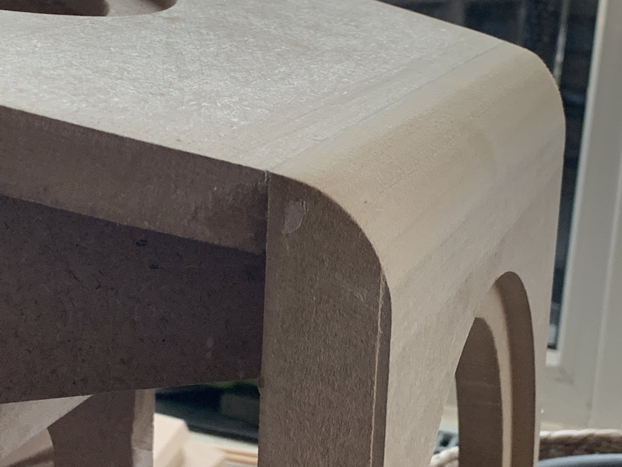

Sanding of connecion to make it super smooth:
Transition was not very straight as I would like to, you cannot see that from images maybe but there were slight dents after sand proces so I used poly filler to fix the issue:

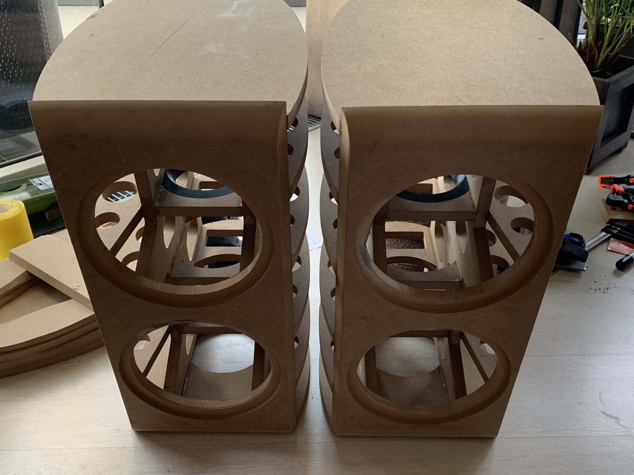

Cabinets were somehow prepared for the back walls. However to have perfect fit I leveled all the "fins" of matrix with big sanding tool I made = glued 60grit to 1m long wooden desk and sanded surrounding:
thats it about the box for now. Today I am glueing back walls so some pics of that soon. However before that I will write more about teardrop finish when will have time, maybe this evening.

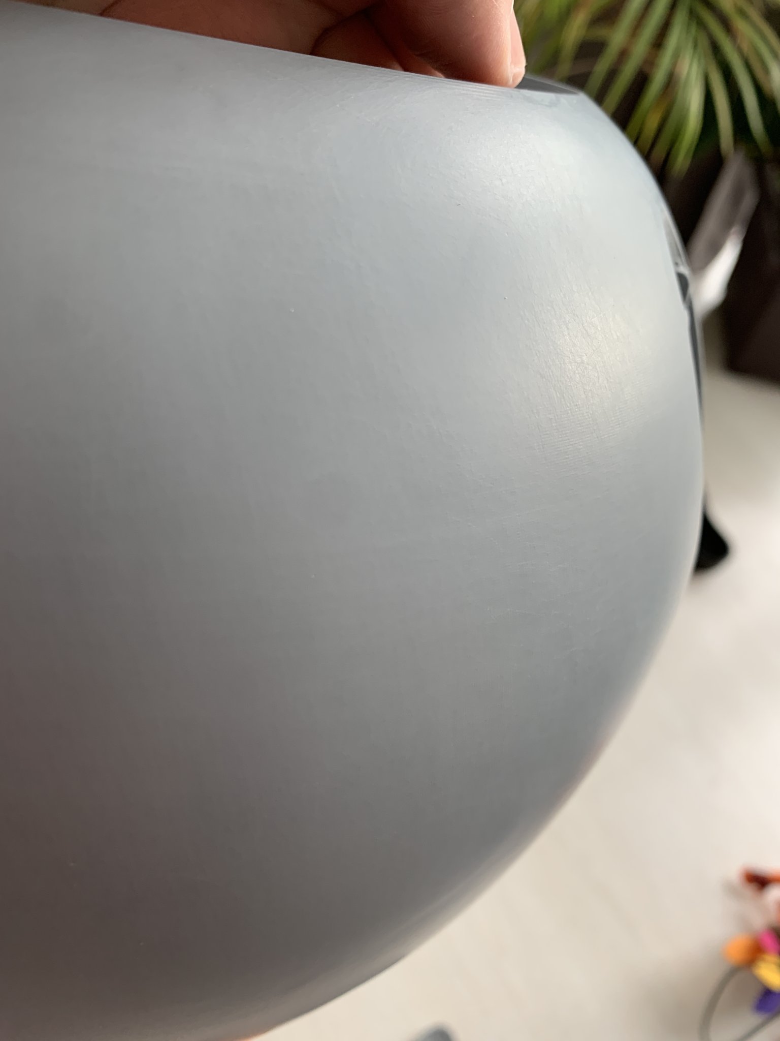

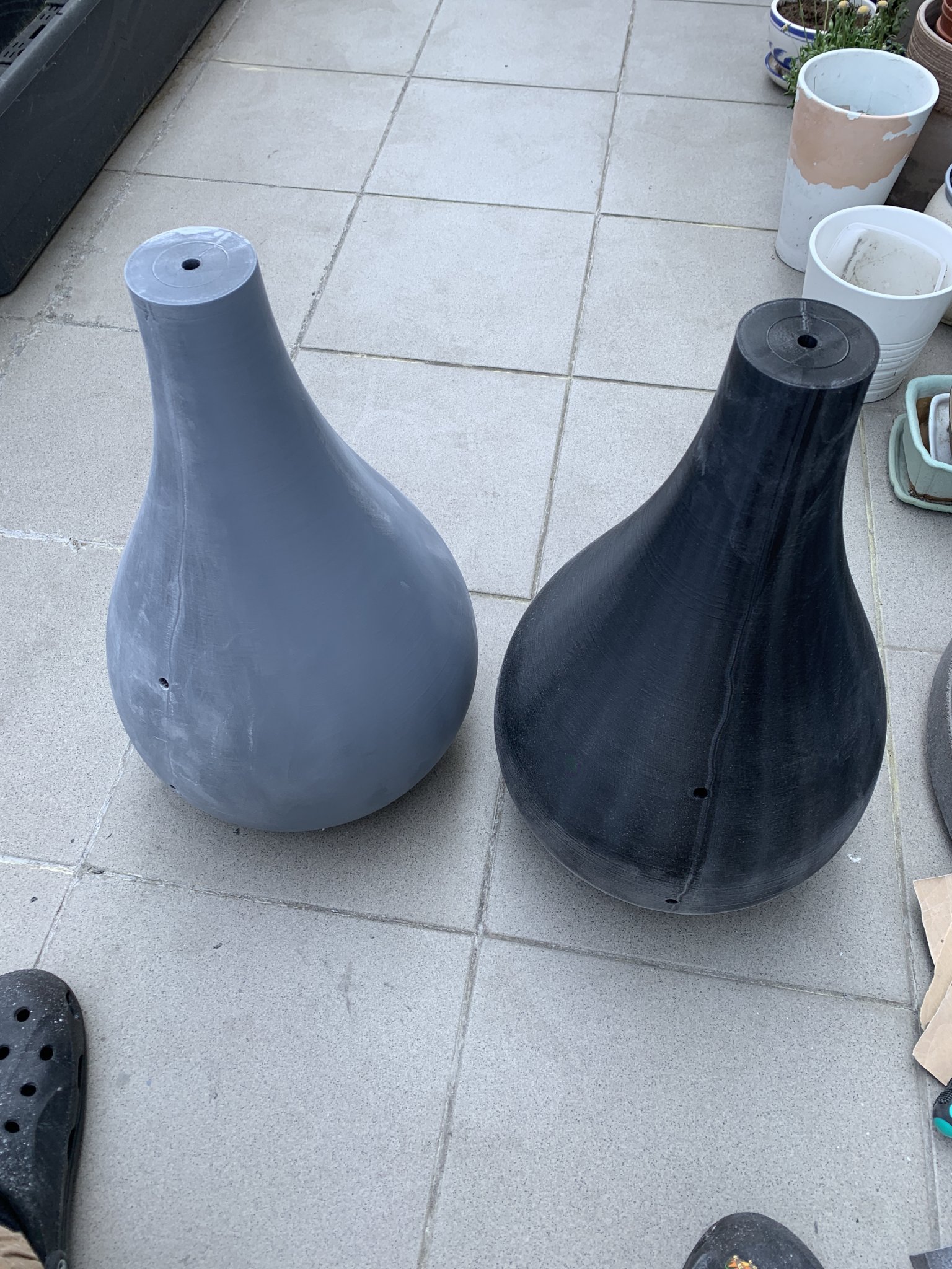

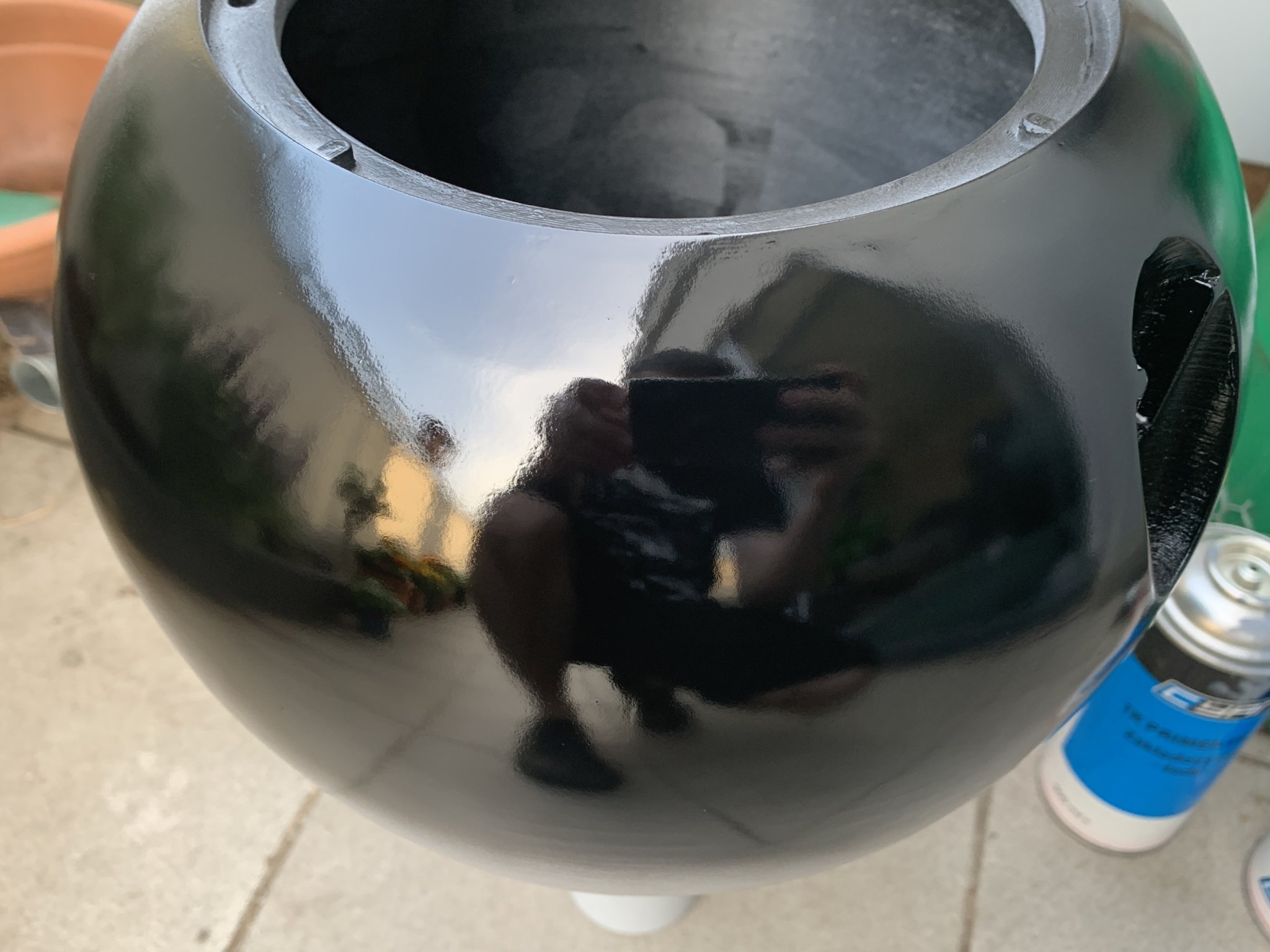

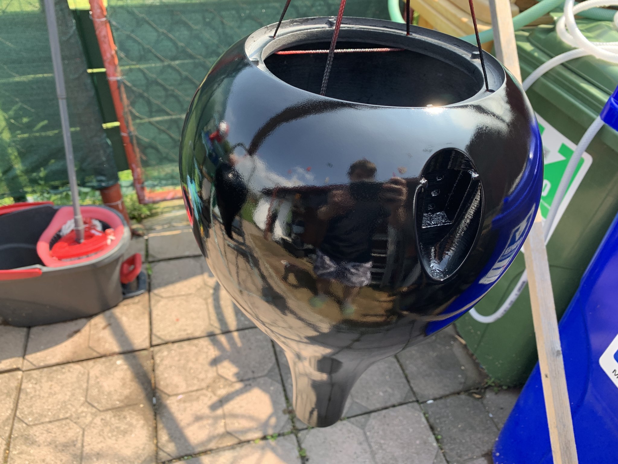

Continuing with the teardrop finish... so I ended with very smooth primer surface after about 5 coats sanded under water by 320grit. it was very very smooth :) well still some details here and there I will not lie, but overall looked very nice if I realise where I started :D
I used normal acrylic car spray, nothing fancy. They said to me at shop its impossible to polish it as it does not contain hardener... but well its summer and sun = hardener like hell with black paint :D and based on my previous experience I gave it a try. A first coat:
yes its simple as that :) after first two coats it was very nice, shiny but shine had orange distortion as usual with this process:
so I sanded it whole once again with 2000 grit and applied third coat, I thought its finished so tried some polishing. It went really well and mirror gloss was present, however very distant reflection was still muddy. I was somehow satisfied with the result:
however an accident happened and teardrops fell on ground when they were resting. I was very disappointed to start it all over again and wanted to do some local repair, however it was visible where repainted. So I took a few steps back and smoothed out all over again with 1000 grit. This step back helped very much btw! I applied next thick coat, it was total 4th and that was the best and final one. So yes, good finish require many coats indeed.
I did more polishing starting with 2000/3000 grit paper under water, after that medium paste, continued by fine polishing paste and finished it with carnauba wax. The result looks like this:

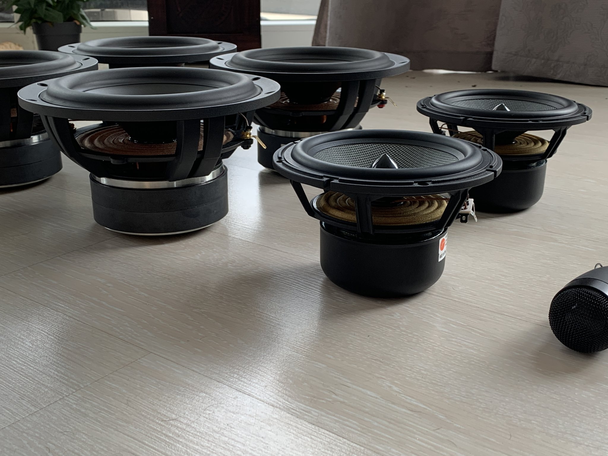

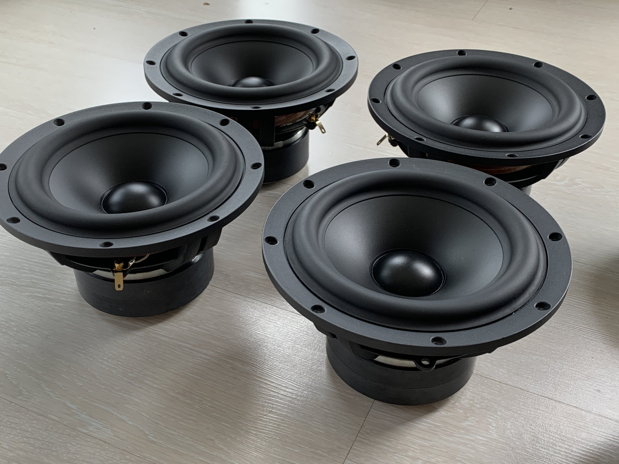

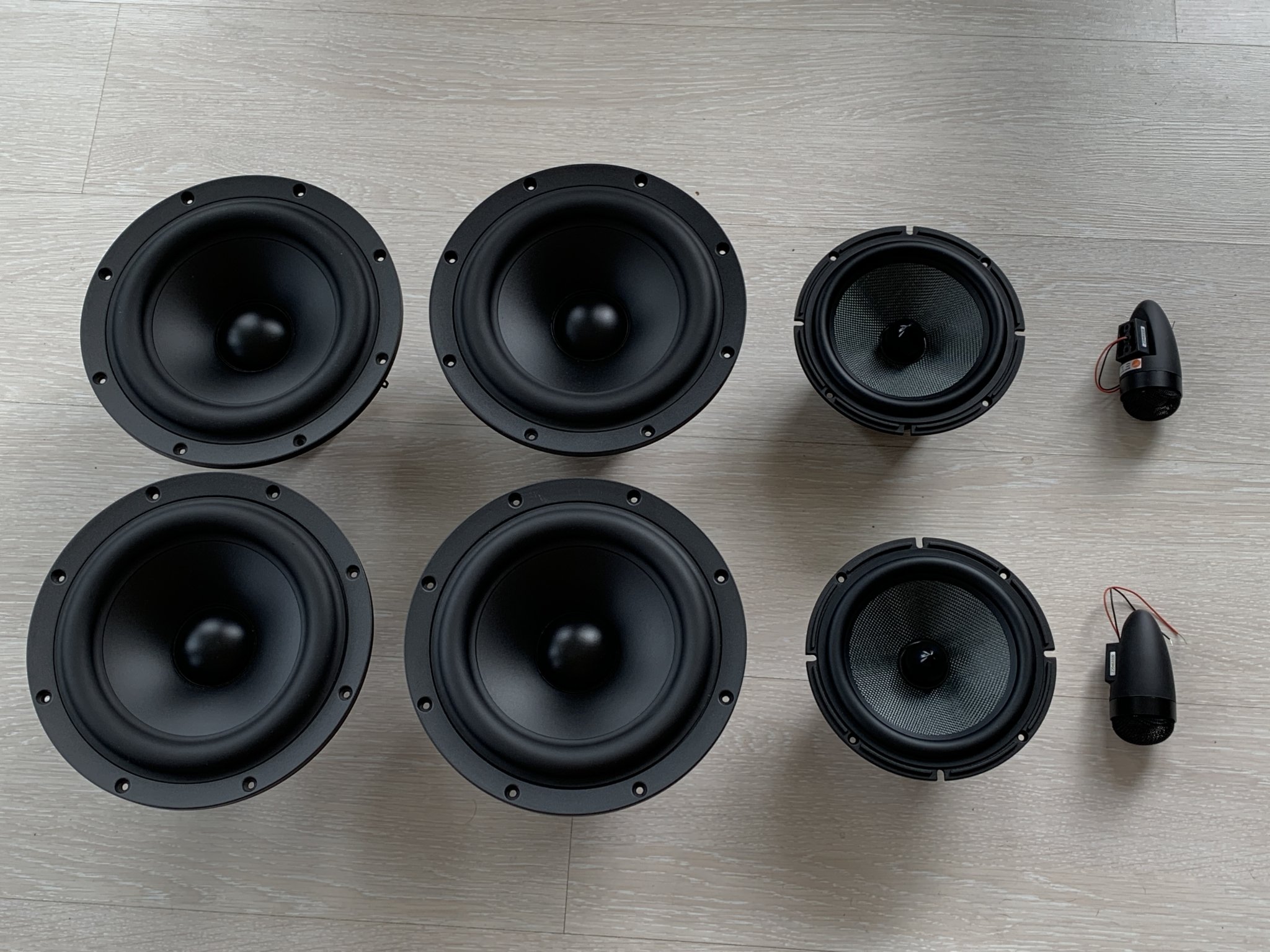

Which transducers will you be using for your project ?
good question, combination of mid to low-end is probably the right answer :D but seriously I don't want to invest too much into expensive drivers I will not benefit from. I simply do not hear difference between 100 and 1000e speakers and I do not listen on big ones very often. I do the build because the process is fun and what entertains me, not the final product, thats just cherry on top :)
For lows I am going to use 2x SB23MFCL45 (goes nice and low in small volume)
For mids HiVi L6 (looks like no serious resonances thanks to kevlar and quite nice dispersion, will see more after measurements)
For highs not sure yet, I was planning HiVi TN28 mainly because ready to use housing, but I realise the low quality of that tweeter. I have it in other boxes and sound-wise I am satisfied. But I was thinking of printing some universal holder to accommodate also usual standard dome tweeters. I was thinking about what one friend adviced - Bliesma beryllium but I am still not sure. I tihnk I will try what I have and will see... I dont like that big housing on top of teardrop, does not look nice :D

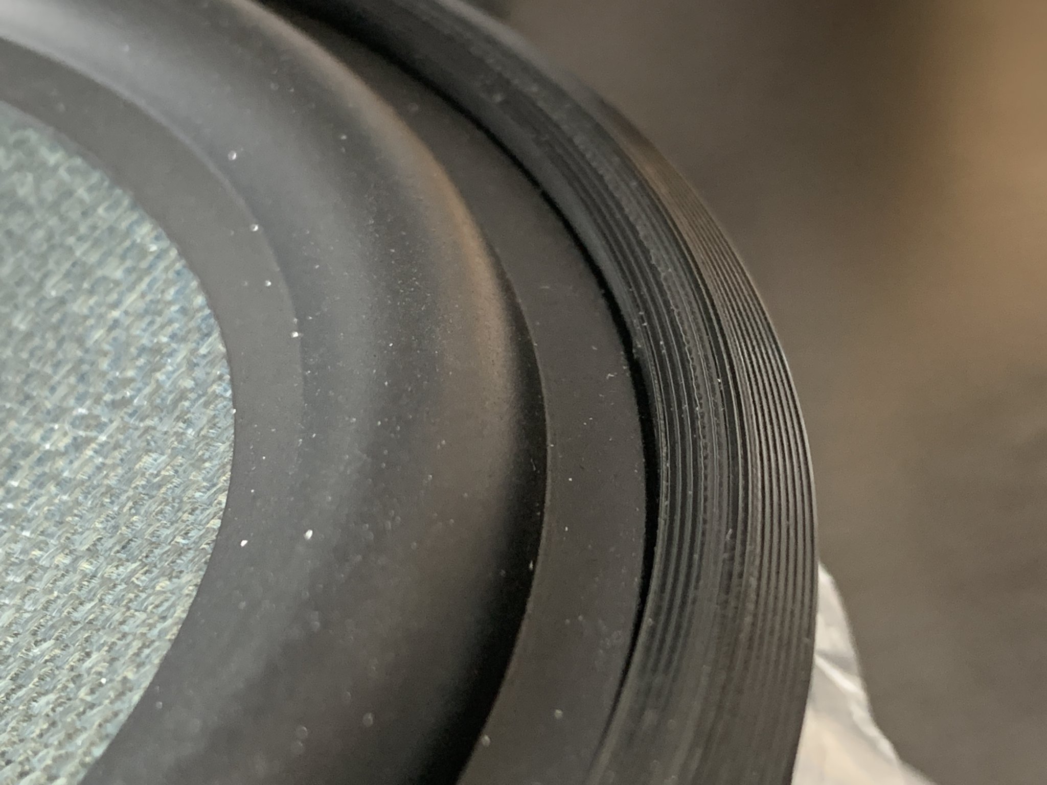

Below some driver pics. As HiVi L6 has awful rim I printed small trim piece around

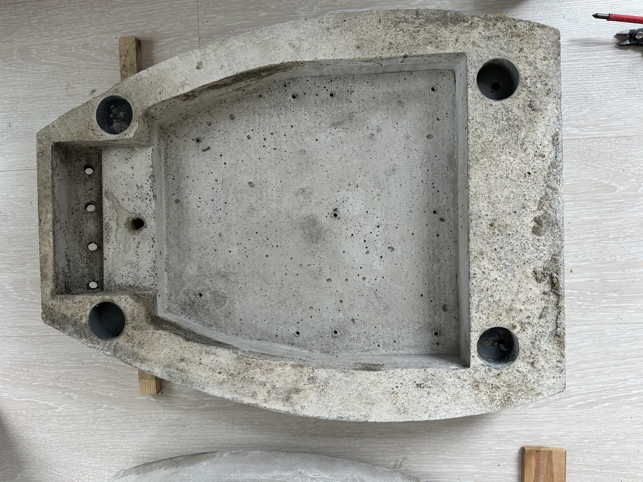

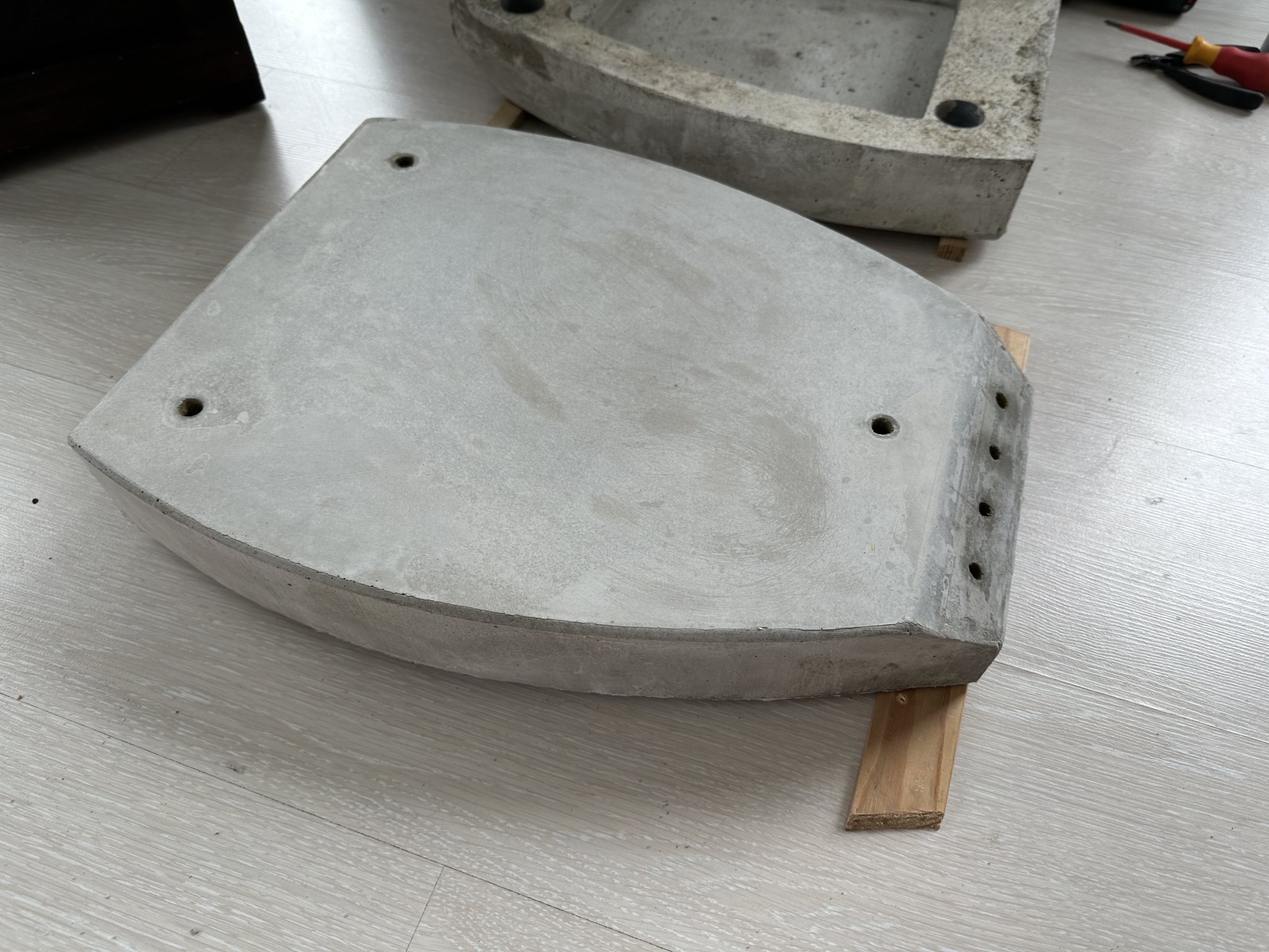

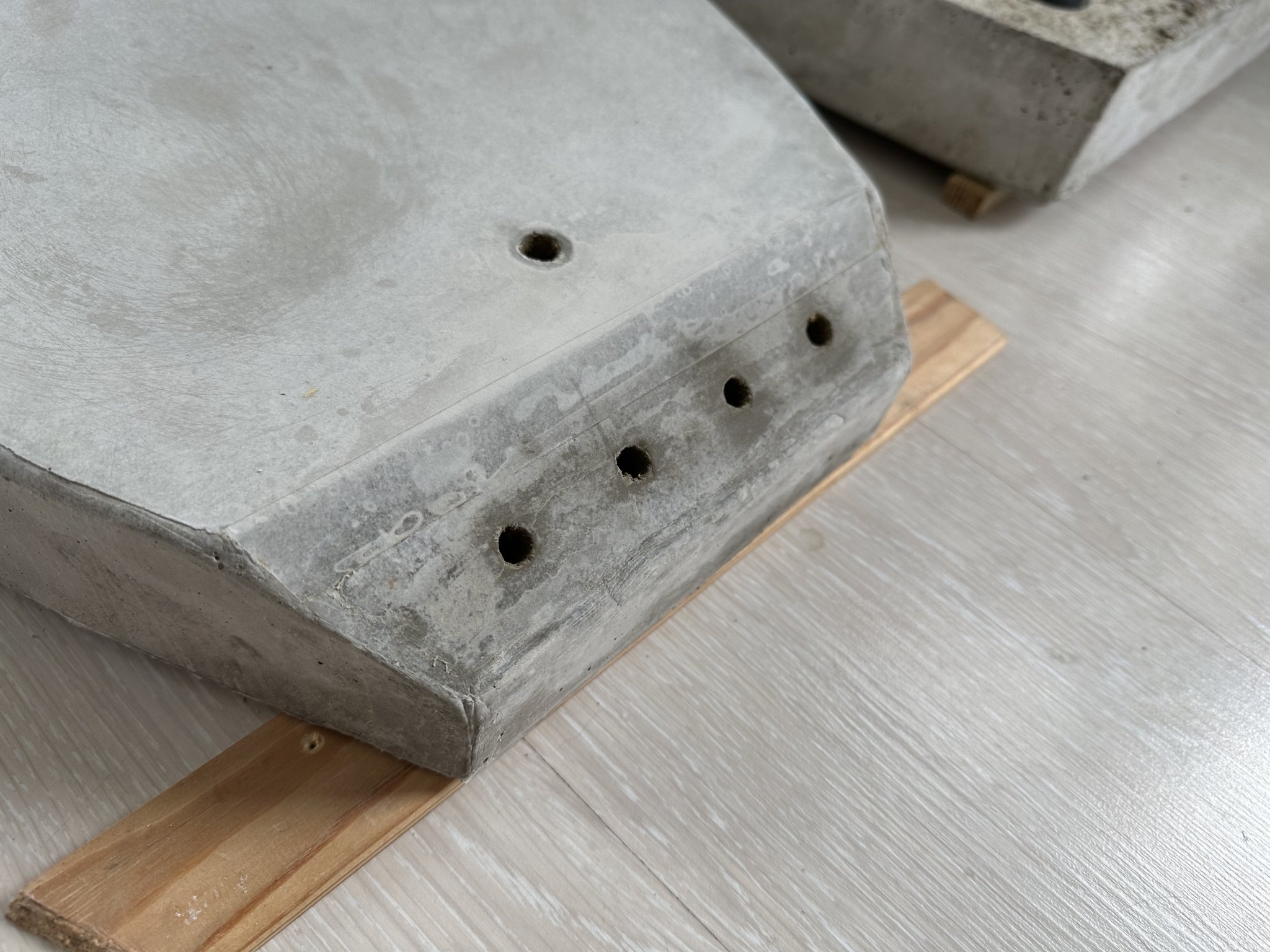

I've released plinths from the forms today, they still have to cure, but anyway more about those...

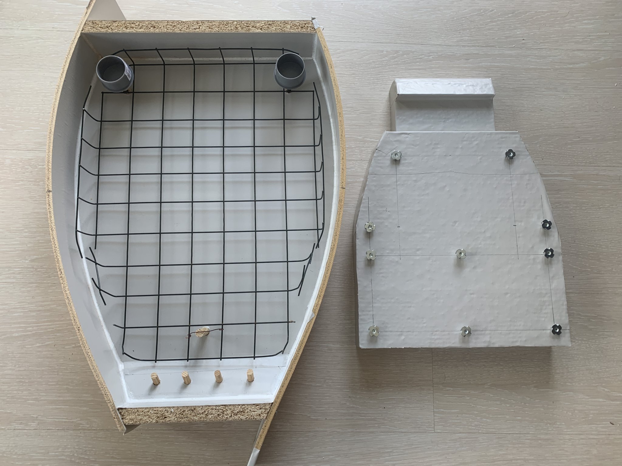

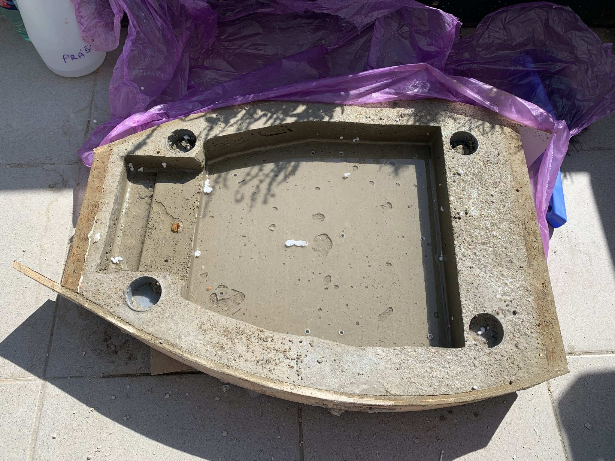

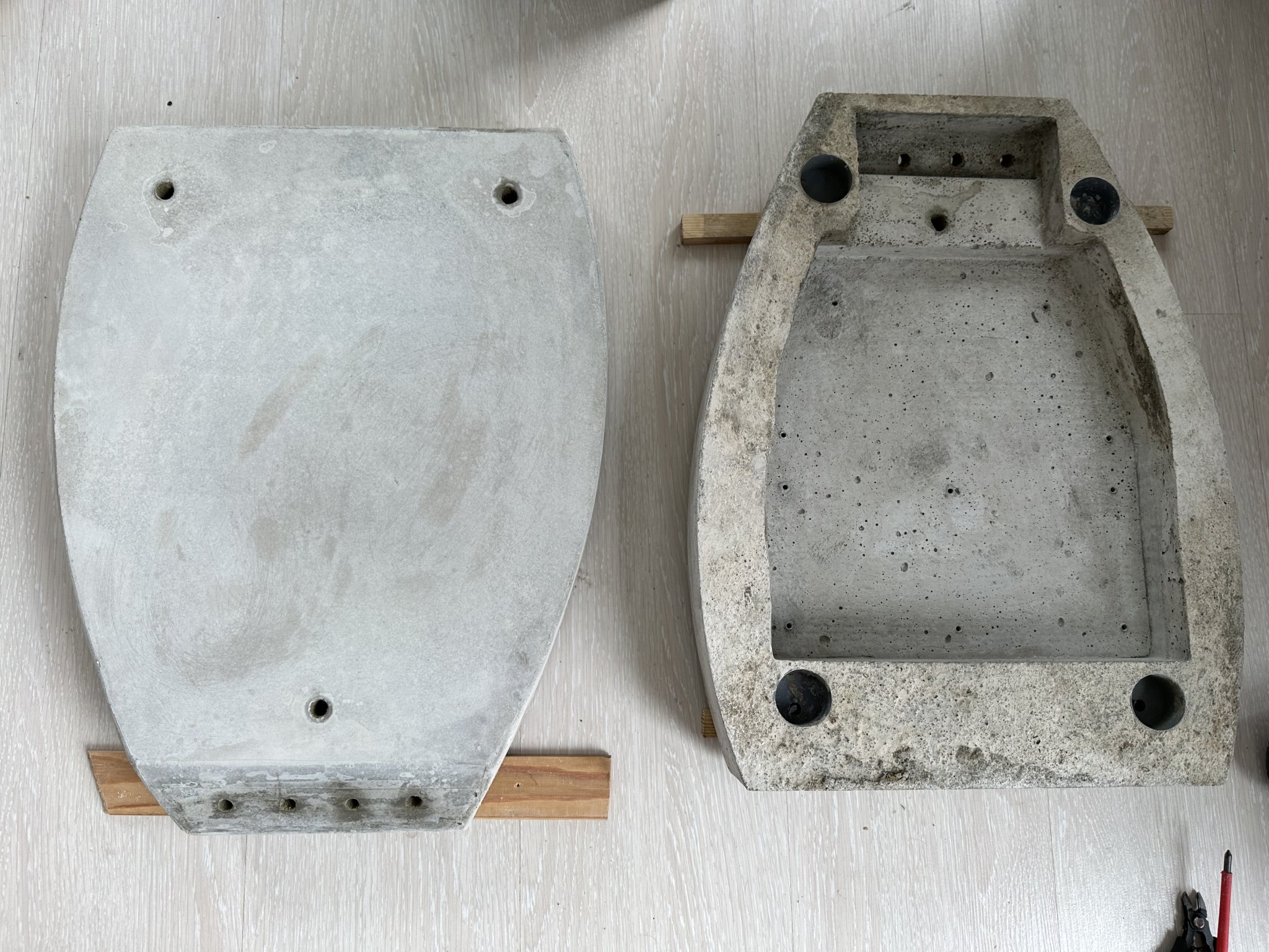

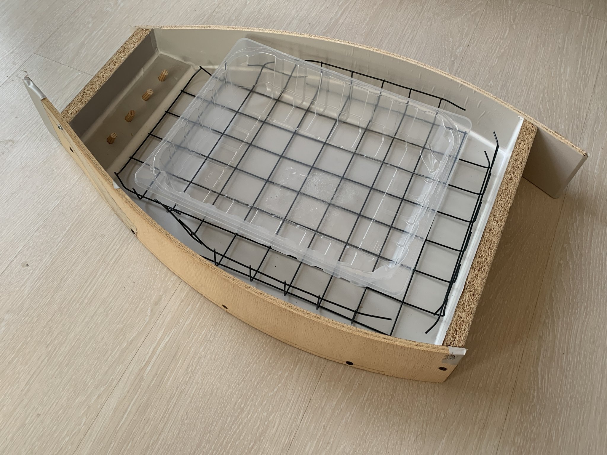

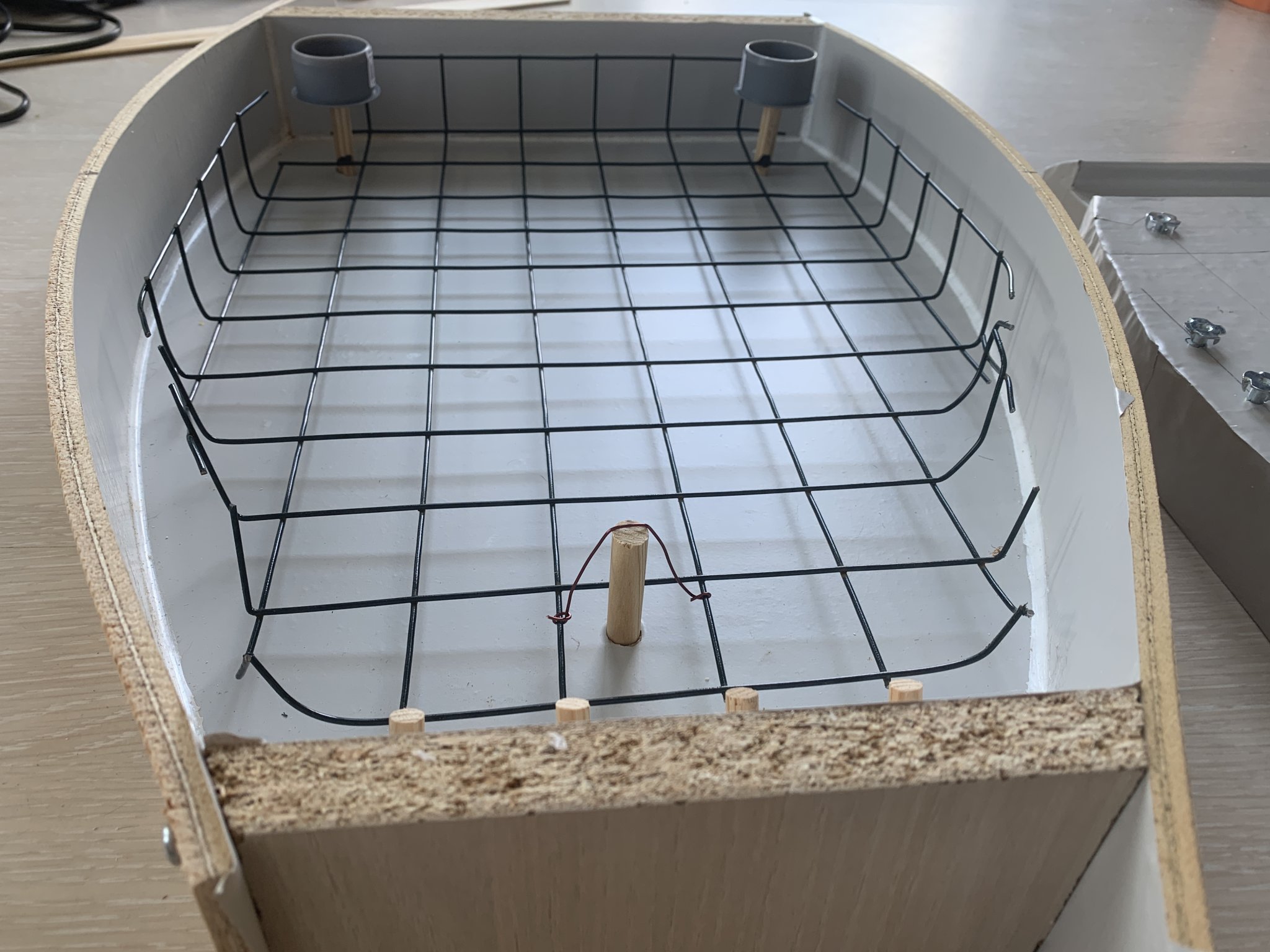

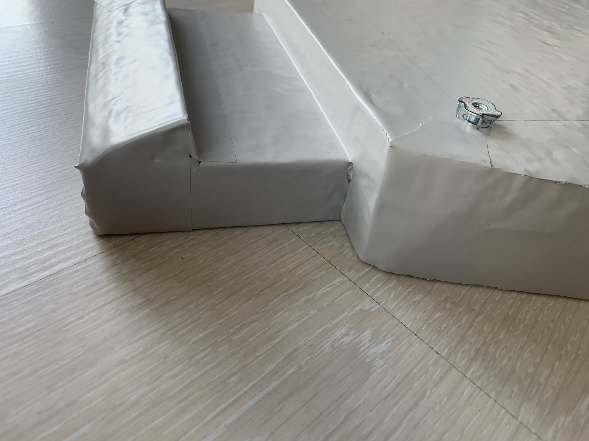

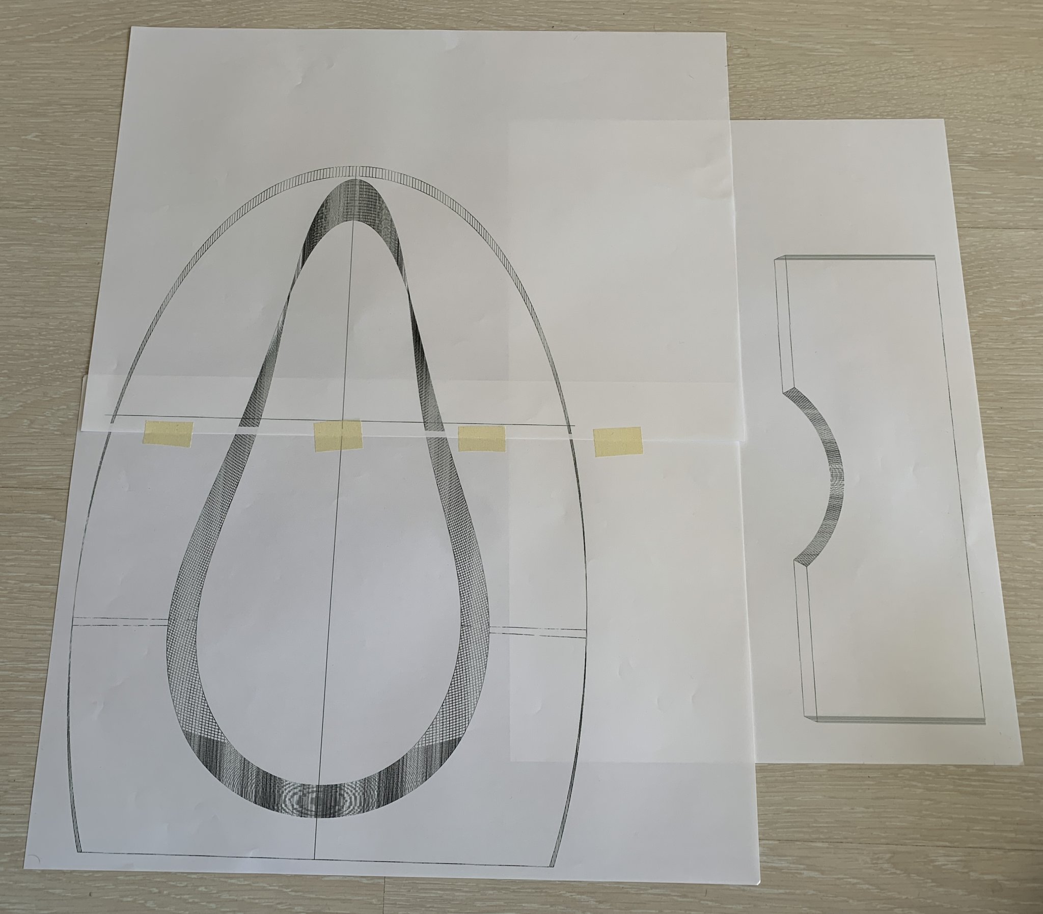

I have not yet decided what finish I'll do on cabinets but no matter the black color or lacquered wood I want industrial look of the speakers. To both of these fits the best just pure natural concrete. I have used this in my previous projects and very liked it, so it was decided. My first idea was to do just thin plinths and put crossover inside the cabinets. Due to many, mostly practical, reasons I've decided to make plinths thick and make cavity from the bottom to accommodate the crossovers.
Each plinth is approx 37x48cm and 7cm high. Walls are ~4cm thick, front to carry most of the weight is 10cm and top wall is just ~2cm. To precisely copy curve of the cabinets, the forms are cut by CNC. I made form walls from standard laminated wood + leftovers from cutting plywood. As a separator, and also to make plywood surface smooth I used cheap self-adhesive foil on all the walls. To make transition in corners soft I filled them with silicone, this helped to make it also water-tight:

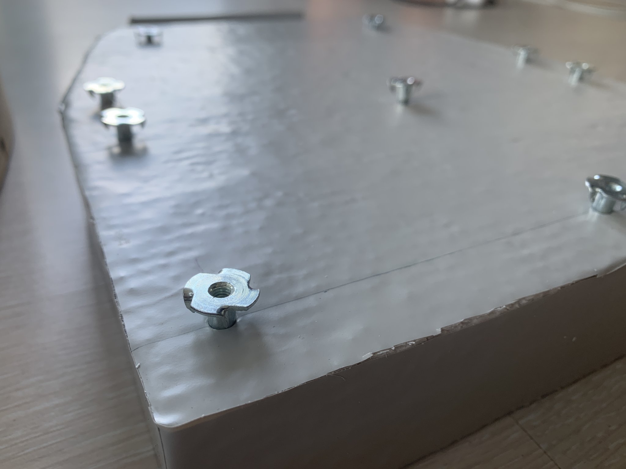

As you can see I pre-formed also all the holes needed for fastening it to the cabinet as well as the speaker terminals. My first idea how to make fancy cavity was use of plastic food containers. However I struggled quite a lot how to connect it to next parts and following cavities such as the one for binding post and back screw part. Finally to form hollow inside I used classic polystyrene 2+3cm panels in between which I put screws on strategic places to be able to fasten nuts into the concrete to make holders for PCBs of crossovers:
To make parallel cavity for binding posts I did special cutouts and also "raised" part within cavity so screw holding cabinet has more rigidity and there is still channel to carry wires around:

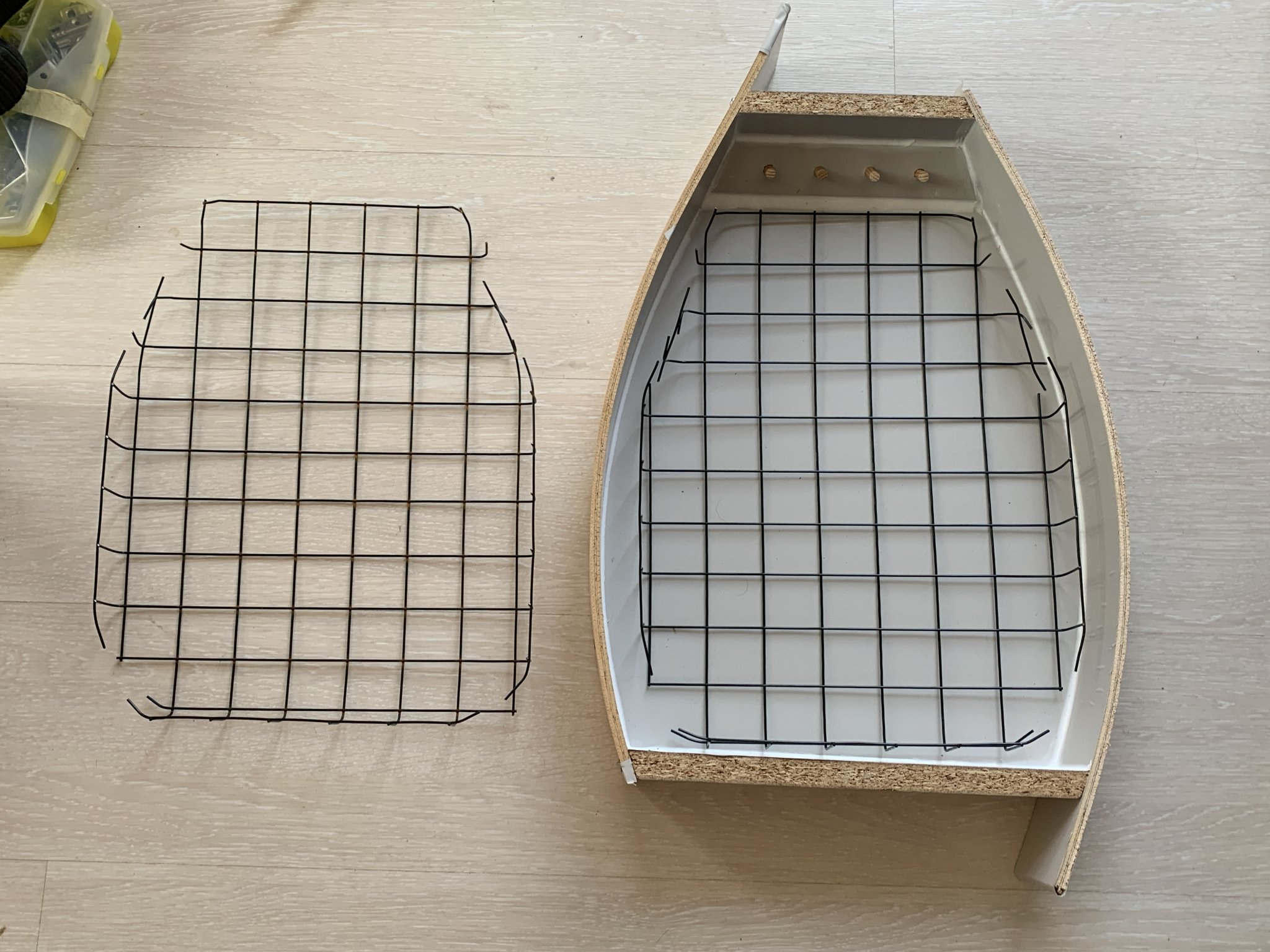

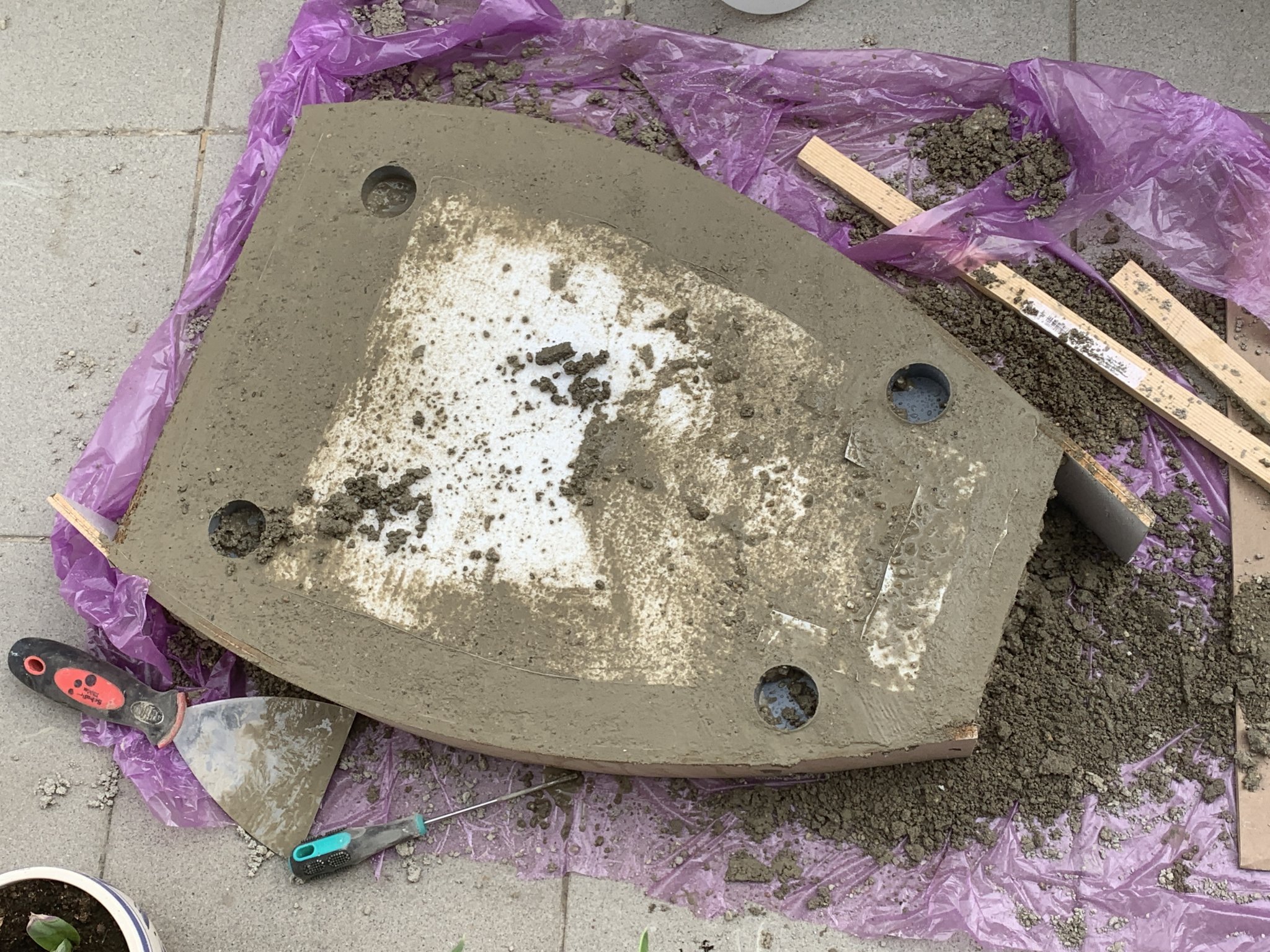

As you can see in previous pictures I wanted to put some mesh into concrete to make it stronger, especially in that "thin" 2cm top wall part. I used some old metal mesh shelfs I wanted to throw away but they found its proper use! :D So they could levitate and make it "flow" I used just a piece of wire and some hot glue to secure it on proper spot:
Everything was prepared for concrete pour. I have used fast, fine and strong concrete, what appeared to be a mistake and it was in fact VERY fast curing one, in 10-15 minutes its becoming to be solid so you cannot fix the mistakes :( I had no chance to even vibrate the thing so for next one I used more water to make it flow better. Anyway everything was successful, I also put in pvc pipe end pieces to create a small seats for metal roller feets:

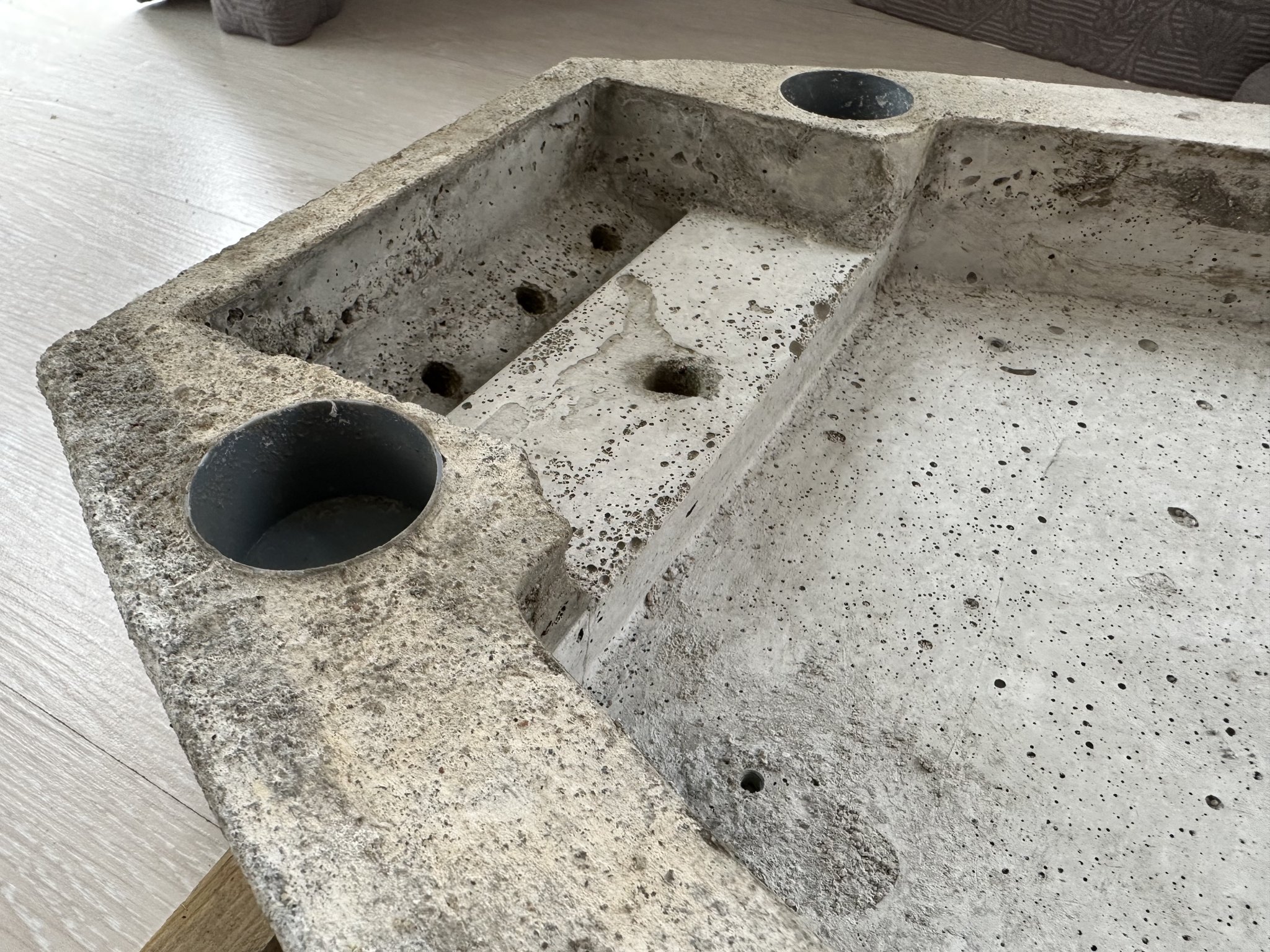

After a day, to get water into center of concrete to give it better chance to cure properly I removed polystyrene and filled it with water. I was curing it like that for 3 days watering it 5times a day:
Today morning I removed all forms and drilled out all the wood channels, forms are ready and very nice and smooth! There were only minor defects, a small bubble here or there which I simply filled with fine cement+sand mixture. I will keep watering it for at least a week to cure stronger... after that I will put clear water-based varnish on it.
Surprisingly its not that heavy as I expected it to be, just ~14kg a piece
Reactions: 7 users
