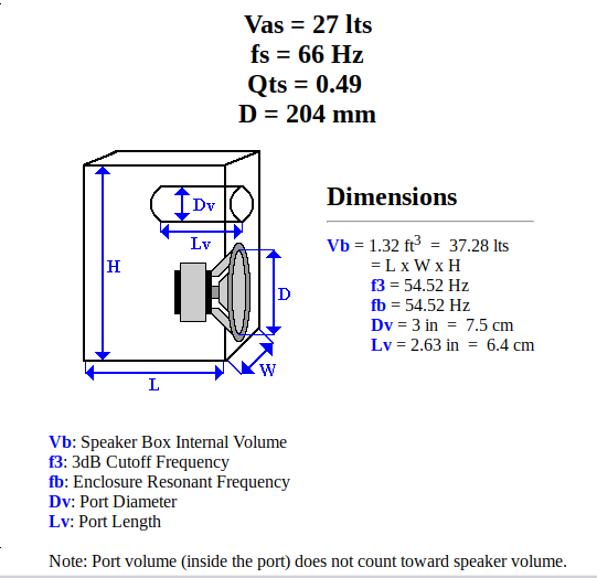

I think this speaker is good for base reflex enclosure because EBP is over hundred.
i need your help to calculate the Vb, port dia & length for this speaker. Actually i want to guide a friend of mine with your help, we both know almost nothing about acoustic physics. As you can see the manufacturer did not provide much information for this speaker

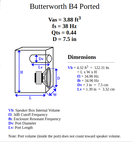

The results of that simulator matches others .
BTW That driver ( as noted by others ) is designed
to reproduce low frequencies .

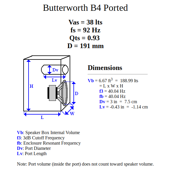

Too high of Qts ( note negative vent length )
