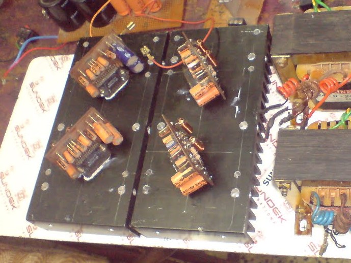

I'm building this multi-amp to drive my DIY speakers. They are 4-way active dipole prototypes with MiniDSP crossovers.
Currently they are powered by 8-channel ClassD amps. They're great except not liking the 2 ohms nominal tweeter impedance (paralleled, the back tweeters are not visible). I did a study on the distortion between gainclone and ClassD before at the acoustic output here.
The 8-channels gainclone amps are based on AudioSector 4780 kit:
As seen above, I'm using no-fuss components sourced from local provider here (Jaycar). I did the effort, however, to painstakingly measure the resistors individually before using it.

The amps are easy enough to wire, although not as easy as ClassD ;)
What is critical is the star grounding. If done incorrectly the output will hummmmmmmm...

Here you can see 160VA, 25v-0-25v Toroidal transformer that I use.
Initially I was just trying it and planned for a bigger one (300VA). However there is no problems using it driving the speakers to deafening level. It is well known that dipoles are very easy speakers to drive (e.g. the woofers operate at their inherent Fs). Hence I keep it.
The cabling could be much neater, but I prefer keeping them long, in case another swap with ClassD is needed :cool:

I noticed the noise / hiss of these amps are higher than my classD, which is surprising. Note that I am using waveguides on the Tweeters which raises the sensitivity to additional +6db to +10db too. The gain might bee to high too on the gainclone.
The hiss can be reduced by applying decoupling caps on the chips (100nF) and the PSU's AC inputs (120nF)
No, I do not have oscilloscopes.
The behaviour of the amps seems like a stable one. Not hot etc. The hiss is audible from 1m which is too much for my liking.
I could reduce this further by lowering the amp's gain, or implementing LPAD to the tweeters. So not really a drama. The tweeter's sensitivity had been increased due to waveguide.
