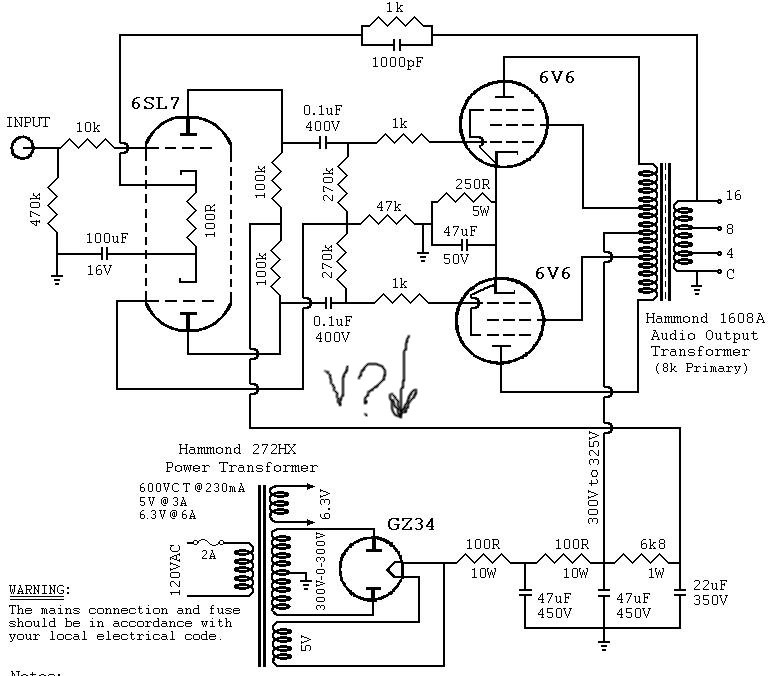

I want to make this amp,
https://diyaudioprojects.com/Schematics/DIY-Push-Pull-PP-6V6-Tube-Amplifier/
but I want to rectify with a solid state, and I have 2 JJ capacitors, one of 32-32uf 500v and another of 50-50uf also 500v, but I don't know what resistance values to put on them, has anyone already made a source like this? or I can repeat the values of the schematic for 6z34 that nothing happens.

You could try it, but the first power supply dropping resistor will have to be a larger value,
to compensate for the tube rectifier's larger voltage drop.
Maybe 120 ohms to 150 ohms, whichever gives the right B+ value.
I would also use a 20W part for that first resistor.
Make sure the silicon diodes you plan to use are adequately rated in voltage.
The 1N4007 might just barely work, but I'd use two in series for each, they're cheap.

Your power supply circuit does not use an input capacitor.
So the rectified DC voltage is much lower, than it would be with one.
But you will still need a larger value for the first resistor, to compensate
for the lower voltage drop of the silicon diodes.

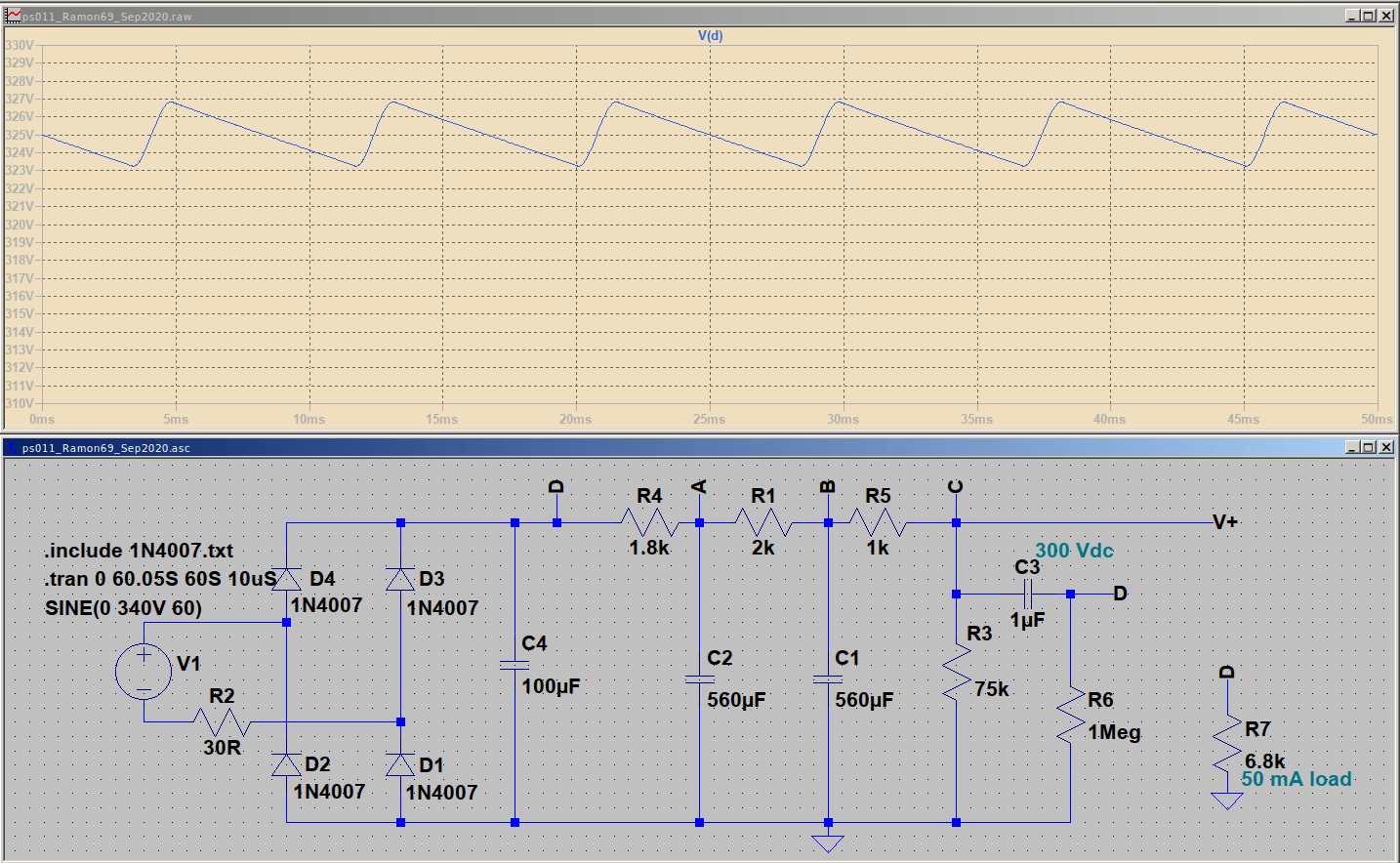

The attached image is a power supply simulation I did with LTSpice back in 2020 to help out another diyAudio user with questions similar to yours (he wanted to use a silicon bridge rectifier). This particular simulation shows the DC and ripple voltage right across the main filter cap fed by the bridge rectifier (C4). I've added a load (R7) to draw some current so that there is enough ripple voltage to see clearly in the simulation. :)
Hope that helps.

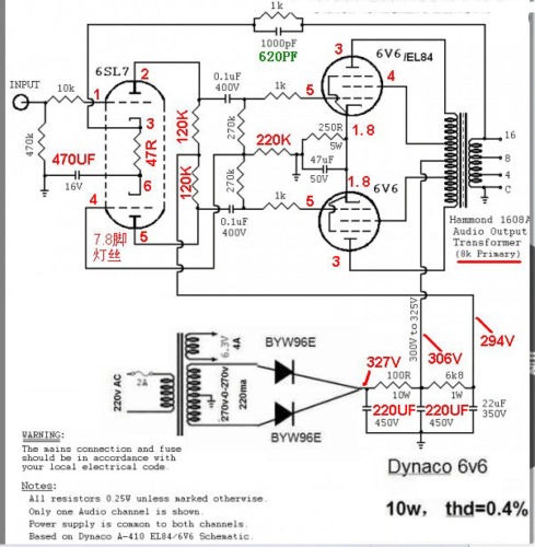

I was learning how to make the power supply, but I have some doubts, if someone who knows can see my schematic, it would be appreciated.
I don't know how much the voltage should be that goes to the 100k resistors, which go to the 12ax7 valve and the coupling capacitors

I ran a PSUD simulation for you, using the winding resistances published by Hammond for the 272HX transformer.
http://www.hammondmfg.com/pdf/EDB272HX.pdf
I assumed nominal output but those Hammond transformers are designed for use with either 115V or 125V mains so results will depend on your mains voltage. At a current of 75mA (total) it seems that a resistor after the solid state diodes of roughly 420 to 470 Ohms does the trick. But best to have some different values on-hand.
Note that power dissipation in that resistor can not be simply calculated from the average amplifier current because the rectifiers will be flowing pulses of charging current hence 20W is still going to get pretty warm. Using two 20W rated resistors of twice the desired value each, placed in parallel, will give you the right overall resistance but now with 40W rating.
The 6SL7 has a high value anode resistor to achieve high voltage gain, don’t worry for now about the voltage on the anode as 200V is fine. Think of this, those front end triodes maybe drawing 1mA, which means a voltage drop of 100V across the 100k anode resistors.
Others have built this amplifier, you can find more published data. An example of voltages from a version built by another DIY’er is attached by my searching up here: https://boffin.nl/wp/6v6-push-pull/
