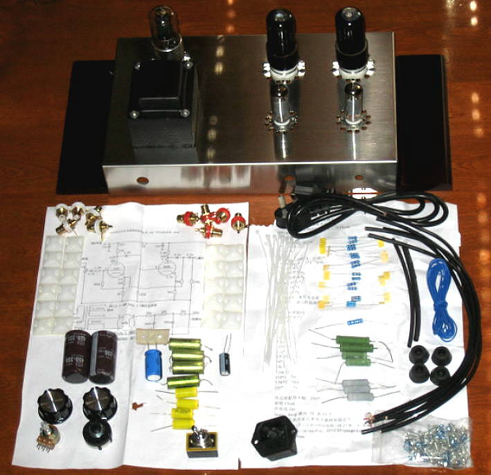

With this kit you get a schematic, chassis (nice one), parts (some not so good) and transformers/choke. Layout is up to you. You could do your own turret board if you like, but it's all point to point. You gotta come up with your own wire scheme, that's where some of the creativity comes in. How are you going to lay it out and make it work.
Bob
I built SiliconRay's 6V6 Pre-Amp which has the same Chassis as the Amp...It is as Bobrown says, you get a Box O' Parts and a Schematic (In Chinese)...But, it's all there and it Works...
