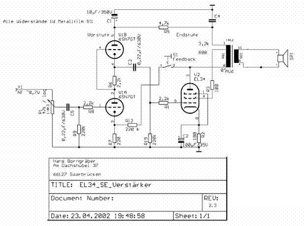

Not tried exactly that schematic but almost similar.
Some comments:
- there is no reason to "waste" two triode sections for driving EL34, not even when triode connected
- grid resistor can be larger than 100 k when auto bias is used, this improves the linearity of 6SL7
- there are few odd component values; cathode bypass capacitor do not need 450 V voltage rating, 50 V is sufficient, and grid resistor do not need 3 W power rating

Strongly disagree with comments about not doubling 6SL7, which is a low transconductance tube. Search on experiences and designs of member yvesm

The thing is. For some applications doubling up might be beneficial. For a tube as easy to drive as the EL34. It really is not needed in my opinion.
I would suggest the OP finds out for himself. There really is no substitute for trying things out for yourself.

A 6SL7 has a wimpy transconductance of 1600, and the EL34 is in triode mode in that design. Bad idea to not double it. Just calling it like I see it.

I in turn fully agree what Bas said. And I have my own experience about this too. Actually 6SL7 with CCS is a very good driver.
leadbelly; what do you think that would go wrong when one 6SL7 instead of two is used to drive triode connected EL34 ?
Distortion ? Frequency response ? or what ?
But please, do not just say that it does not sound good. Then we nothing to discuss about this.
I also agree with all the points artosalo brought up.
I was just curious because i never tryied the 6sl7 in SE aplication as driver...
Yes! The grid resistor can be increased, and i am thinking of changing the EL34 with 6550.
And what do you think that would go wrong when two 6SL7 parallel triodes are used to drive a 6550???

...And what do you think that would go wrong when two 6SL7 parallel triodes are used to drive a 6550???
Nothing would go wrong.
When one is enough, why use two ?
Double the current and lowering the Z output...
This will take place but the Zout is sufficient with one 6SL7.
