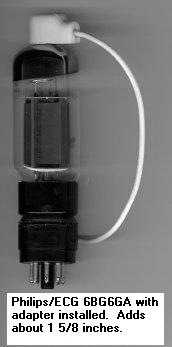

Have received several emails asking for the instructions for making the 6L6 to 6bg6ga adapters so I thought since I cannot find mine I will attempt to put up a step by step guide here.
Purchase the empty octal base and insert piece available from Vacuum tubes and other suppliers.
Purchase some good wire capable of voltages up to 600VDC but still plyable.
Purchase some Loctite Super Glue or similar.
The wiring I believe is as follows
From the empty octal base
1) NC
2) Same
3) Plate connection of 6L6 base to the plate cap of the 6BG6ga
4)NC
5 Same
6)NC
7) same
8) to pin 3 of the 6BG6gA adapter
* a hole will have to be drilled in the base of the empty 6L6 adaper in order to pass the plate wire thru.
once the wire is thru the hole it can be sized for the correct length and then
have the plate cap soldered to it.
If I have make any errors feel free to advise of error.

hey-Hey!!!,
Just a warning; it is easy to make mistakes. Don't even think about using them until you've left them sit for a while and then come back and confirm you've got the pin connections made properly. Time between assembly and final test is critical...I've made enough mistakes on adapters like this to embarras a room full of folks...🙂

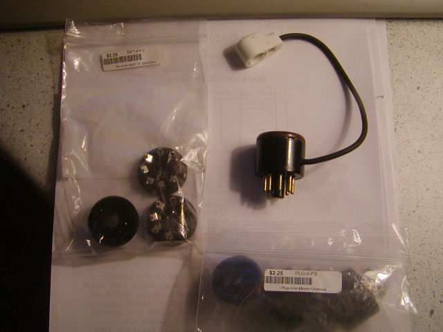

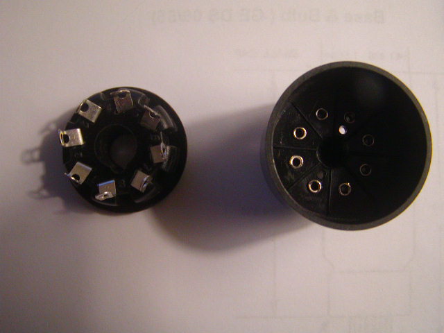

Found these in my garage.
They can be purchased from Radiodaze.com
PN PLG-8-P3 $2.25ea
PN SKT-8-P2 $3.25ea
They also have the HV plate cap.
PN PLG-8-P3 $2.25ea
PN SKT-8-P2 $3.25ea

Screen connection? This would go to pin 4 of the base adaptor..
From empty Octal base to socket
1)NC
2)SAME
3)PLATE CONNECTION OF 6L6 TO THE PLATE CAP OF THE 6BG6GA
4)SCREEN CONNECTION TO PIN 8 OF 6BG6GA
5)SAME
6)nc
7)SAME
8) TO PIN 3 OF ADAPTER SOCKET
tHANKS kEVIN FOR FINDING THE MISTAKE
