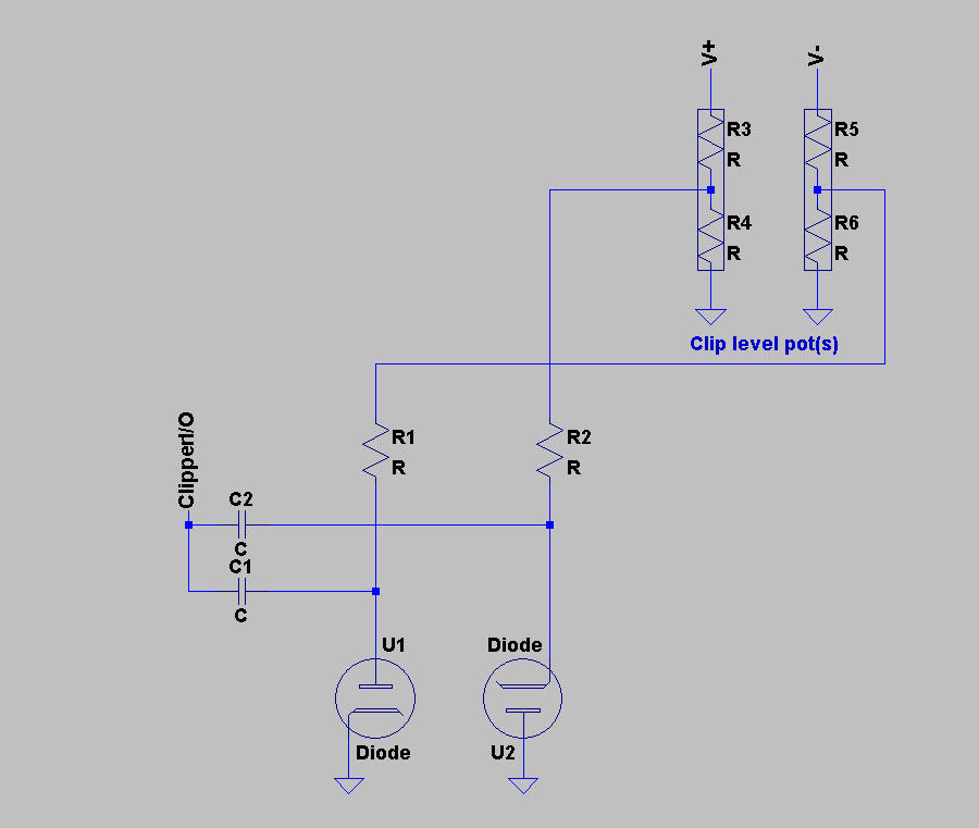

Yes, watch battery in series with each cathode with + side to cathode, each series battery/diode combination can be connected back to back.
You can also apply variable bias to the diodes, this is a bit trickier, and works best with bipolar supplies and potentially a clutched pot.
Something similar to what I have drawn will work..
Soooo.... Nobody has actually made this work?![]()
Yep. The trick is to lower the heater voltage to between 3.5 to 4.5V, as this stops the reverse conduction you usually get at small negative Vak voltages.
