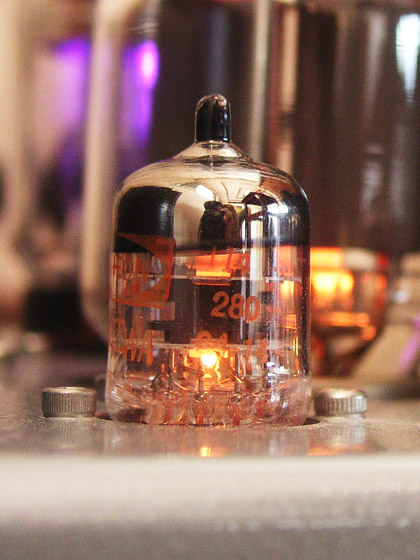

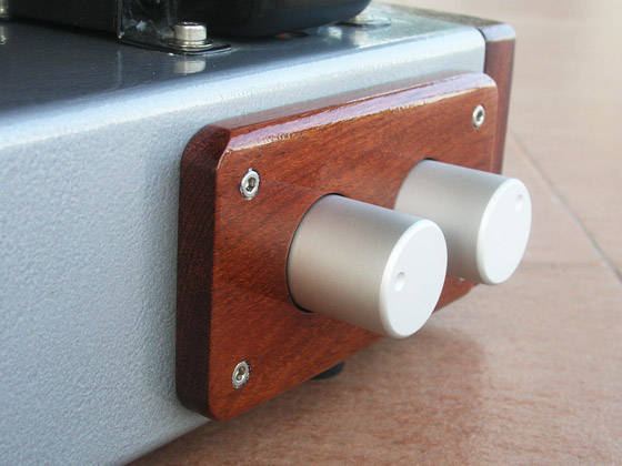

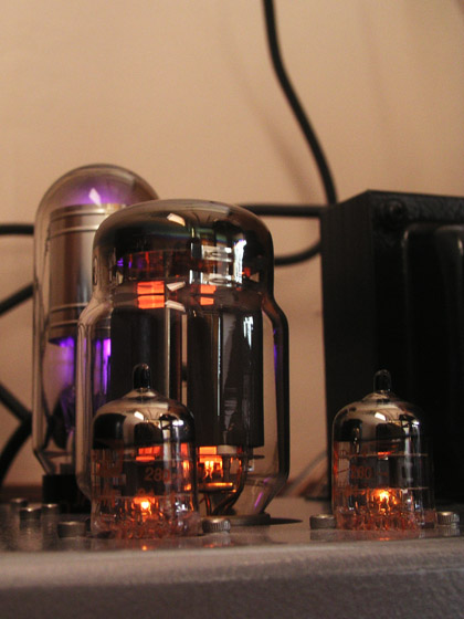

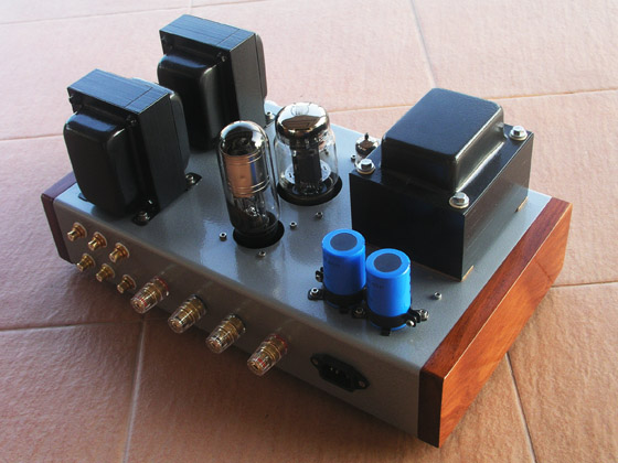

Hi, I build 6528 SE last two year for my friend. It was a good sound amp.
I used 5842 as a driver and 3B22 as a rectifier tube.🙂
