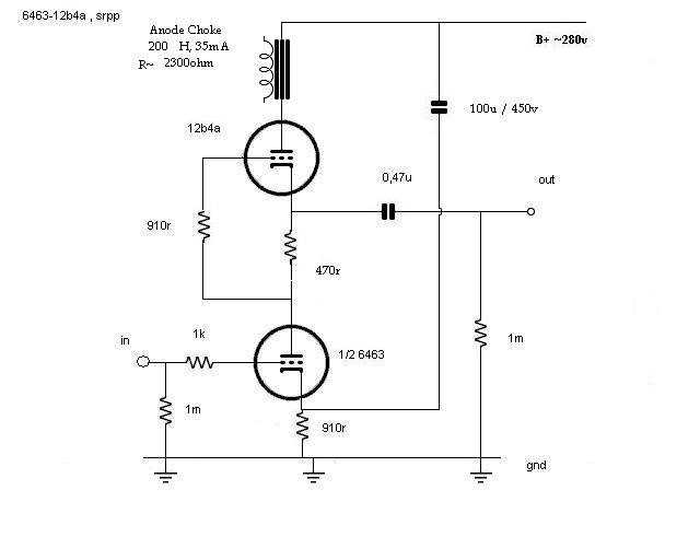

Ok folks.
Since I am a truly beginner when it comes to circuit designs, feedback and advice would be appreciated.
What do you think of this design?
It is the first version.
6463 is almost the same as 5687.
BTW. I came across a circuit called the "mini monkey" which seems a bit interesting.
It is mentioned in this thread
http://www.diyaudio.com/forums/showthread.php?threadid=95526
Schematic is here:
http://www.diyaudio.com/forums/attachment.php?s=&postid=1123584&stamp=1170462812
So, do I really need the grid resistor (910ohm) from the 6463 to 12b4?
Sincerely

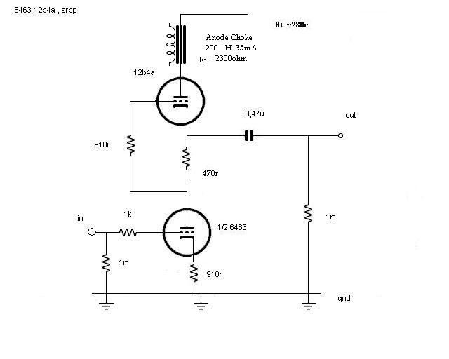

Schematic is here:
Sincerely

You shouldn't use dissimilar tube halves in a SRPP config to begin with or it won't be an SRPP anymore.
Cheers, 😉
Cheers, 😉
