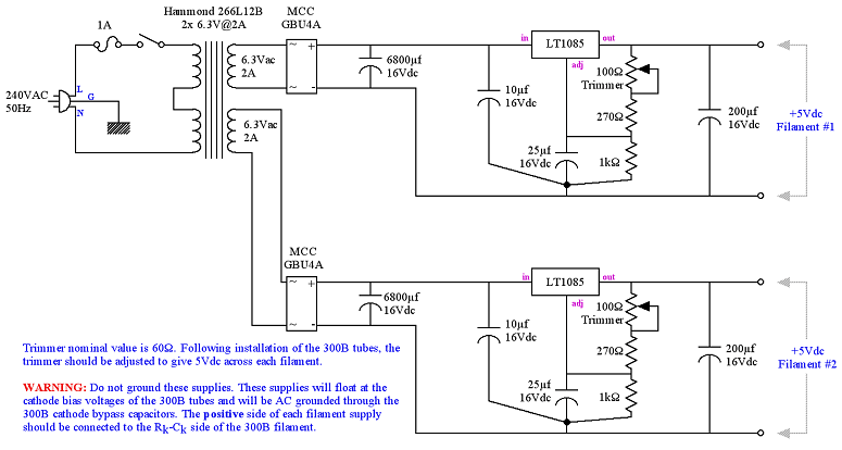

  1. 6.3V AC from my current transformer -> skotchy bridge -> filter cap (either the one I have or another) -> LT1085 regulator as shown below.
    This option is assuming the skotchy bridge gives me enough voltage to drive the regulator circuitry as with my current bridge recitfier the voltage is too low. (How does this schematic look to you?)
  2. 6.3V AC from my current transformer -> rectified and dropped with resistor the brute force way. This option is extremely simple which I like, but I've never checked how much the mains voltage vary in my home. Being in Italy, EU enforcement guarantee ±10% which is way too high of a variation for the DC supply but also for the high voltage supply. In practice the percentage is definitely lower and I'd have to measure it. None the less this is a great second option.
  3. Add another transformer and buy Rod Coleman boards which I've heard great things about, but with the chassis being done and everything mounted I don't have too much space for the transformer, the board and some heat sinks which I guess will be required.
Do you guys think that with skotchy diodes I could get a significantly higher voltage to make my regulators work properly? If that's the case I'll look into buying some and test things out. Otherwise I'll get some 2Ohm power resistors and try the brute force way.
For 1.3A DC, the RMS current in the PT is ca. 2.5A, and the peak current is ca. 7A.
A 2.5A PT is not enough - you need an extra margin, to allow for the peak current.
This may be the reason why you didn't get enough DC voltage....
I recommend at least 4A, preferably 5A or even more. The PT is more likely to buzz, if the rating is too low.

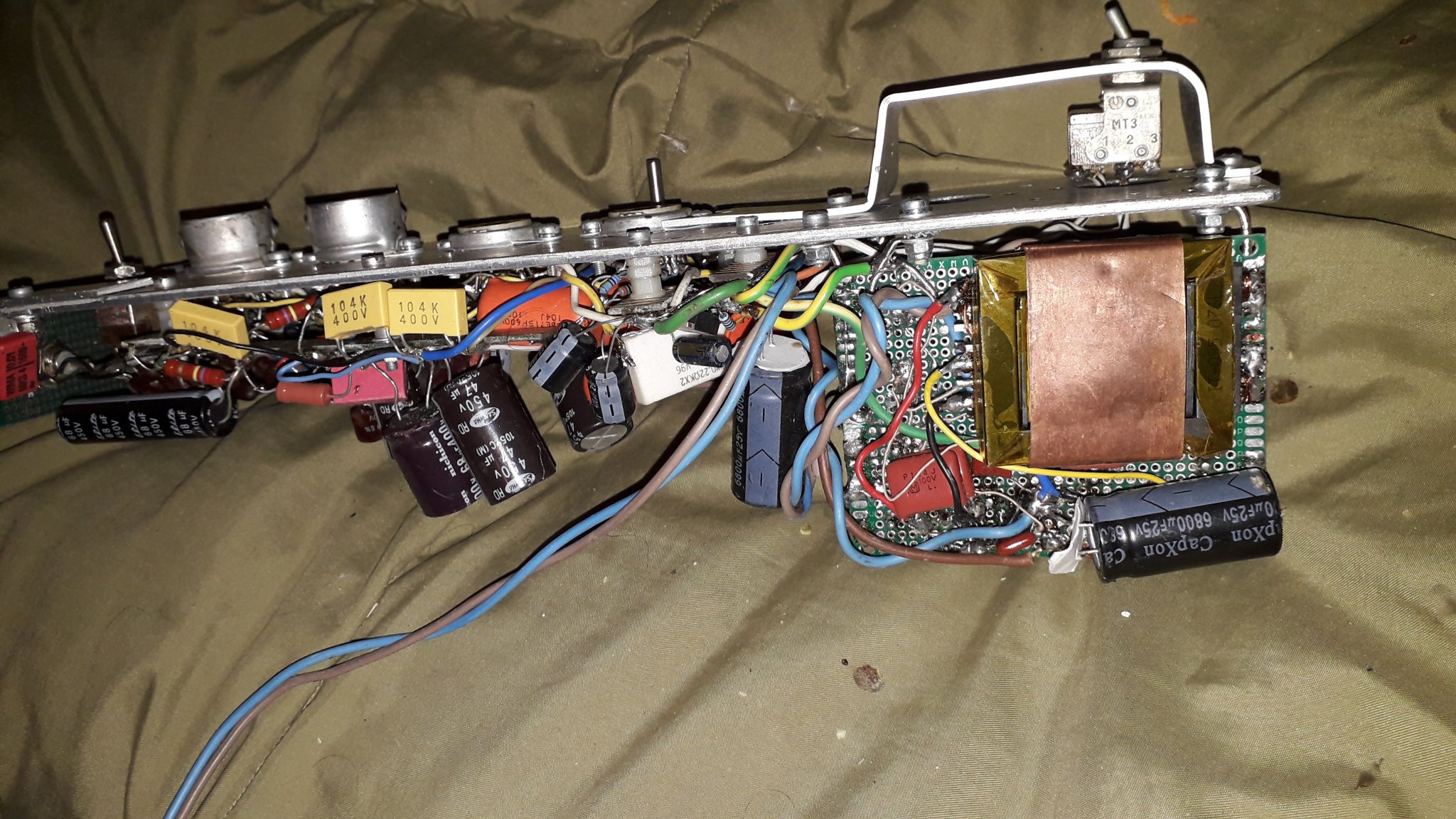

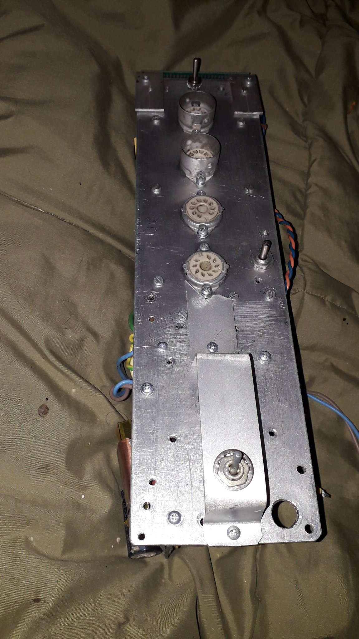

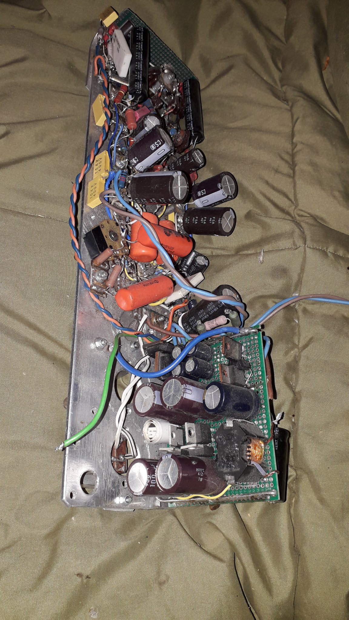

I'd use a resonant converter to get both fillament and high voltage supply from a cheap 12v smps anytime although for a serious project a resonant converter based on a specialised IC working straight on the mains grid might be a more proper choice.Never tried that yet.
Here's my last year developpment of the concept with the help of Dave who suggested me a miraculous circuit after my first bipolar Baxendall resonant inverters trials on high voltage forum.
I especially recommend those guys for high voltage design experience if not used to do it.
https://highvoltageforum.net/index.php?topic=1439.msg10989#msg10989
Here's my Luxman cl 34 clone using its last embodiment...I used a 12 v Sony Play station 2 supply for trials.In the mean time i found that ebay offers many r-core transformers having both low and high voltages for tube equipment and a classical approach is always simpler.
