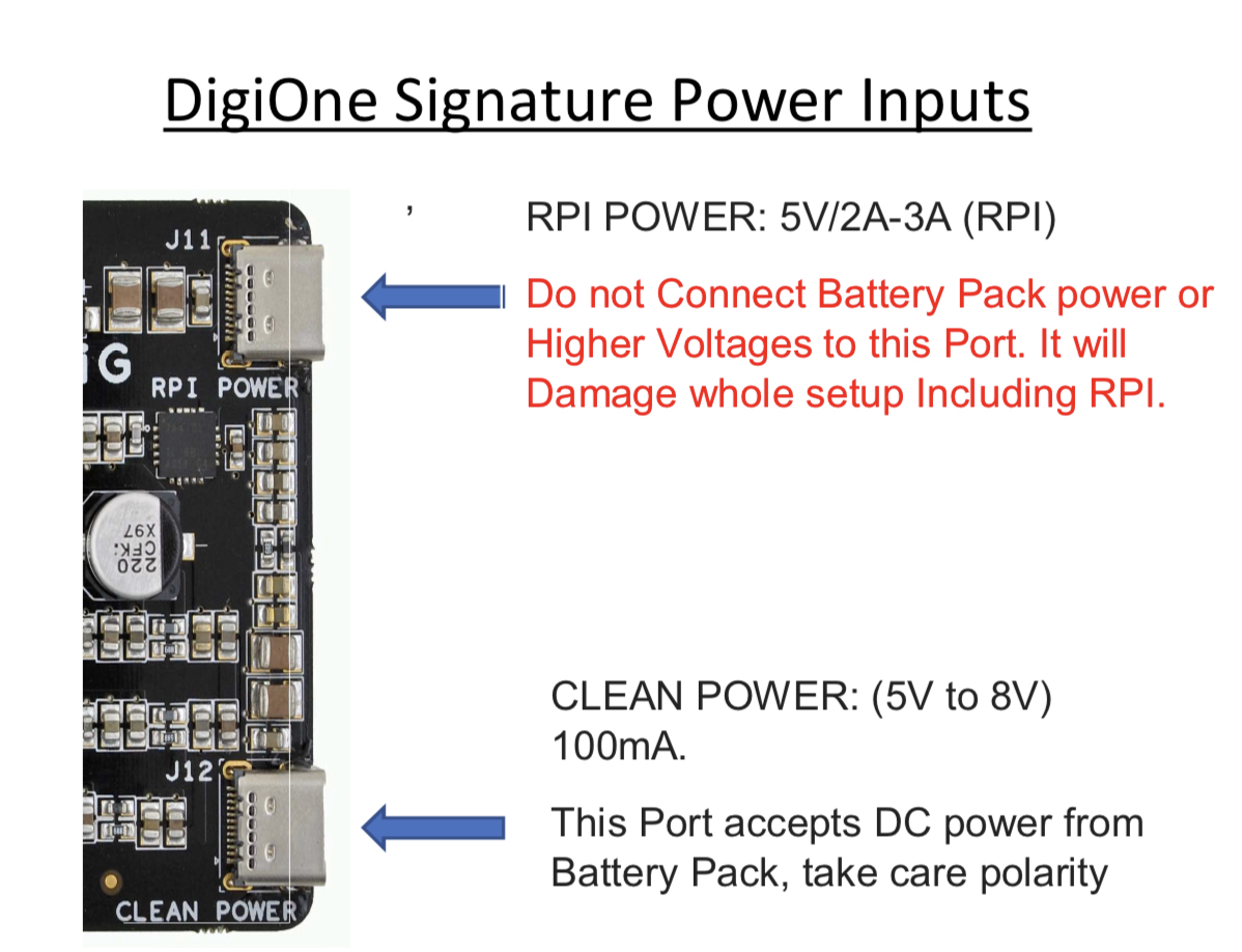

Pretty small requirements. I’d like to DIY a “clean side power” for an Allo Digione Signature player. There are several options for kits on eBay and Alispress, I’m not opposed to that route - if someone can recommend one. Or a design. Thanks!
DigiOne Signature Player SPDIF Out
They also have two power supplies
Nirvana $60
Nirvana SMPS
And Shanti $160
Shanti Dual Linear Ultra Low Noise PSU
Nirvana $60
Nirvana SMPS
And Shanti $160

A standard linear PSU 5V 1A would suffice but I guess you want lowest noise. Therefor I would steer away from scrap switcher stuff with a 265 Euro Digione player.
The ready made LM723 based industrial PSU's are often very good quality with regards to noise. They are cheap and only need a recap if they are very old. I recently found new in box ones. Fully protected, built in transformer and integrated heatsink/frame as well.

OP wants a silent PSU. Dinosaurs LM317 and 7805 are not ultra low noise. Dinosaur LM723 is already factors better but TPS7A4700 and LT304x based PSU's are even more silent.
Any switcher will need a linear regulator to be called silent. This seems counterproductive so I would go fully linear then as results are often best possible. This involves strange primitive devices containing steel and copper called "transformers" 🙂 Heresy in todays switcher world but way better for audio despite the negative propaganda.

The LT3045 would work if you parallel two of them. 0.6 microvolts noise. https://www.analog.com/media/en/technical-documentation/data-sheets/lt3045.pdf
Personally, I'd probably tap the 5V line on my computer. Or the 12V line and use an LDO like MIC29300. MIC29300-5.0WT

Not a native speaker but I think "clean side power" means a silent PSU is required. This was supported by the given suggestions by the OP for relatively expensive ultra low noise PSUs. Add to this the Digione picture and PCB that both speak of "clean power". "Clean power" is generally seen as a thin line of DC without noise or any pollution. This would trigger to first search for lowest noise/best performance and only then look at costs. Whatever.
The MIC29300 is on of the noisiest regulators on this planet. It varies from 260 to 400 µV of pure noise!!! One almost can't choose worse and no sane person would use this one for audio. A linear regulator like that makes SMPS look excellent 😀 I would choose lowest noise/best performance at most affordable price so the suggestion of the LDOVR TPS7A4700 comes very close to "clean" with a factor 100 less noise for 36 $ all in. Just saying. When using the noisy 12V line of a computer PSU one also does not need an LDO for 5V. Even 7805 is then a way better choice.

As a reminder post #1. Read carefully and find out what OP wants. Hint: both Nirvana and Shanti are below 2 µV of noise over a broad frequency range. The MIC29300 would be a factor 130 to 200 more noisy. In the semiconductor world we call that "worse".
I suggested linear PSU's exclusively. SMPS are generally good for the bin, exceptions like the Nirvana confirm the rule. Nirvana has lower noise than 1 mV so the oceanfront property in Saskatchewan is accepted 🙂
