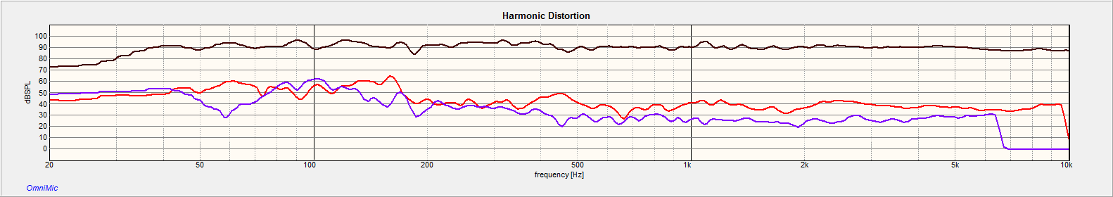

Any info about the distortion figure on the Celestion? I find the (relatively high) distortion level is a major weak point of many pro compression drivers, and large percentage of pro direct radiators, too!
For example, I recently measured what I thought was a sweet 18" driver only to find that distortion barely beat 1%. If I want that I would just buy Goldwood and be done. You can and should do better, ya know?
Over at PE TT people were recently fawning over a "new" Peerless CD that was not too expensive... "Oooh what a nice flat and extended high end!"... well, until someone measured it. It had 7% distortion! Holy cow pies, Batman. Yeah, sure, that is exactly what I want blasted at my ears at 105+dB/W!

Huh? I've measured it, it doesn't have anything resembling 7% distortion. Maybe a rubbing voice coil in the one they measured?
Everything above about 1500Hz in the plot is from that driver.
Bill, it's your post from which I got the 7% figure:
Impressive new compression driver from Peerless - Techtalk Speaker Building, Audio, Video Discussion Forum
This is a link to your post from PE TT in which you mention the 7% distortion figure. I faintly recall scrolling through the thread quickly and looking for some distortion data. When I came across your post and saw "7% HD2 at 100dBSP" I stopped reading and somehow that number stuck in my brain as the nominal distortion level for the CD.
Now that I have gone back and re-read the post a little more carefully and looked at the plot you attached, I see that the distortion level is just above the 1% mark above about 2kHz.
