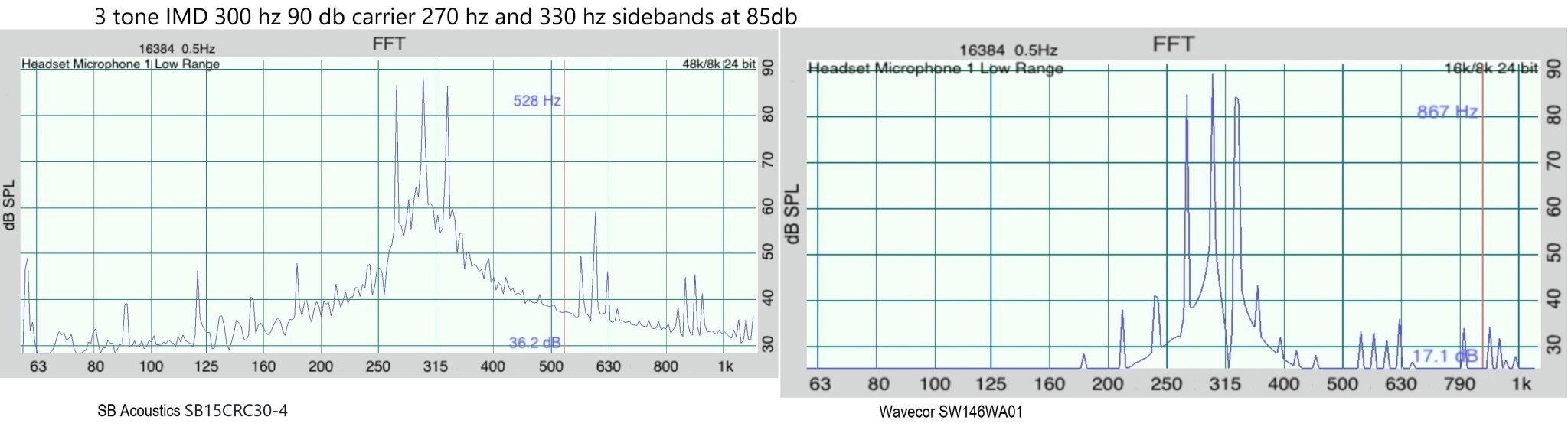

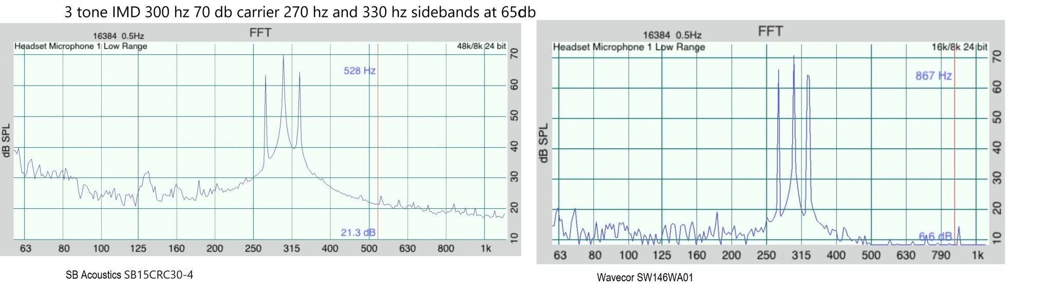

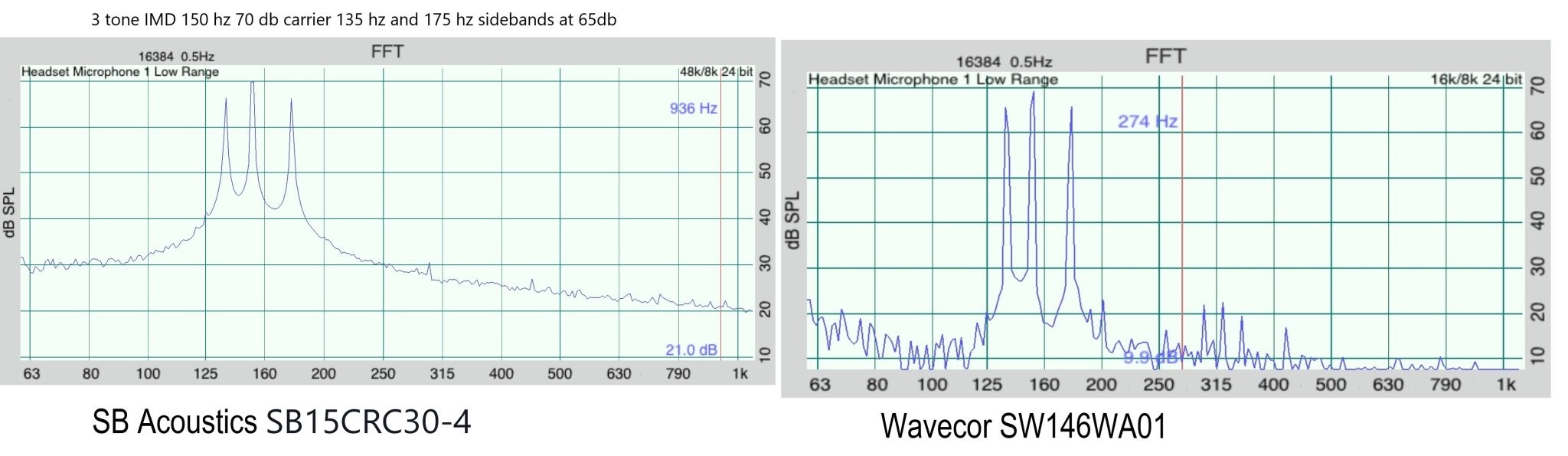

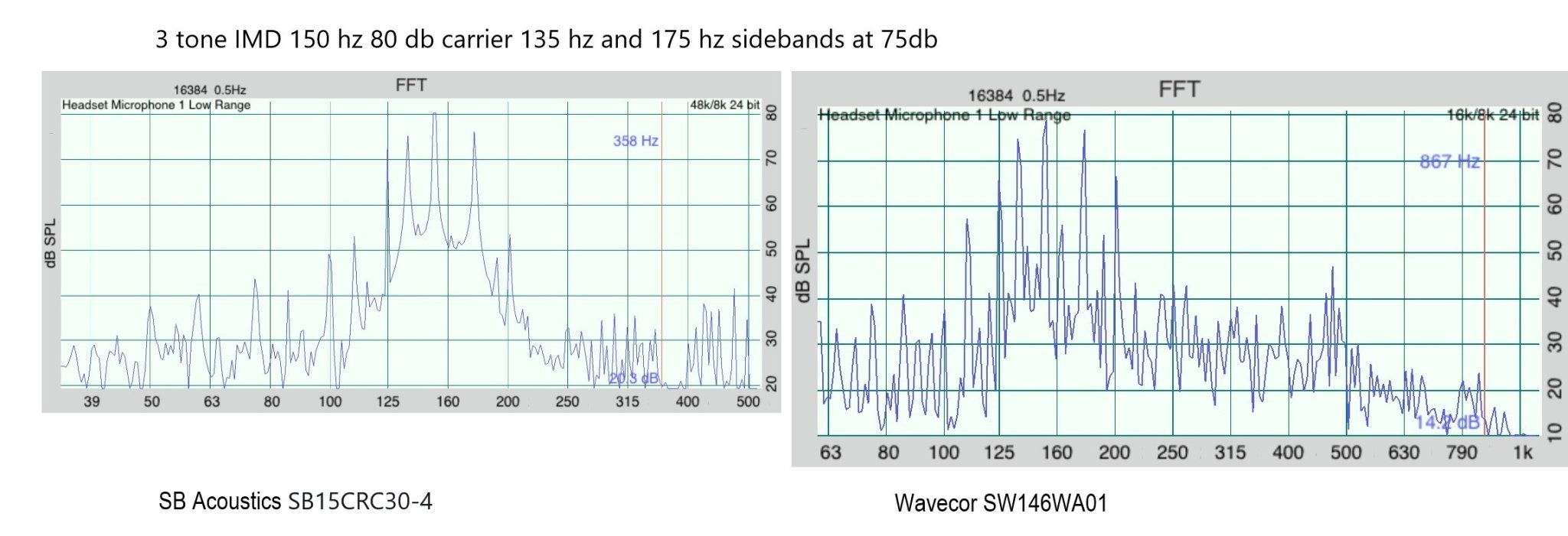

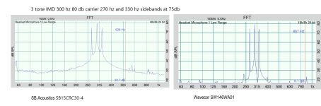

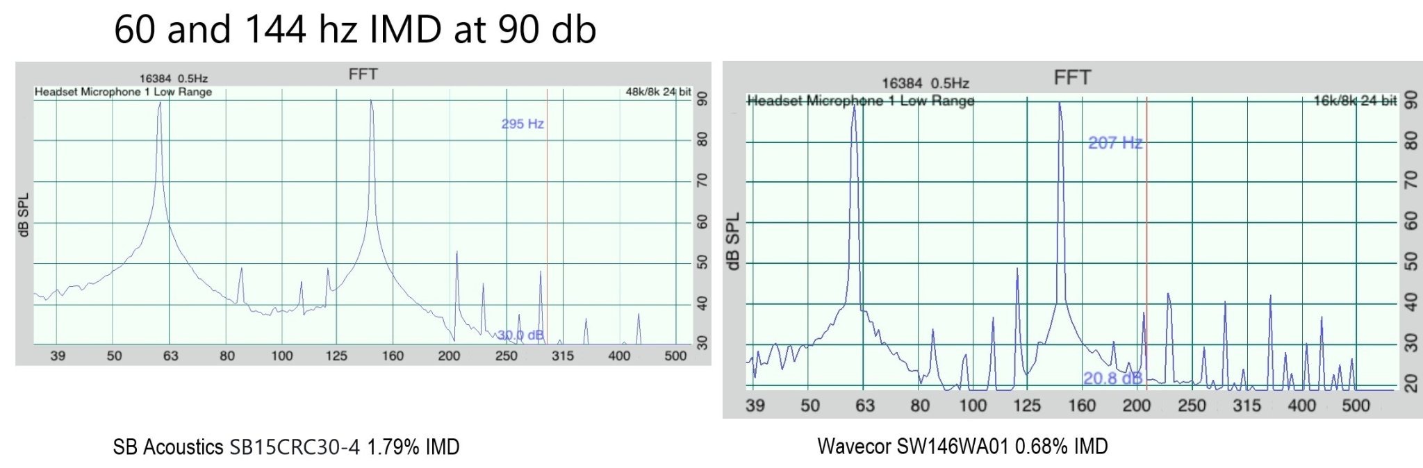

Another IMD (Intermodulation Distortion) test. The first in the 5" driver size. I will be comparing the Sb Acoustics SB15CRC30-4 with the Wavecor SW146WA01, these measurements have been made under the same conditions as my other tests done in 14 liters such as the slighter larger 6-7" tests https://www.diyaudio.com/community/...ootout-purifi-anarchy-plus-maybe-more.371979/

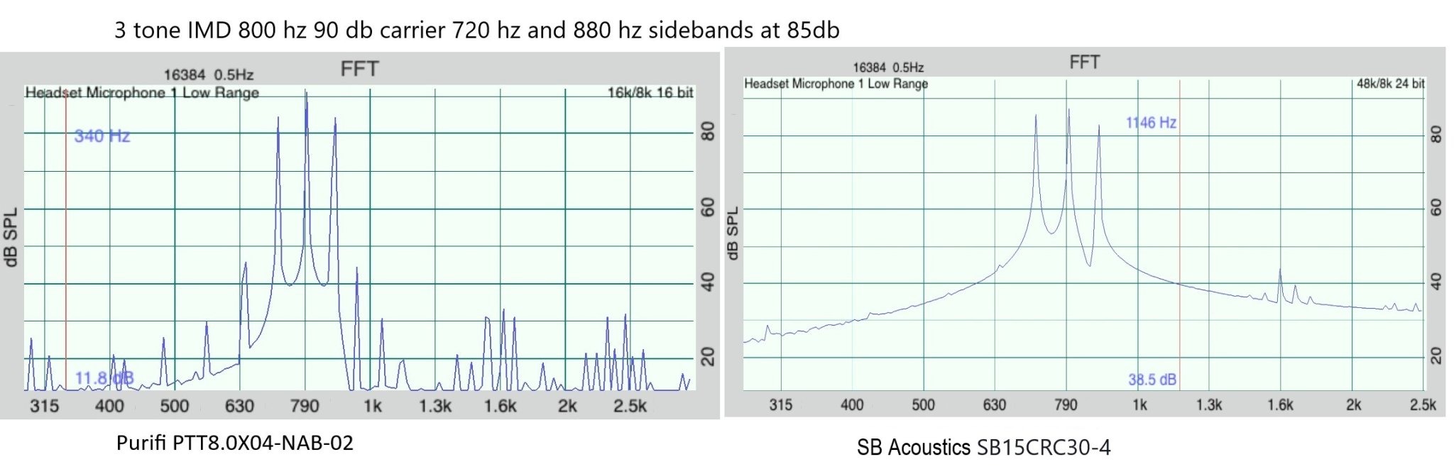

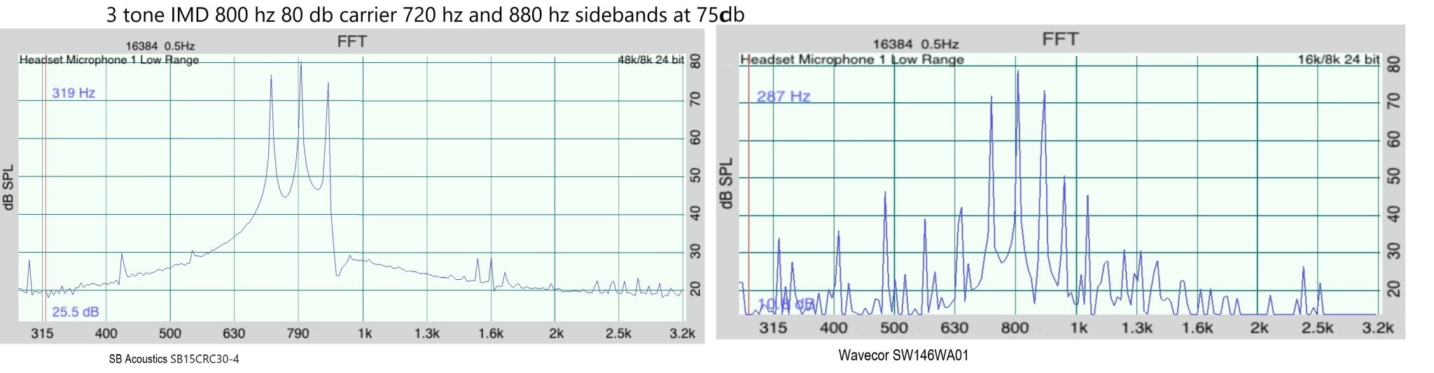

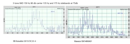

The Sb Acoustics SB15CRC surprised me with how crystal clear the midrange is, this showed up in measurements and in listening tests. The Sb had one of the cleanest three tone tests at 800 hz of 20 drivers (only surpassed by a 8" Purifi, but out performing a Magico midrange). With music, I noted in songs that had duets that you could pick out the singers individually as opposed to a kind of a combined vocal that comes out of most drivers.

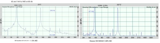

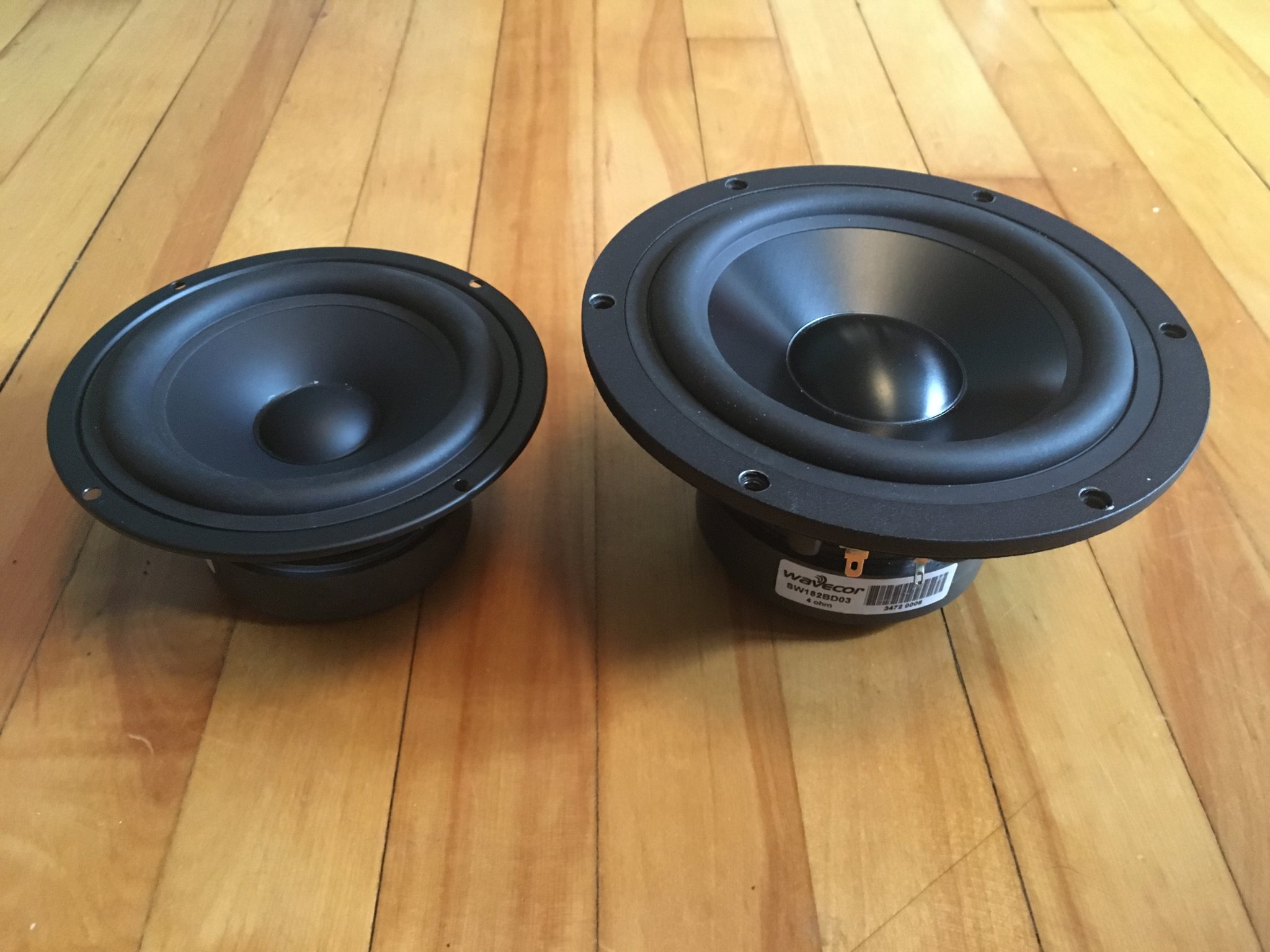

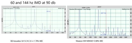

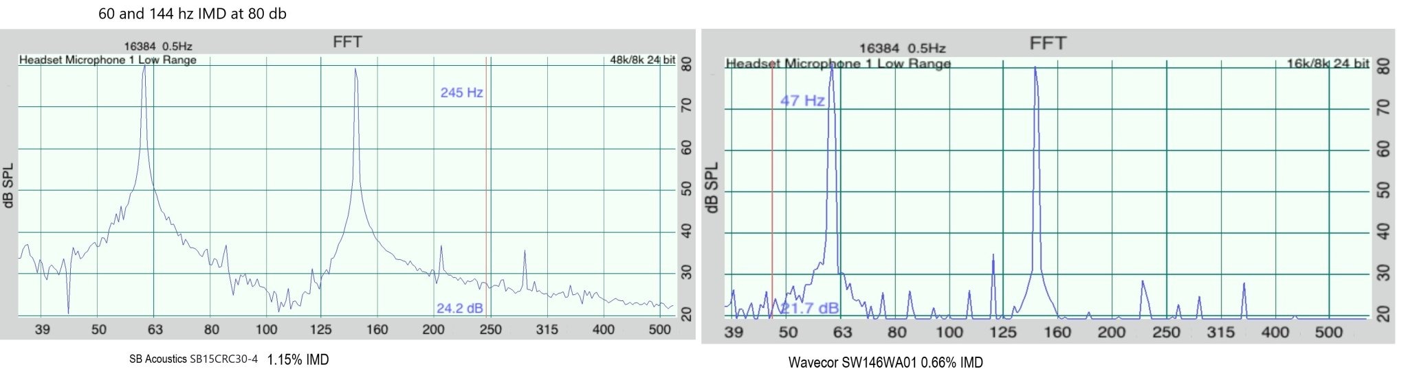

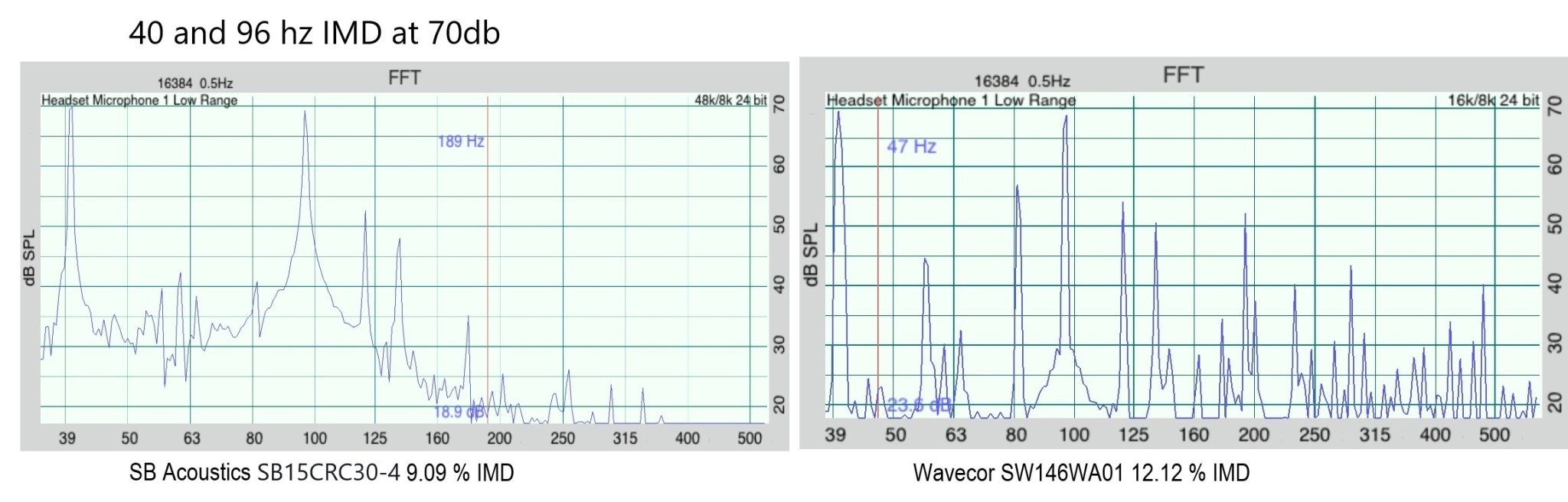

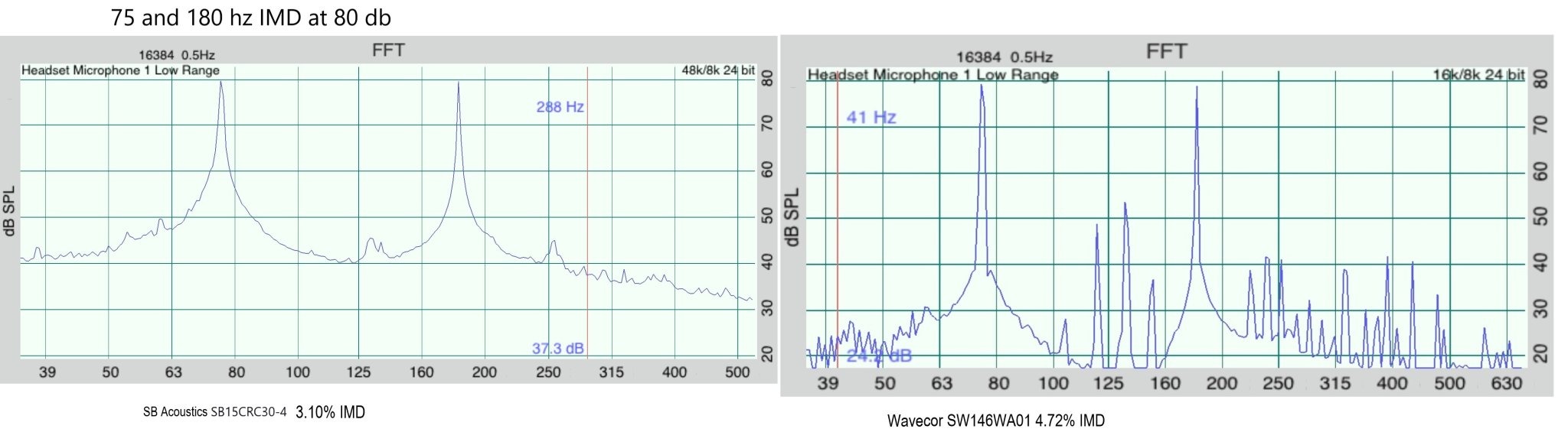

The Wavecor SW146 also did very well in some of the tests especially the 60 and 144hz bass IMD test. The Wavecor has a low loss suspension and will give a good punch to a kick drum. However, having tested the very slightly larger SW182 (see size comparison in attached photo) I do prefer that one for cleaner deep bass output.
Testing conditions are as follows: The test enclosure is a .5 cu ft (14 liter) sealed box with the bottom lip of the speaker just 2 inches above the floor. The microphone is on a stand 49"high with the base of the microphone 33" from the driver. A distance of about 1.5m from the speaker to the microphone. As I'm not measuring in an anechoic chamber my measurements are not comparable to anyone else's but comparisons can be made between the drivers I test.

One aspect to consider is that your may need to adjust for the same SPL for all the drivers. Also, you might want to go nearer as anything rattling will add to distorsion. I would go so far that it would be ideal if your could EQ the drivers to say within 1 dB (between them) and then the SPL to 1/2 dB. Then, and only then can a true comparison be done.
Why - because if a certain driver has e.g, a peak at say 3khz and and the other a dip of 3 dB at the same frequency, a 6 dB difference is present - it will be enough to make glass or metal boxes rattle - this could equate almost double the distortion...
I realised this as I was trying to measure if a resistor in series or a resistor and an inductor would make any change to distortion... how the FR was affected by these passive components skewed the results so they became not immediacy comparable - I simply had to do compensation to make a proper judgment... post...
The first attachment (3 tone), are you sure the background noise was the same for the two occasions... really big difference in the "grass"... for IMD, the background noise is really important - much more so than for a sweep....

Thanks for the feedback TNT. I do EQ all the tones as well as I can. This is done in real time so I try to be quick about as to not let the voice coil heat up. What's also interesting is how some drivers show compression of the tones. For example, all tones are matched at 70db and by the time I get to 90db, with some drivers one of the tones is down a db or two. I try to compensate for this. The worst offender I've seen for this was the Epique 180.

I do see some fluctuation of the noise floor as you noted, I personally put more value on the drivers that are doing better in my higher spl tests for this reason.

I it's interesting to see some testing. However, to really get the idea what's going on we need to test IMD at worst-case scenario frequencies. Very often, HD and IMD have same/similar underlying non-linearity causes arising due to driver's motor design and this often manifests as elevated 3rd harmonic. Therefore, at frequencies where harmonic distortion is high we can expect to see elevated IMD as well. So, first do HD sweep to find peaks for HD. Then, run IMD test at high harmonic distortion positions, in realistic range of use with high frequency ratio, eg 70:2000Hz or so. Would be interesting to see the result.

Thanks for the feedback guys. I consider my bass IMD tests to be sort of a torture test because the low tone creates excursion and the high tone is usually around the impedance minima where current is high. But it would be interesting to cover the whole range of the midwoofer like 40-2000 hz, this could test how clean drivers are with excursion and as they get close to breakup. Drivers tend to be cleanest when run at their impedence peak so really the more variety of frequency tests the better to even out the favorable and non favorable frequencies.
