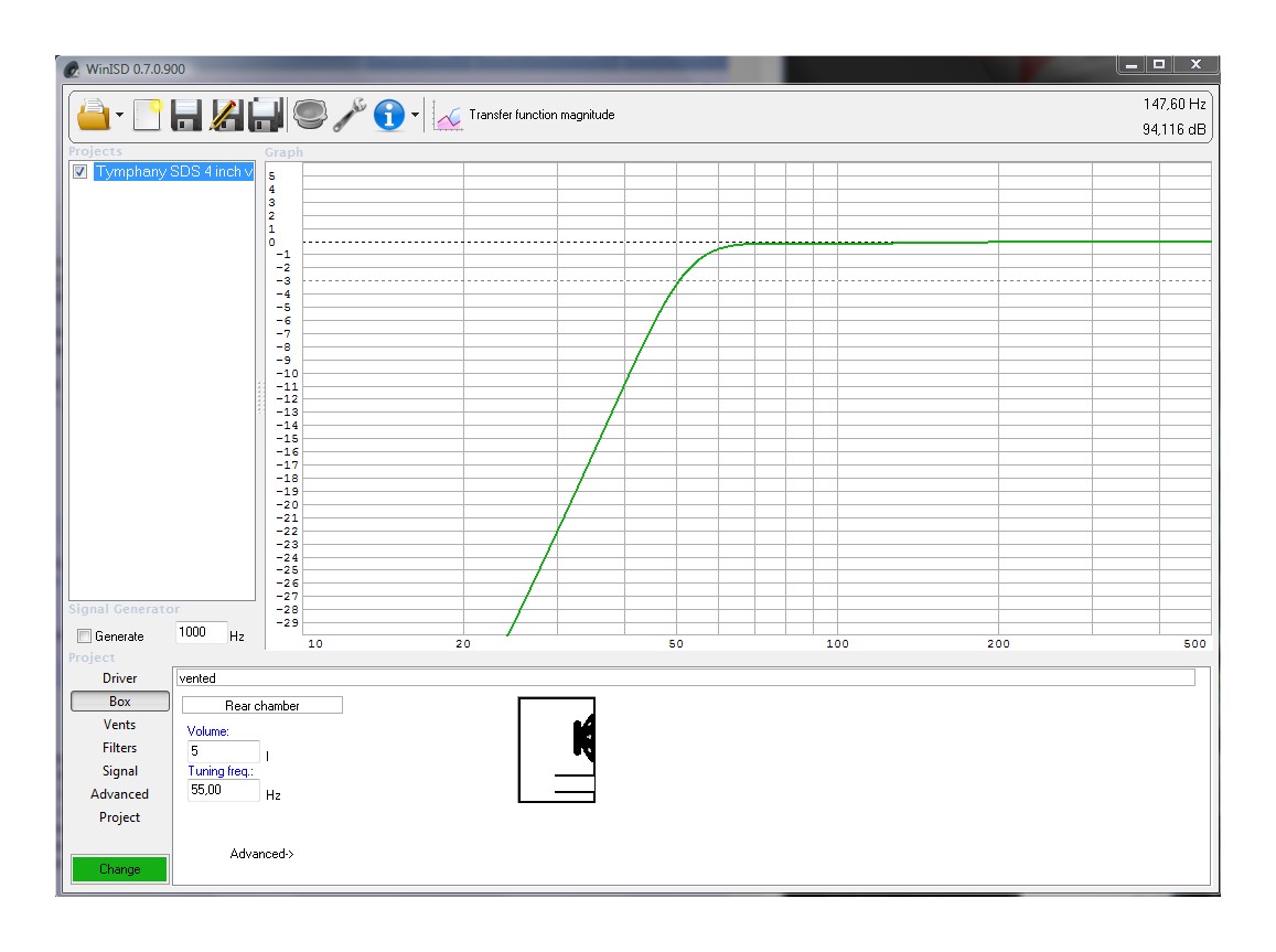

Just finished modeling a few 2.5" to 4" drivers in WinISD.
The W4-1720 by Tang Band has a good rep but I'm getting really odd results in WinISD.
It seems to take massive amounts of power (high SPL's), but I just can't get the low end extension (below 100hz) it's been rep'd to have.
