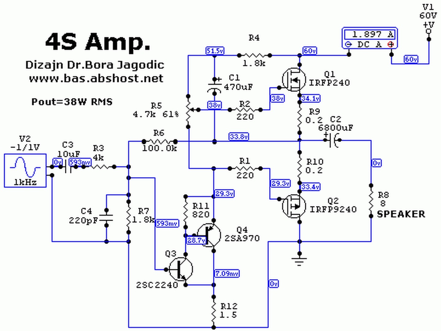

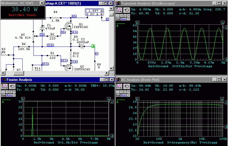

Elegantly simple.
2 more transistors + 10 v more rail voltage gets me 72 watts instead of 38. Apex AX6.
If this circuit wastes 1 to 1.8 A of rail current at idle, to produce 38 w into 4 ohms. then it is a useless pile of trash. The heat sink required for Q1 + Q2 would be $$$.1.to 1.8A is my tested bias
The competition quoted in post #6 wastes 20 ma of idle current, or 1.4 watts, to produce 73 watts (24.2 vac out).
Pls. Enlighten your knowledge by reading the difference in topologies like, Class A, B, AB, D, H etc. In audio amplification.
Class A was high tech in the 1950's when a power transistor in a 3 watt output car radio cost >6 hours pay. I knew black movers who had worked for <$.75 an hour prior to inflation.
Now that power transistors cost <6 minutes pay, and we are suffering the hottest days ever and the most floods forest fires and hurricanes ever, Class A is stupid tech. Especially stupid is a 38 watt output version that consumes 108 watts.

He has better designs than this. I was inspired by his big collection (20+ designs).
Making fun of class A ? most AB amp VAS's run in class A. EF3 runs in class A until the (final) output stage.
