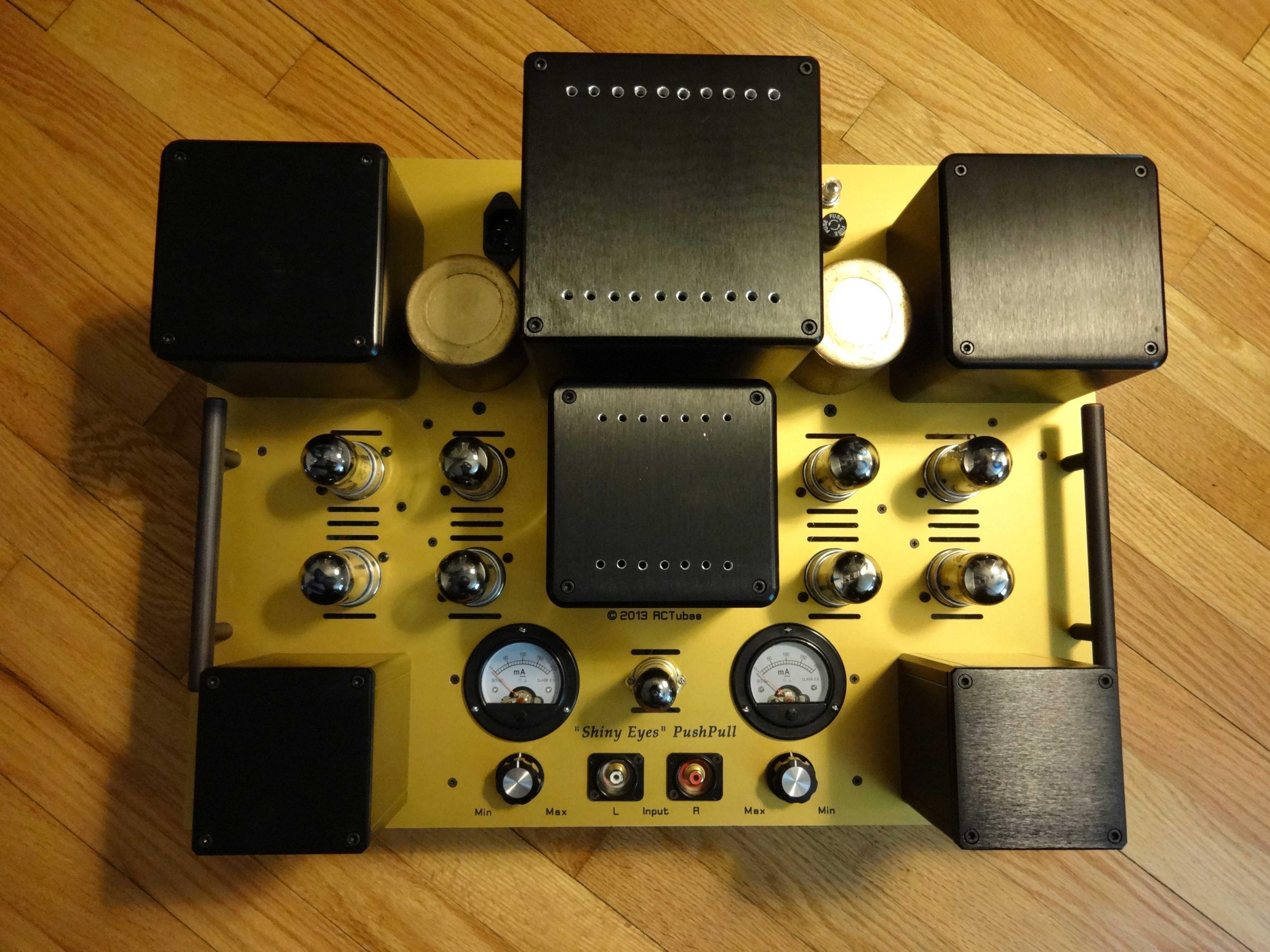

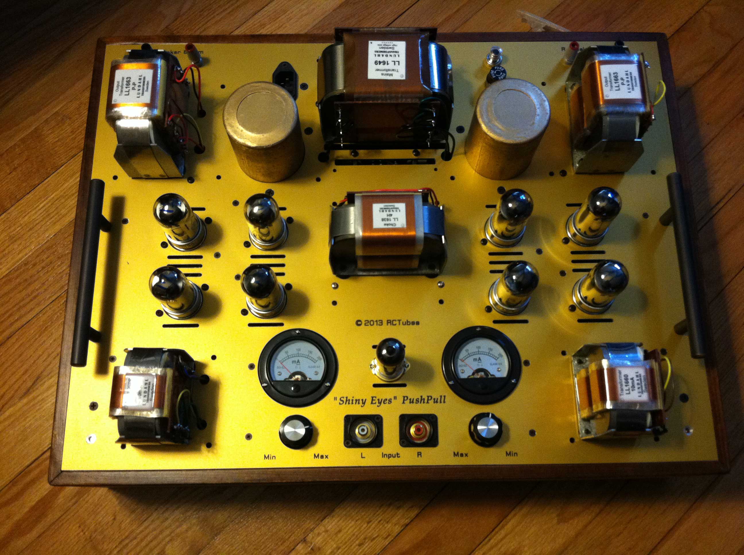

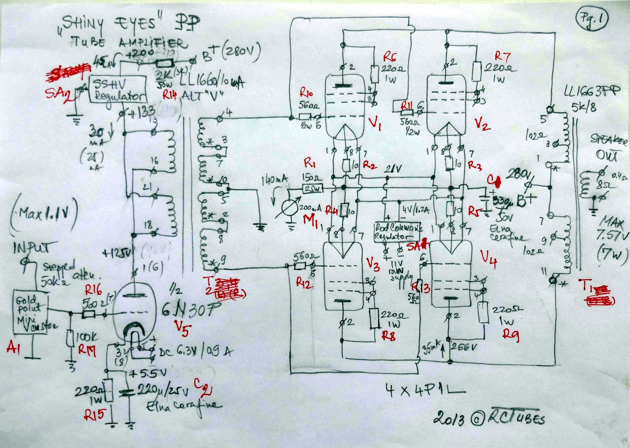

Hi all,
I am happy to present my latest incarnation of a push-pull amplifier with the amazingly linear Russian pentode 4P1L. It uses Rod Coleman's regulators for the filaments of 4P1L. The final stage is pushpull parallel 4P1L driven through a LL1660/10mA Alt"V" by the 6H30P-EB. The amplifier measures a THD of 0.2% at 6.7W. Total gain is 17dB (X7.3). The sound is amazing, somewhere between SE and PP.

Um.... I don't think it's just the sound that is amazing. That's a very pretty build! Congrats. Will you be sharing the schematic?

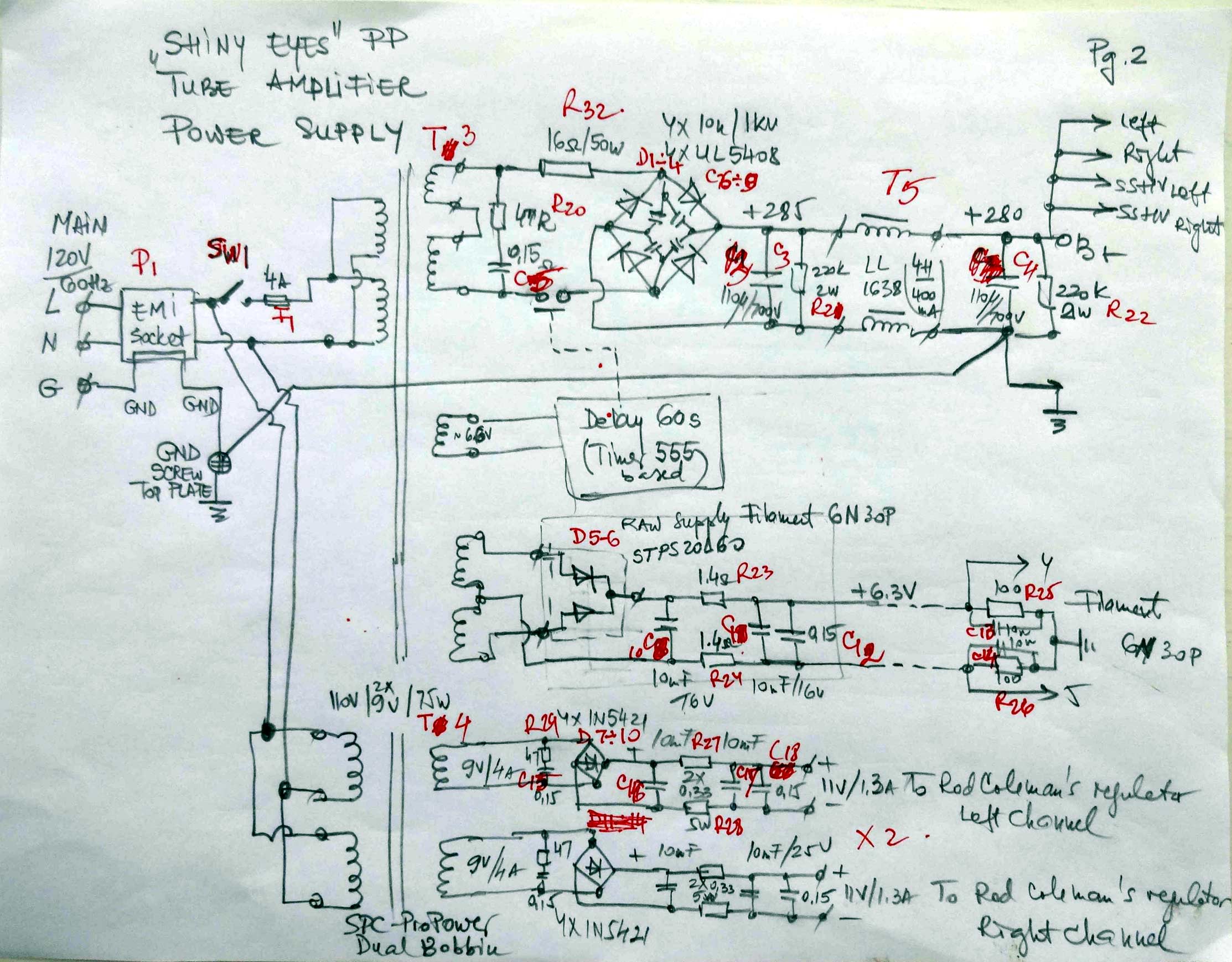

HI Pano,
Here are the schematics. Nothing unusual. Also, top plate is anodized aluminum 3mm gold CNCed by ProtoPanel.com. Cabinet is mahogany all sides and birch ply 1/2" bottom with more than 300 holes for heat management. More info at simplepleasuretubeamp.com. Thank you for your words of appreciation.
I guess I could if you imply using them in UL connection class AB. Actualy when I bought the OTs I was thinking of building a classic pushpull with 6P3s and I tried it but in the end I liked better the sound of triode strapped 4P1L. I guess it is just a matter of taste. I know that there is a lot of power wasted this way, but I couldnt help it. This is my first amp, and I aimed for simple, 2 stages, transparent sound.
