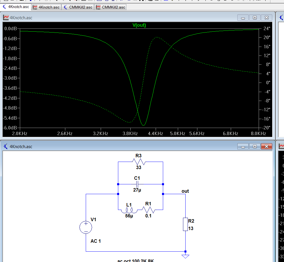

I have SONIDO SFR175 fullrange speaker, 8ohm very nice unit. But in my environment I need to build a notch filter for it. Could you please help me with starting values for this filter?
The speaker in 4khz range is 7,6 ohm impedance. I need to make a 6dB deep in 4khz, lets say in slope range between 3700-4300
Thank You in advance

Oh, I've measured impedance. And to my surprise it is 13 ohm not 7,6 as nominal.
Could you please update the values? Thank you for your help in advance
