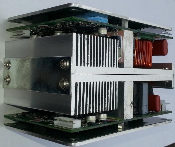

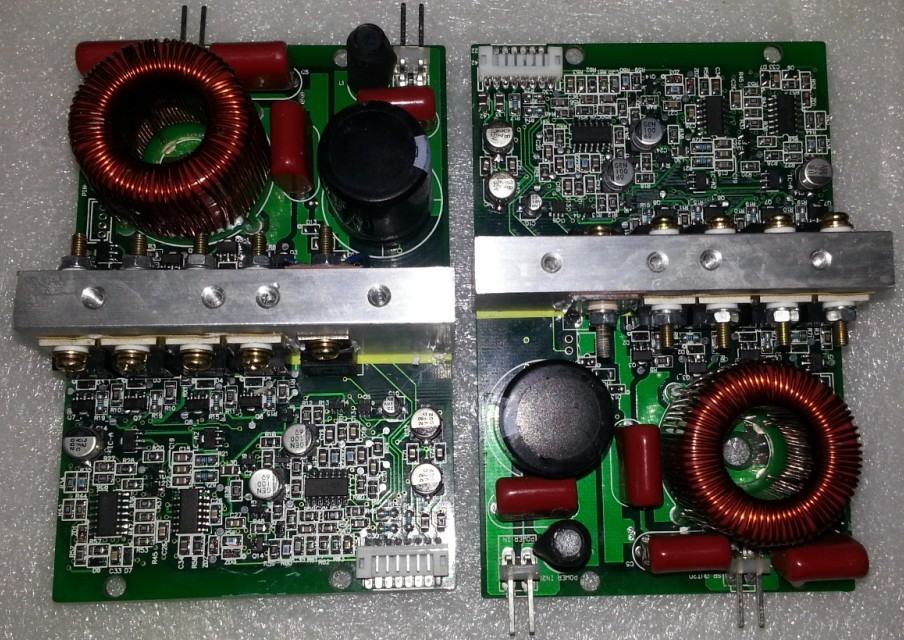

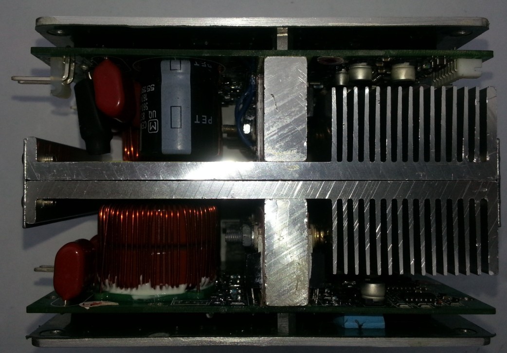

the original ICEPOWER1000A power is low, which is only 500w/8ohms.
I changed the circuit a little, added output transistors, and increase the voltage to 150V, so that the power now is 1200w/8ohms, 2400w/4ohms.
check out the pictures.
any comments is appreciated, thanks!

Interesting mod. what is the rail voltage now after the mod? and what was the before and after output transistors ?
I'm sure increasing the supply voltage wont cause side effects what is the before and after supply rails ?
the voltage was 120V, and now is 150V.
the output transistor was FDB2532, and now is IRFB4427.
the drive was IR2010, and now is IR2110.
hehe...when available will try to modify the circuit board and use T0247 Encapsulation IRFP4232 IXFK102N30P, 2000w/8ohms, and see whether the module can reach to 2000w/8ohms

What is the operating frequency of this circuit?
have you tested the amp at maximum output or near maximum output? drawing more than 1kw of power from any type of design is a mean feat, and not many are capable of doing so.
it's one thing to make the circuit stable at high rail voltage, but that doesn't necessarily mean that it'll be able to sustain high power output and still be stable while doing so.
Your future attempt to increase the power supply further will render the device into flames, i don't think the original design will permit this, i do think its a bit over ambitious.

we use the power supply simlilar to the Labgruppen FP series, just change double power supply to single power supply.
I plan to make it to a commercial product, now it's just a demo.
pink noise input, it's very stable at output power 2400w/4ohms . it's just I want to make it a 4 channel amp, so I need to improve the power supply when all 4 channels working at its maximum output power.
Hypex modules don't allow this form of modifications for a reason im looking at a datasheet for its Ncore modules and see its got UV, OV and OC protection schemes incorporated into the modules.
Thanks for your information, but we're doing ok right now.
